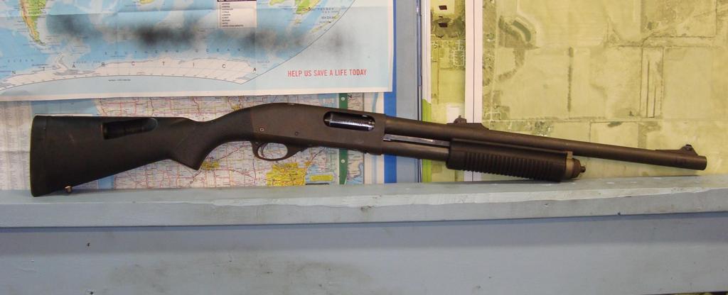

As received
It started out like this:

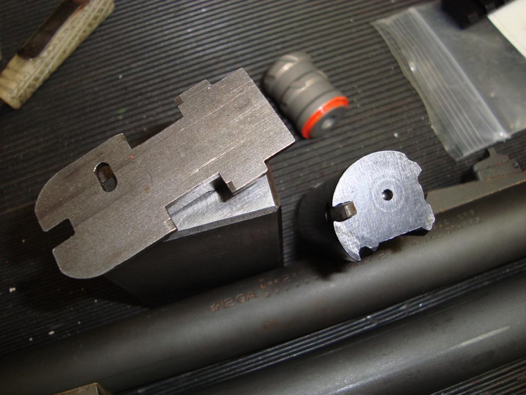

This is the boltface as reveived. I don't think it'd had 50 rounds through it. Test fired only maybe.....?

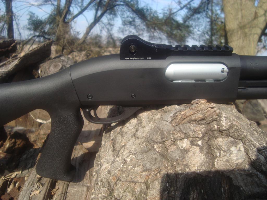

The Vang sight and chromed bolt. The stock is going to be changed although this pistol-gripped Speed Feed unit is not bad at all. It's just that it and the fore-end had a few minor dings from the cruiser rack.

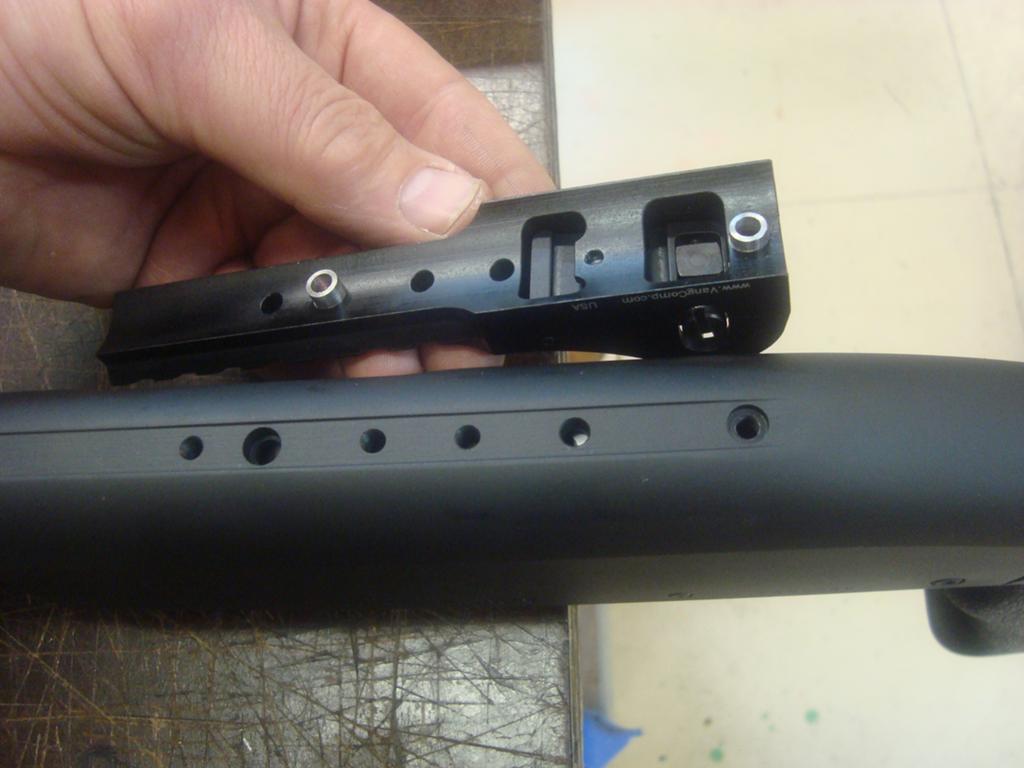

And.... that sight is not just screwed on. It is truly knock-proofed by two tubular dowels.... so even with the EoTech on there and heavy-recoiling loads, nothing is going anywhwere.

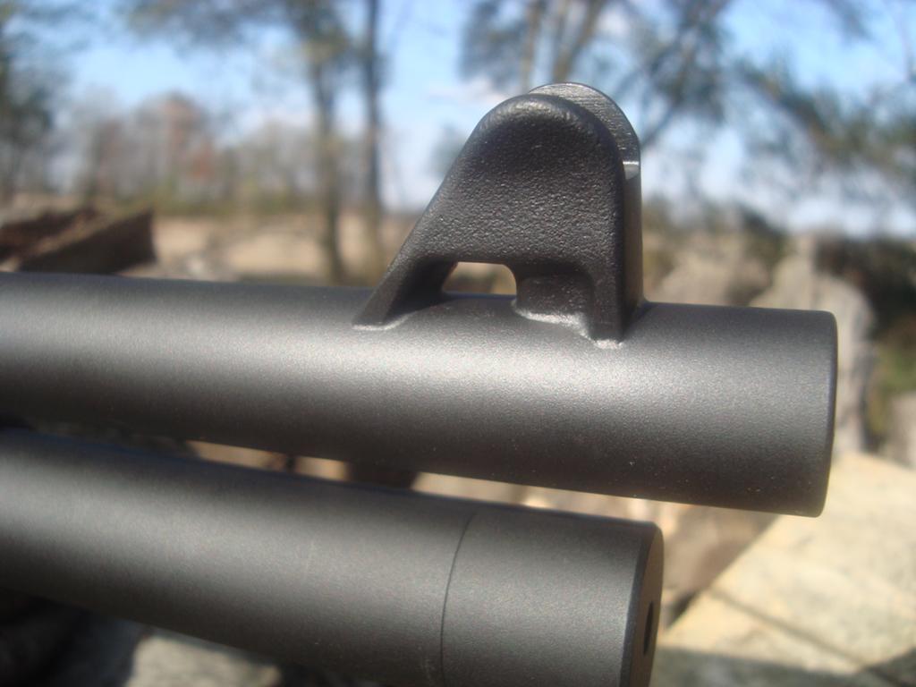

The barrel was shortened a bit and the old front sight has been replaced with my trademark shotgun front sight, an AR15 front sight tower cut and radiused, and silver-brazed in place. Gives the user a lot of flexibility in elevation adjustment and in terms of what kind of front sight post is used:
If "silver brazed on" doesn't sound strong, bear in mind that that is how the old front and rear sights were attached, and the underlug that attaches the barrel to the receiver via the mag tube threads is also silver brazed on.

Very interesting front sight. Does this use a screw in AR-15 type front post?

Yes. And I just received, from XS Sight Systems, their Big Dot night sight to put in there..... perfect for a shotgun.

Now here's a front sight that is perfect for a shotgun such as this-- thanks again to XS sights for the contribution.
