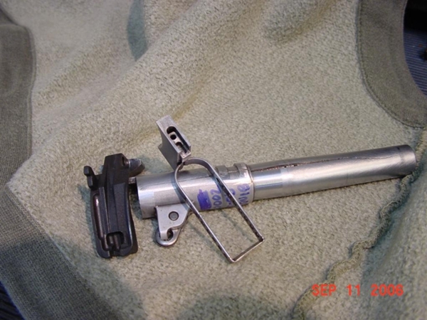

Got this one back the other day, with a well-documented 12K rounds through it. Not that that is so, so many but I don't often get to study a gun with an accurate round count on it, so it's pretty valuable info, a place from which to see what holds up and what works after a known amount of wear. It also helps me learn to be able to examine a gun and estimate its round count. I usually go right for the breech face for this and can call it pretty close but some guns are real foolers.

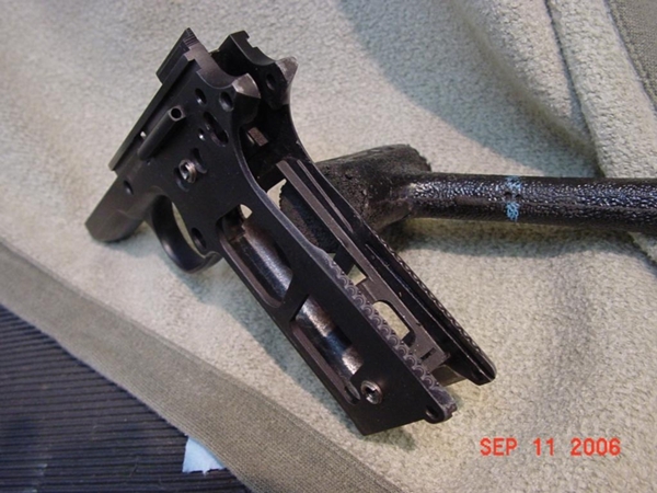

This project had a couple of themes-- as much stainless as possible, and as lightweight as possible, within budgetary reason, without using an aluminum frame. The first two pics show some of the lightening measures on the frame-- and extra window under the grip panels, low; holes under the grips just over the trigger track, and a window in the mag chute's rear wall just over the sear spring retaining slot:
Imagelightening rr
Also, a hole under the barrel bed and feedramp, from the front, and a cut that actually hollows out the root of the front of the trigger guard, where it "grows" down from the dust cover:
Image lightening top
Lightening of the trigger is more of a standard measure for reducing its weight for trigger-bounce reasons. You can see also here the solid trigger stop I've fabbed. The grip safety has been whittled out on the inside, and.... whoa, what happened to that barrel!? That's why she came back-- a squib, a tap-rack-bang, or in this case, a tap-rack-kaBOOm.

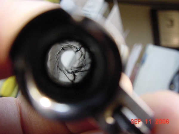

Barrel from the inside:
Image barrel inside

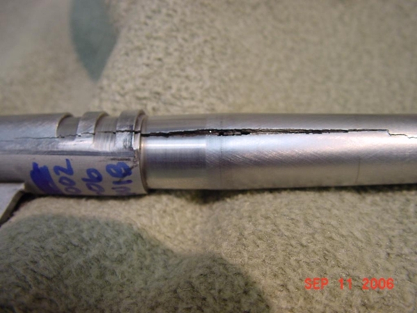

Side view. Three major longitudinal cracks. A few more tried to start but it was over before they got too far. The case did not rupture and there was no damage to the mag or grips. Oh, yeah, and one of my favorite customers is OK too!

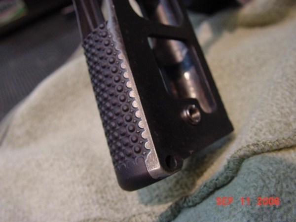

Does black anodizing hold up well? This MSH is one I made from scratch from 7075 aluminum and had BA'd. All stainless parts were chrome sulphided by a place in CA that I thought had a lot of promise as a new finishing source for me. They also chromed the barrel and hammer and did a great job of it. The frame came back a little mottled-- which was not such a big deal but I wrote to ask it there was something I might have done or might do next time to prevent it. They were sorely offended and dissed me pretty bad so-- off the list they went. Anyway, as you can see here the finish on the stainless has taken something of a beating, not to say it is not good. This gun, besides the 12K rounds, has seen a lot of daily carry and several classes and competitions. It has been well used but well maintained, definitely not babied. But the black anodizing, hard as all get out, has held up well. Now, I did give the entire lower end a thin coat of black spray and bake to even out the aforementioned mottled apprearance.... this did not go onto the MSH however. This coat of paint is not stuck to the gun as well as it sticks to fresh Parkerizing but it has done its job in sorta "homogenizing" the color.

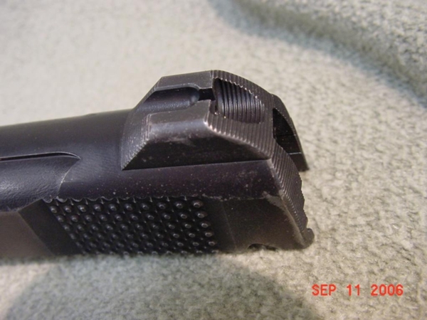

Finish on the left rear of the slide takes a beating from wear and sweat,when carried IWB. The serrated front of the rear sight was used against a barricade to help initial efforts to get the gun apart after the incident. I think somewhere on the LTW there are pics of this when it was new
Imagerr sight

Aside from your usual stupendous work, I think I'm most impressed at how that anodizing held up. That's good stuff.
I like the lightening hole under the barrel bed and feedramp. I can imagine hearing "experts" stating how that would cause frame cracks, global warming, and so on. Obviously, it hurts nothing.

With all of the machine work on the frame and slide, how much weight was removed?
Thanks
PostPosted: Tue Sep 12, 2006 9:49 am
Posts: 4415
Nothing from the slide-- maybe a couple OZ's from the frame if we were lucky. I never really checked it.

Ned, what type of barrel is that? I lloks like it held up pretty good under the circumstances. Was there any other damage to the gun. I am assuming the mag and the mag release are toast.

The barrel was a Wilson (and so's the new one). Far as I know even the mag was undamaged-- the case never blew. The mag catch is fine. Shot the gun maybe 30X today and it's good to go except the sight-in is lost with the new barrel. I have to make a new bushing anyway since the old one got ChannelLoc'd getting the gun apart, so I will offset its bore to bring the sight-in back in (it's only a few inches off at 28 yards).

Great thread. I love the look of worn custom pieces. There is something wonderful about the looks of a purpose-made pistol that has been taken out and used hard.
But, there is something here I just don't get.
How do that work?
I know Ned is a master of metal blending, but it looks like there are scallops where straight lines should be. How does the MS slide in?

It does not slide in. It must be precision teleported. Kinda makes field maintenance more difficult but with the molecular seal between the two parts there is less need for it.

It looks to me as though the MSH and frame were machined while assembled, giving it that blended look. The seam between the two parts lies along the row of small shiny high points. The reason it looks so odd is due to the uneven wear of the finish on the frame as opposed to the MSH.

Exactly right, Rick. The pattern is put on while the MSH is in the frame.
