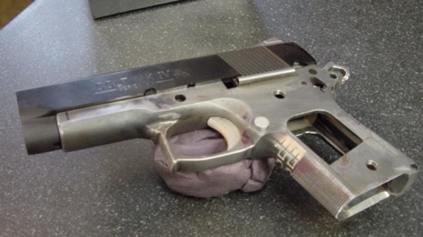

But…. I still totally love the look of a squared TG. Jason does them so very well and I enjoy those pics. It had been a while since I’d done one, so I was not about to decline doing it for this guy. But first a couple of my early attempts:
This one is from 1981 and is a re-do; I originally did it right after I bought this gun in, I believe, 1976. I had read a “how to” article by George C. Nonte, and tried my hand at it in Dad’s basement shop. It turned out fine but as I matured as a toolmaker I went through a phase of doing everything by EDM. I also had more access to things like good TIG welding. Where the original version had been silver-brazed in place, this one is TIG’d on and the gripping pattern is EDM’d on.
This one’s from a few years later, 1983, and I never really completed this project:
And the current one. The bottom horizontal still has about a three-thousandth “belly” in it—just enough to see—that has since been stoned out. Mid-FRAG on the front

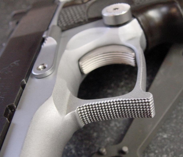

I took a look at my one 1911 with a squared trigger guard. It's a Combat Commander that Armand Swenson built for me. I asked for the squared trigger guard because . . . well, it was the cool thing to do back then. But with my smallish hands and short fingers, it turned out that my grip wasn't really improved when I tried to reach the squared front. Still cool, though.
And as well built as it was/is, the detail/finishing execution is not up to what you guys are doing nowadays. Seems the wait was about as long though :lol:
P.S. Dug out the invoice. That squared (& checkered) trigger guard cost me an extra $45!! But then, it was a few years ago.

This is the gun from the “High Mileage Comes To Town” thread that I am rejuvenating to the degree possible (lacking an actual time machine), first worked on by me in 1994 I believe. It is not set up the way I would do a gun these days, even at that time I’d have done it differently, but— there is no arguing with a guy who shoots this well. Of the “hooked” TG’s I have done, probably countable on one hand, at least two were for Jeff. Can’t see it but this one has some texture on the finger surface. This gun has at the very, very least, 150,000 rounds through it. The true number, we are sure, is considerably higher but, possibly, would not sound credible.
My faithful old pin gun, this one was forged out; the large radius in the corner gives it away somewhat. You can stretch it further but depending on how much metal there is to work with, it might thin things out too much.

I was first drawn to it by the aesthetics of it from Swenson's work then by the benefits. I started doing them around 2000, for the benefit of more room for the trigger finger and to give more area for the support hand. I tried the heat and stretch method with little success and then went to the cut and replace method tig welding it. I like to move the front forward to meet the radius from the dust cover and lower the bottom to create more of an under cut. It has more or less became a signature mod for my guns. I keep the cut offs in a box, I bet there is probably a hundred plus in there by now.
Rich
