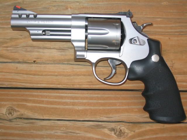

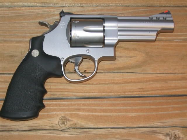

Unfortunately, Jack is no longer doing custom revolver work, but he made my day several years ago with this 629-5:
* Hybra Port â„¢ Porting (â„¢ Weigand Combat)
* Complete Action Job
* Turn Barrel and Crown
* Chamfer Cylinder
* Polish Trigger and Add Stop
* Soften Hammer Checkering
* Dehorn for Carry
* Eliminate Cylinder Endshake
* Replace all Springs
* Polish Screw Heads and Pins
* Bead Blast

Can you tell me your opinion on the porting, please.
How much recoil does it reduce?
Or does it just reduce muzzle rise?
How bad is the flash at night? Can you find your front sight for follow up shots?
Loss in velocity?

As to the recoil question, it really only helps with PERCEIVED recoil, mainly due to the significant reduction in muzzle flip. It practically recoils DOWN, but the gun still slams back pretty hard. I haven't tried to measure the velocity loss, but someday....
Muzzle flash is mostly a factor of the ammo you choose. I settled on Silvertips due to the very small fireball they generate. YMFMV

Thanks. They are all beautiful!
