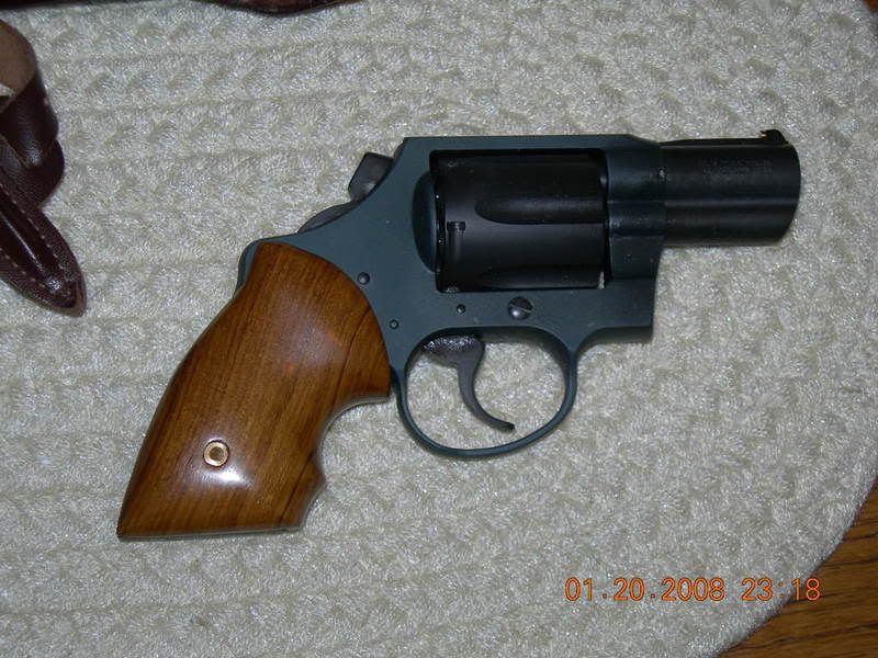

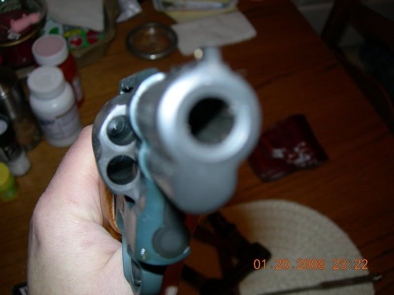

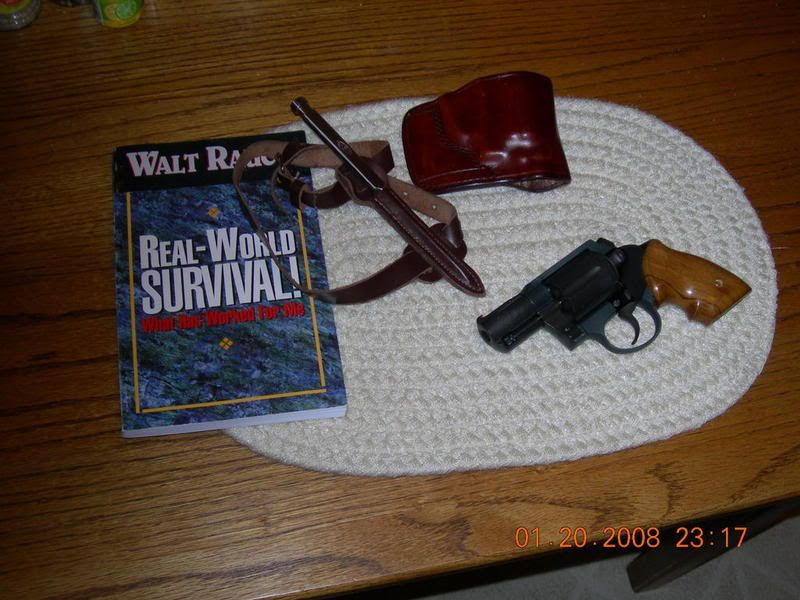

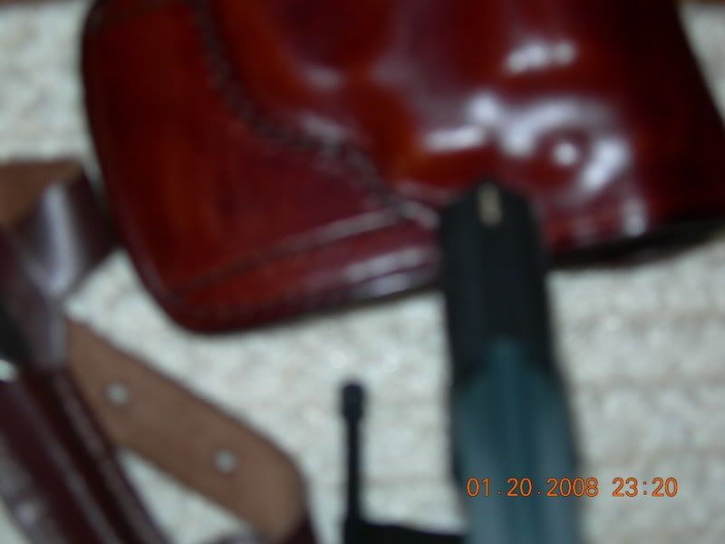

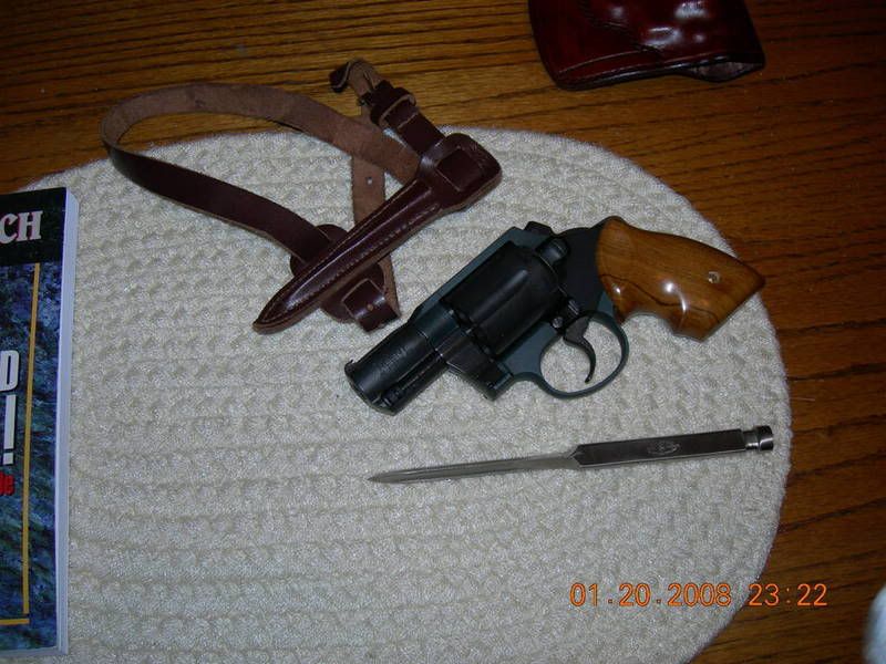

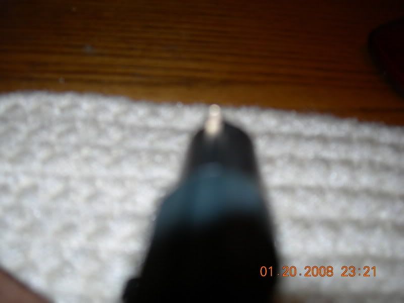

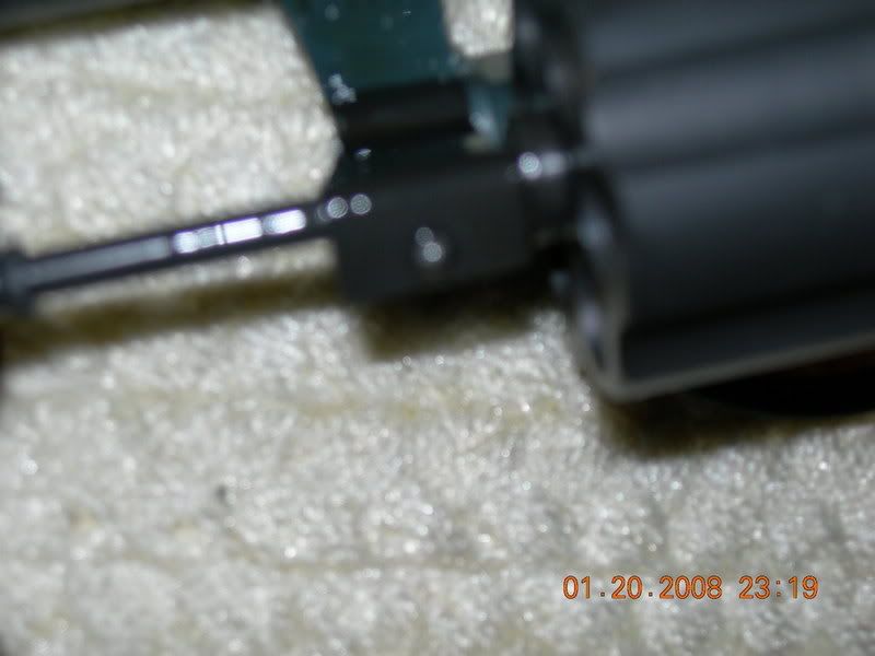

Hi everybody. I am finally getting around to posting this little beauty that Dave Sams did for me. She came home on December 23rd as a great Christmas present to myself. Unfortunately, over the holidays I have been in and out of the hospital 3 times with 3 more surgeries to slow me down a bit. 'Nuff said about that :roll:
Several months ago our member Lindermant posted some pictures on here of his Agent that was also done by Dave. I immediately fell in love with it and decided it was time for me to get one for myself, so I purchased a 70's model Agent that was well used and had a lot of finish wear. (Unfortunately forgot to take before pictures)! As they say "Imitation is the most sincere form of flattery", so thank you Tom for the inspiration for this.
Some of the things I had Dave do to her are as follows: EXCELLENT trigger job--SCARY!, install ball detent for tighter lock-up of cylinder, correct cylinder end-shake and timing, install recoil shield, crown muzzle (I think it was 13 degree crown), open rear sight channel slightly and install gold bead front sight (Dave makes his own gold beads), bob the hammer and excellent action job, and finally perform a "Half-Fitz" cutout on the right side of the triggerguard (slightly quicker access to the trigger). The grips I put on are Eagle Secret Service grips in Balsa Wood (these are very slick..I need to rough them up a bit or replace).
This has become my primary carry gun since getting it back. Since I am no longer in Law Enforcement I don't feel the need to carry a large cannon all the time. This little beauty is completely snag-free and carries 6 rounds of .38 +P ammo with several speed strips to fill her belly if needed. It is amazing how well this pistol disappears on my body or in a coat pocket!
I have only fired a few rounds to try her out, but MAN IS SHE ACCURATE!! With the trigger and action jobs by Dave, plus the natural accuracy that Colt was famous for (those were the days!!) I can handle anything coming my way within 25 Yards I know!! I will wring her out a little better when the weather warms and my wounds heal! Enjoy! (sorry about the cruddy pictures...best I can do right now!!)--John

Thanks guys for the compliments! Especially you Tom, since you were the inspiration for this little project! :D That isn't a pocket holster, just a small belt slide from Don Hume that I had laying around. It is actually for my S&W 442 (which was my primary carry piece before this one arrived, poor gal has lost her home and her loving Daddy :cry: to this Colt!!). The holster also fits the Colt very well until I can get Alex, Lou, John or one of the other excellent Leather Artisans on here to build me a holster for her. I apologise for the crappy pictures everybody...like our good friend Terry says, "I ain't no picture taker!!" The dark parkerizing was playing hell with the autofocus on my little camera and my lighting wasn't very good to start with...I may try to shoot some more pics and edit the post later.--John

Beautiful gun! I didn't realize Dave Sams was working on Colt wheelies. I have an Agent just like this (grips and all!) that could use some trigger work and a bobbed hammer. How is speed loader clearance with your grips? I had to trim mine down to get proper clearance and I was disappointed by that.

Random....thanks for your comments! Dave does quite a bit of work on wheelguns, but they just aren't his "trademark" like the Berettas he is famous for and 1911's and Hi-powers. He was a pleasure to deal with, pretty quick on the turnaround time, and prices were very acceptable. His action work on revolvers is impressive and with the added ball-detent, the lockup on this agent is probably tighter than Mark W's vault :lol: . The speedloaders will work, but it is a tight fit...if I decide to keep these stocks on her they will need a little "fitting", but overall I am not too happy with their fit or feel...VERY slick and almost impossible to get a good grip on. I am considering trying to checker them or add some sort of traction/sandy type epoxy to them, or may just put the original Colt grips back on her.
Tom, as far as the Fitz treatment on the triggerguard. I have always been a student of Rex Applegate, WE Fairbairn, and Eric Sykes and feel that a lot of what they taught and lived still hold a lot of merit. These guys understood combat on a level that not many others have known and I always was fascinated by the big-bore snubbies that they and others like Col. Askins carried (while in the pacific during WWII Col. Askins carried 2 Fitz special New Services! :shock: ). I liked the idea of the Fitz type triggerguard to help in accessing the trigger a split second quicker, but could not justify the liability of a completely cut-away triggerguard like the originals (we all know how you sneaky attorneys can be...AHEM), and I remembered an article in one of the gun rags a few years ago about Andy Horvath doing modern recreations of the Fitz guns but with the partial cutout of the guard, so that is the route I took since this gun will be (and is) carried a lot. This whole package is simply incredible to slip in a coat pocket, on the belt or anywhere else I can think of, and with a couple of extra speed-strips gives me a nice and unnoticeable insurance policy that virtually disappears!--John

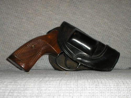

howdy , heres two pics of my favorite DS with hammer shroud and my Favorite vintage holster , a Lewis Police Special , Jack Webb had a tan one when he played Joe Friday.
