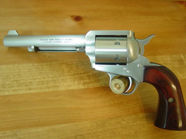

I have an FA 83 in .454 Casull with the 7.5-inch barrel and two FA 97s, a fixed-sight 5.5-inch .357 Magnum and a 5.5-inch octagonal-barreled one in .22 LR. I have owned a custom Ruger, a Predator from Mag-na-Port in .44 Magnum. I also once owned a 4-3/4" FA 83 in .44 Magnum and a Field Grade 454 (before they were called 83s) with a 7.5-inch barrel.
Unless you are loading heavy for caliber, the FA 83 .454 cylinder is long enough for just about any use. I have gone as large as 300-grain although I now mostly load 260-grain as I just do not need the penetration the 300-grain pills provide. The FA 97 .357 will allow me to get 180-grain bullets to fit, but it is tight. Handloading is a must for the 180-grain pills. I mostly run 158-grain SWCs at 1100 fps in it, and it excels with those. I had to learn where to place the front sight to get elevation dead on target. The one thing I really wish is that the fixed front sight sat in a dovetail, so it could be blackened carbon steel with a gold bead. That will happen someday.
As far as workmanship and materials, I cannot see how any Ruger can be better than the FA. The FA uses 17-4PH steel and the workmanship is evident. At best, the custom smiths can equal what FA does.
My most-used FA is my FA 97 in .357 Magnum. It gets carried during farm chores in a Sparks cross-draw holster, so it sees some use. I last wore it on Saturday while working on the pasture fences. It has more than a few scratches, but it is insanely accurate.
