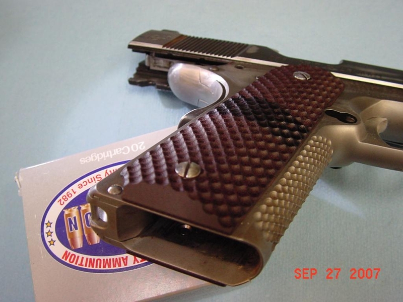

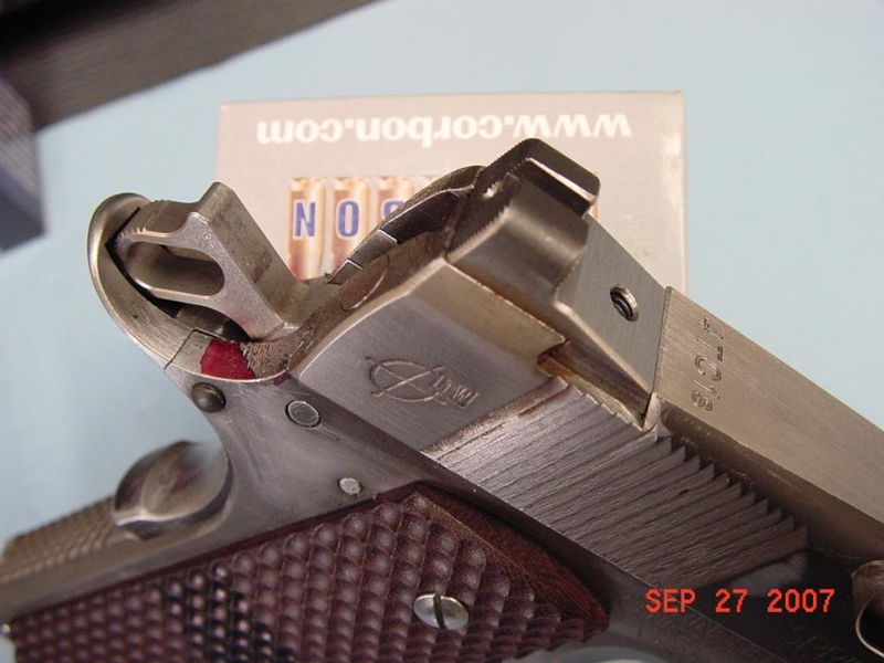

OK! Have a couple pics for y'all. As I've mentioned I'm always hesitant about showing "in progress" pics but I know this project seems to be taking a long time, so here are a few. Another day's work or so and it goes out to Metaloy for the first part of the finish.
YoBo sights with Shield Driver mod, LTW logo and "4TC1s" engraving on top in front of rear sight.
Stan's magwell, Chuck's frontstrap and lanyard point, VZ grips with black band.

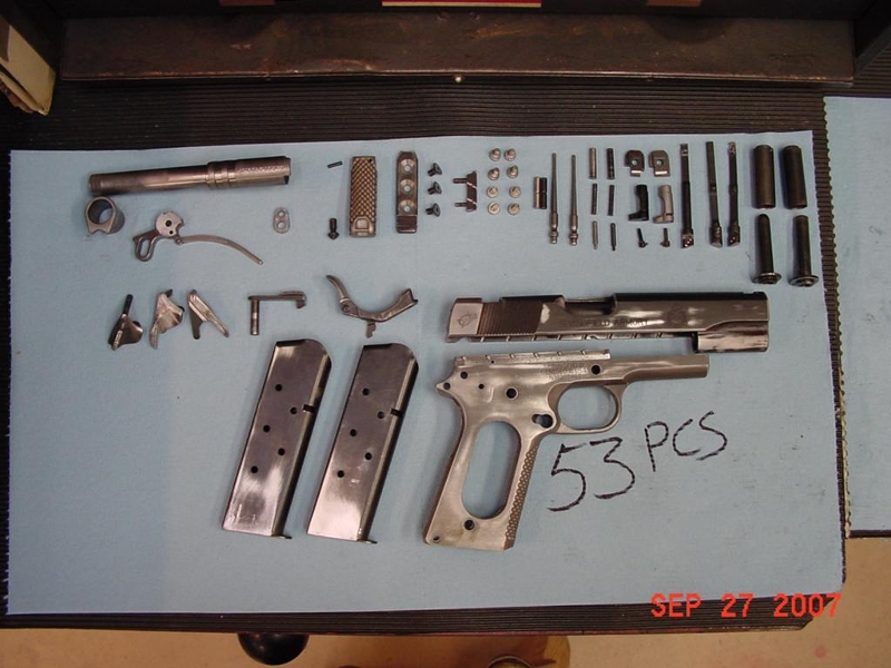

As an aid to inventorying parts on a project like this, I'll lay them all out and take a snap. This goes to the finisher along with a list of parts, so they can confirm as they unpack it that they have all the parts, and then as they repack to ship it back, that they are returning everything I sent.
As mentioned earlier in the thread, because of the "Gonna be used in the war zone where parts availability and support may not be the best" theme, plenty of spares are provided. Especially parts that are easy to lose in poor light, or subject to rolling away when maintenance is done in less than ideal conditions, or parts that, ah, sometimes go into orbit such as recoil spring plugs.
Also, a short and medium trigger are fitted, and both and ambi and single-sided safety are provided since we don't know the preferences of whoever the lucky winner is. Plus one standard and one slightly extended (with miniature golfballing to match front and backstraps) mag catch.
PostPosted: Fri Sep 28, 2007 7:33 am
Location: Omaha, NE
Very nice Ned, Chuck, Don, and Stan. Even naked, this one is a head-turner. I am anxiously awaiting the finished product!

PostPosted: Fri Sep 28, 2007 7:41 am
Joined: Wed Sep 05, 2007 7:42 pm
That is one complete set-up... and I agree with the above poster, even naked the gun looks great! Keep up the good work guys.
