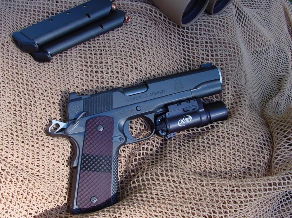

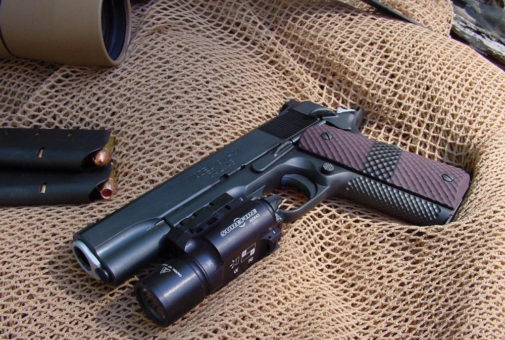

Get ready folks. Might want to get a fan blowing on your modem, I made these as large as I could…..

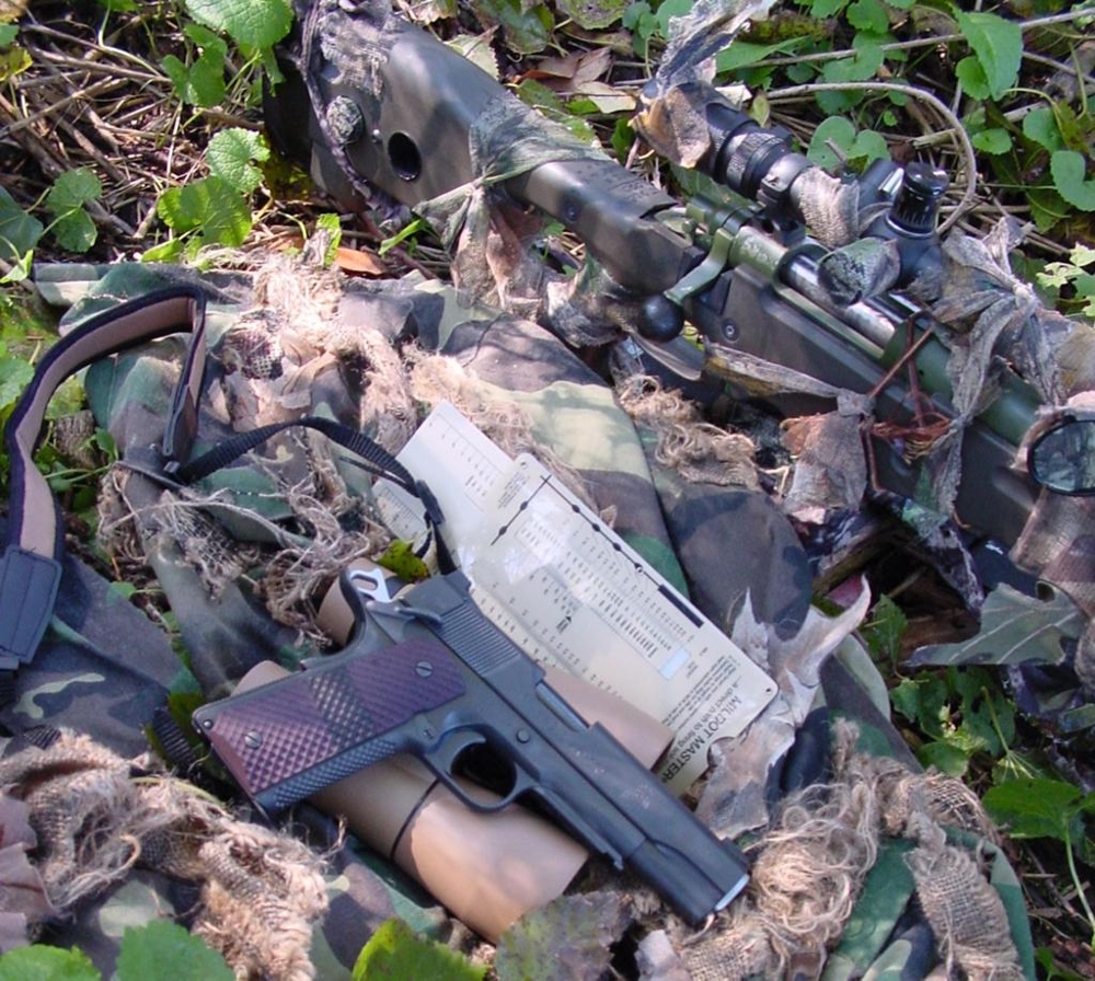

4TC1s, at the job site. Notice the Chris Reeve knife that is part of the package (binocs too, “rifle not included” :lol: ).

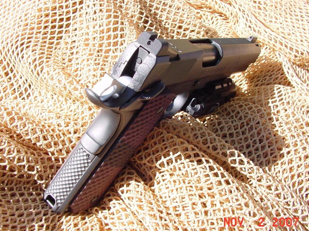

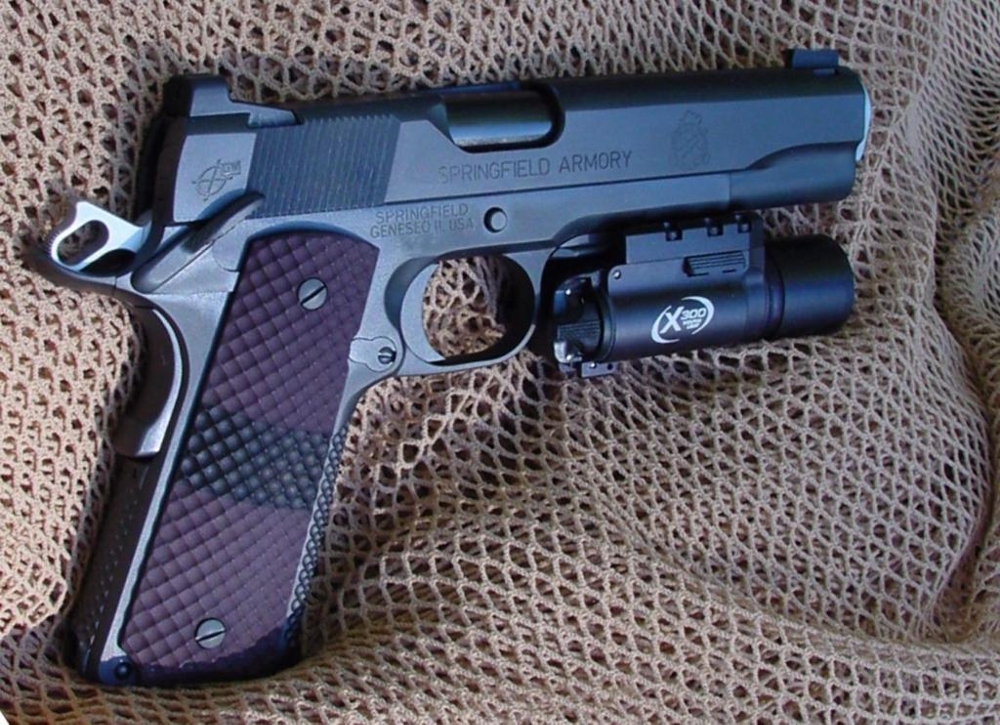

Couple of right side views. Don Williams’ expertly fitted hammer was left in chrome, while the triggers he fitted were given Tungsten DLC. Yup, it even goes onto a part that is half stainless steel, half aluminum. Both triggers (short and medium) have overtravel stops that will never, ever come loose. Don’s action job is superb; purposely not feather light, but a perfect duty-grade 4.5 pounds… crisp and positive. Nice work, Don.
Showing the Leupold 10X50 Tactical binocs, Surefire X300, yes the new X300, two spare Tripp mags, three total, which have also been treated with Tunsgsten DLC along with the pistol and all of the numerous spare parts. Notice the CorBon DPX in one of the mags.... they sent a bunch of different loads for test firing. 4TC1s likes them all-- this gun flat out works. Black Hills is also providing ammo that goes along with the package to the lucky winner.
Left side…. the Golfballs are truly a happenin’ treatment for a gun like this. Nice job, Brother Chuck.

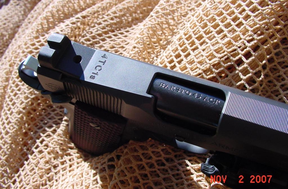

Top, showing the Yost Professional Grade sights installed “Shield Driver” fashion for maximum purchase in a one-handed racking maneuver. Stainless BarSto barrel treated with Tunsgsten DLC….. what a beautiful finish. All non-stainless parts were Metaloyed first. Thanks a ton, Metaloy and Ion Bond.

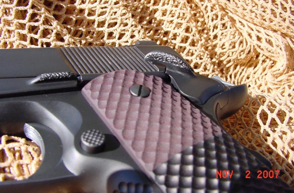

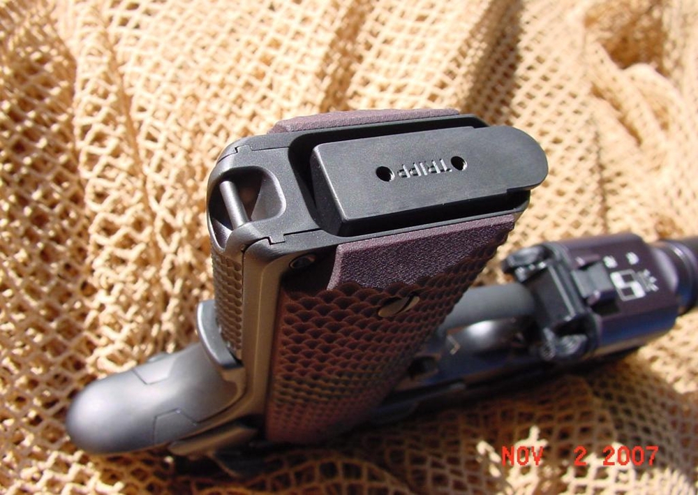

Rear view, more Golfballs on the mainspring housing, and Chuck’s lanyard point. Gemtec is on board now for a lanyard BTW. Sights have tritium lamps (courtesy of Trijicon) recessed forward so only the shooter can see them.

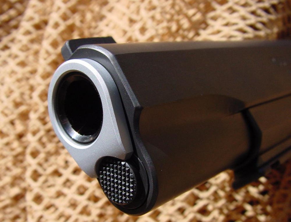

The business end….. beautifully recessed crown, the polish of which really glows black with that DLC finish. Stan’s fitting of the barrel and bushing is duty-oriented, so, not binding tight…. but to look at the groups he shot with this pistol you would guess it was. Recoil spring plug has three hidden drain holes.
Nowlin extended mag release has mini-Golfballs by Chuck to match the rest of the gun. Safety and slide stop are serrated on underside. Gun comes with spares for all three (one ambi and on not-ambi safety provided). Grips by VZ Grips, custom made to match the Golfballs.

Hidden drain holes in the recoil spring plug? That be detailed.

Couple of tech details for y'all.
The Dawson rail is installed with three, 8-36 screws.
With two safeties, and two sets of safety detent plungers and springs, there were four different combos possible, so there was a little extra effort in setting the safety on and off efforts, to make sure there was a crisp and positive action regardless of the combination of parts.
Although the overall finish is not shiny but satin or matte, Ion Bond was kind enough and careful enough to preserve the high polish on the feed ramp. Nice touch.
The drain holes are kind of a "this is Michigan" idea I had, for cops' duty guns, after concocting a scenario drawing on a combo of actual events that could easily enough happen: You and officer Fido are tracking the suspects through a swampy area along the river. It's 25 degrees Farenhiet. You fall in the river and get soaked along with your pistol which is in a drop-leg Safariland 6004. As you leave the search party and start back to warmth and safety, your pistol, also at 25 degrees, has mostly drained before freezing solid, except the recoil spring plug, which has now become a solid object with a recoil spring sticking outthe back of it. You could fire one shot, but the gun would short cycle. Yeah, silly probably. Hmmm... I sense a test coming this winter.

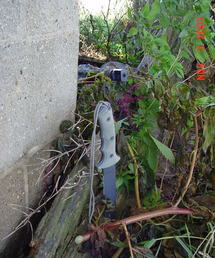

Oops, here's the missing knife, I seem to have cropped it out in the first pic. Perfect tool for a little weed whacking.

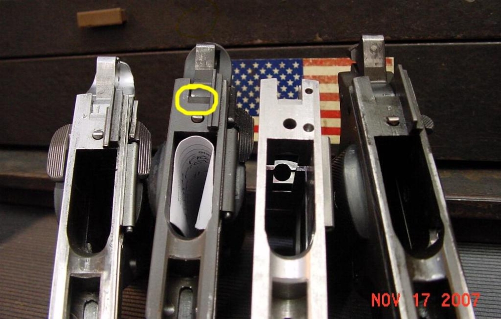

What's this cut for?
First two correct answers get a raffle ticket each, Email me the answers at metalmaster@m-guns.com . Respondents may not be gunsmiths! Answer is subject to, ah, what I have always thought it is for, butif somebody has a better theory I'm good with that. Some more recent brands don't have it but it's there on the print.... left to right:
'70's LW Colt Commander,actually an early Bill Wilson gun;
A Springfield Armory 5"
A very recent '70-Series Colt
A 1914-made Colt 1911(no "A1").
....they all have the cut.
So as you can see it's a cut that's been there from the start and is still there-- but some brands don't have it.
Frequenters of this board get a head start but tomorrow I may just post it all over the place.....

OK-- both tickets are won. One winner rolled his over to one of our centurions and I'll say no more since if he should be the one I want it to be a surprise.
Here's the answer I was looking for:
When the hammer is inevitably dropped with the slide off, OK, I know we don't do this but when you're equipping tens of thousands of Doughboys it's gonna happen, so when it happens several times, the peened-up metal from the hardened hammer impacting the frame does not go above the top frame surface and impeded slide movement.
