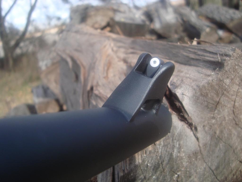

Now here's a front sight that is perfect for a shotgun such as this-- thanks again to XS sights for the contribution.
I should have the stock and fore end next week, at which time I'll get a few more pics up with the EoTech mounted, and get it in the "for sale" area...... first I need to figure out what to ask for it....... then get it...... then send the proceeds to the outfit that's letting us be heard in Washington.
