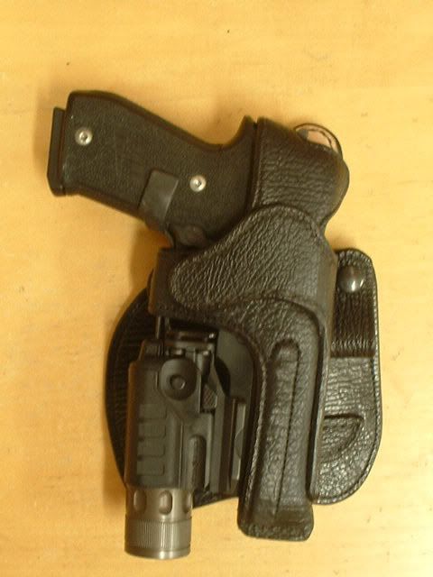

Several of you have e-mailed me in response to this post for pics so I'll post one here. A Sig P220 with Surefire P-series Nitrolon tac-light. The holster is full coverage shark. The vertical "rib" on the side of the holster is a piece of kydex under the shark-skin for reinforcement. The thumb-breaks and paddle are also kydex reinforced.

PostPosted: Sun Jul 10, 2005 4:01 am
Mr Garrity,
That is exceptional! My hats off to you sir.

Still a little tweeking to do with the design but it's getting there. Primarily, the thumb-break (actually middle-finger break) where the strap wraps around the trigger-guard needs to be extended outward a little more for easier access and more positive release. You can barely see it in the photo. Actually this may not be a bad thing from a firearms retention stand-point, but seeing there are two straps to release my "tester" felt it will make the draw smoother and make re-snapping in place easier.
