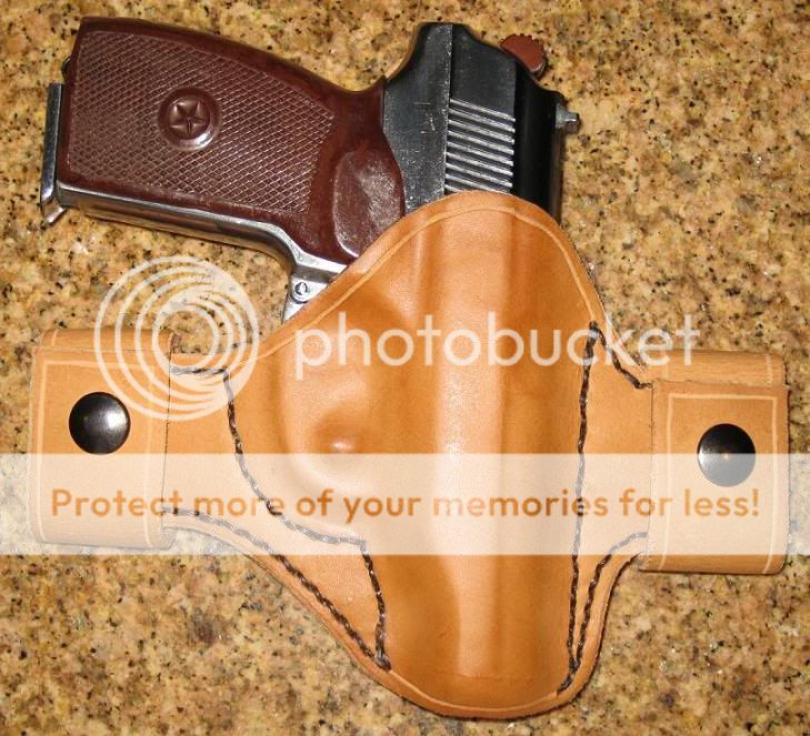

PostPosted: Sat Nov 08, 2008 10:59 am
Joined: Tue Sep 28, 2004 7:19 am
Hello all!
Thanks for all who have helped in my endeavor to try my hand at holster making. Here are my first feable attempts at this (please don't laugh :)). Decided to do this for my Makarov pistol because I have always wanted a holster for this pistol but choices were slim. Finish (antique-esque) is Eco-Flo water based Bison Brown, topped with Satin Sheen. Certain things you all warned about I could not understand until I got my hands dirty and I know my next one will be better. One thing I keep watching out for but could not avoid were indentations on the leather surface... They are not scratches but close; how can I smooth them out? Anyway, thanks for all the advice again, and here is the result:
PostPosted: Sat Nov 08, 2008 10:43 pm
Posts: 435
I think it looks great. I'd love to do one someday. I love the color!

PostPosted: Mon Nov 17, 2008 12:29 pm
Nice Job!
PostPosted: Tue Nov 18, 2008 9:55 am
Thank you John!
PostPosted: Sun Nov 30, 2008 11:06 pm
My latest holster attempts since my first pictured above. Thanks all for your help in making my new hobby possible! Constructive criticism is always welcome! :) The Makarov holster has not been dyed and finished yet... It is in post-stitching form.

PostPosted: Mon Dec 01, 2008 9:13 pm
Posts: 435
Looks great!
God Bless
45Fundi
PostPosted: Tue Dec 02, 2008 8:15 pm
Pklin....looking very good, it appears that you are getting the hang of the basics very well!!
Not trying to hijack your thread, but hasn't that Makarov been "tweaked" a little bit?? I think that they are great little carry guns, but need a little "love" when they first born. Our departed friend "Witherspoon" had a beautiful little Mak that the one and only Don Williams customized for him and Damn what a nice little piece!! I tried to talk Don into doing one for me 3-4 years ago and he (politely) declined. I certainly like the 9mm Mak round much more than a .380, especially since some of the better ammo companies are making good expanding rounds for it. I sometimes carry my CZ-82 with 14 rounds of Cor-Bon in it! If this pixtol has been worked over, why not undress her from her holster and post a few pics....I would love to see some custom Maks on here--John
