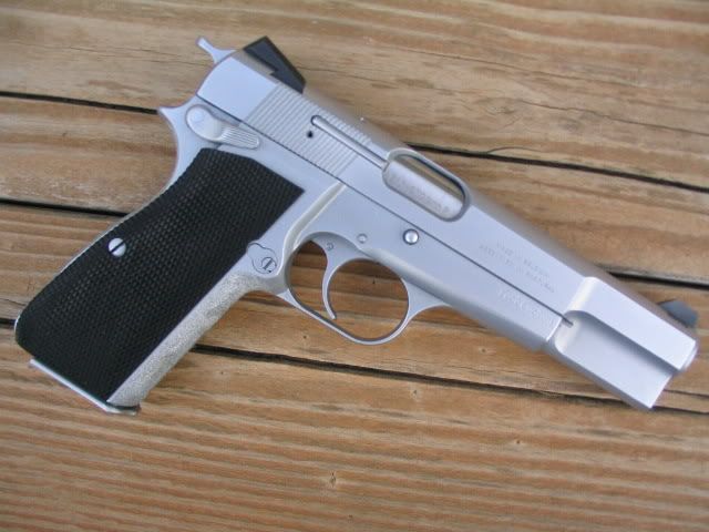

full size Novak Lo Mount rear on BHP

Here's another pic of a Novak .45 rear on a hardchromed BHP, the original SRT prototype built by Master Yost:
