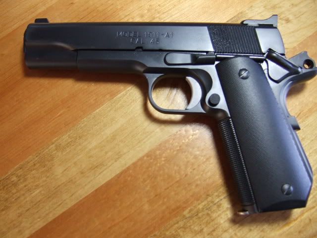

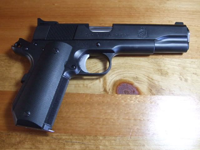

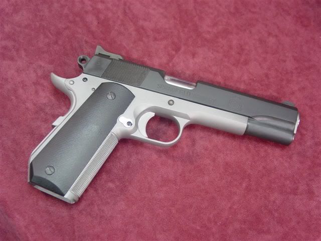

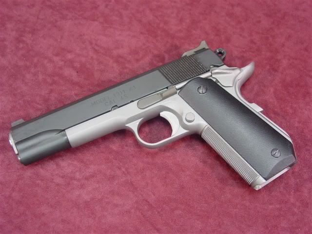

The following are pictures of my just returned Mil-Spec with the EGW E-Treat finish. All of the work, other than finish, is the work of John Harrison. I am the second owner of this pistol, and both owners sent it to John for work. The work, in my case, was ergonomic as the pistol has always functioned perfectly.
The "BEFORE" pictures show the pistol after the smithing was performed but before the EGW finish was applied. In the "BEFORE" pictures, the upper is parkerized while the lower is "in the white".
The EGW finish is matte, but it feels a bit slick to the touch. For that reason, I am very glad I decided to have the front strap checkered at 20 lpi. The grips are VZ.
The EGW finish was NOT applied to the following parts: all of the small pins, trigger, firing pin, magazine release button, spring plug, hammer, and extractor. Those parts are all blued. The EGW finish was applied to the sights as they are plain black sights with no inserts, tritium or otherwise.
BEFORE

Scott
PostPosted: Sun Jun 04, 2006 6:21 pm
Very nice tool there, Scott! Very "stealthy lookin'". I am sure you will enjoy this very much! If I am ever able to obtain my dream Hi-Power...I think I have found the finish it will wear! :shock:
