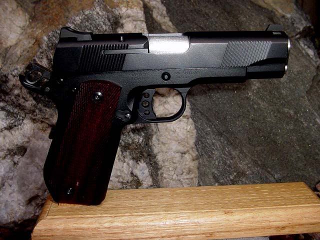

Here is another Scandium bobtail. Barrel crown, snakeskin housing, Heinie Straight 8 Night sights, 4 lb trigger, barrel throat and polish, ramp polish and reliability tuning. The S&W commanders really make a nice carry package. This one is done in all black, including the King's trigger. Finish is Duracoat Combat Black with a satin clear overcoat.
Sorry for the quick pics, but just lazy today.
Enjoy.
Jess

Thanks. I would just think that people might be bored with another bobtail. I do have some stuff coming up that will be quite different. This one is a bit different, they all seem to have something else done to them that makes them unique. I was VERY happy to find the Heinie's fit the standard dovetails so well. It gets rid of the air gap under the stock Novak's that bug the stuff out of me. The first two sets that I got from Brownell's were the wrong rear sight, for a Glock or something. They had to hand pick the sights from stock for me to get the right sets. This is also the first customer pistol that I did in Duracoat. I was using GunKote and was not happy with the results on the Scandium. I am very pleased with the Duracoat for this application. It seems to work very well. Again, thanks but not sure how exciting seeing another bobtail is after I have posted several, but this one has a couple of features that were different.
Jess
