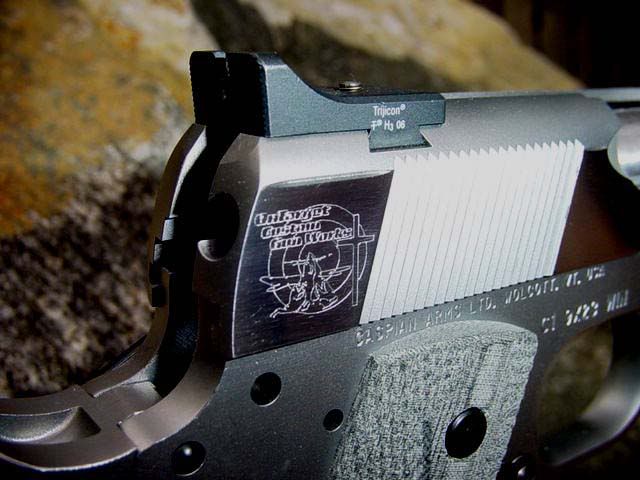

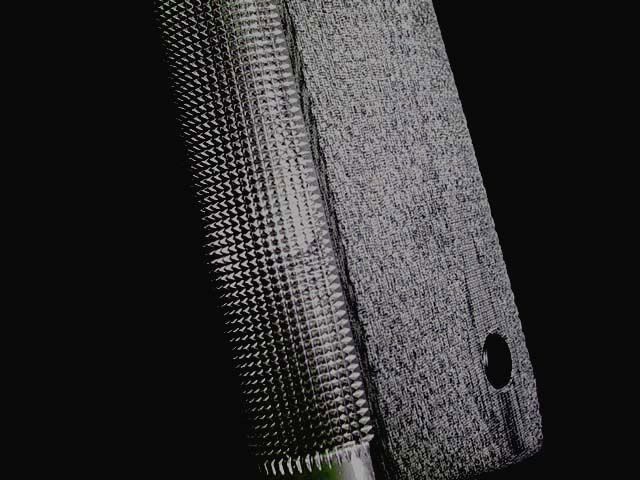

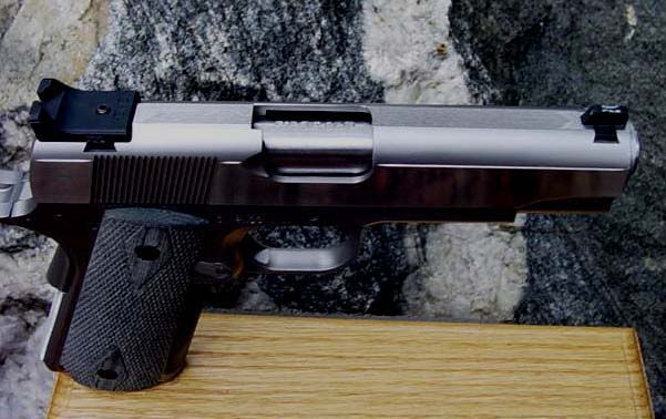

Here are some snaps of a couple of similar 9mm Caspian 5" guns that I recently completed.

I don't know about the gun in the middle pictures, but the first gun that John posted and my gun were built from the ground up using Caspian frames and slides and Kart ramped barrels. The full size Caspian in the top (first) picture belongs to a friend of mine that shoots IDPA. He let me run a magazine through it after the match last Sunday and wow the gun shot really nicely.
