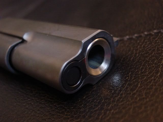

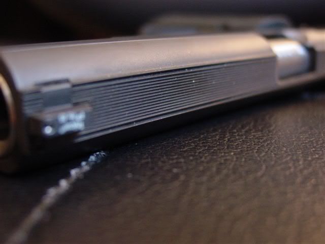

John Harrison's Enhanced S80 solution...
Top Rib:
Muzzle Treatment:

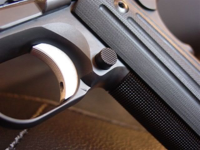

Front Strap/Underneath Trigger Guard:

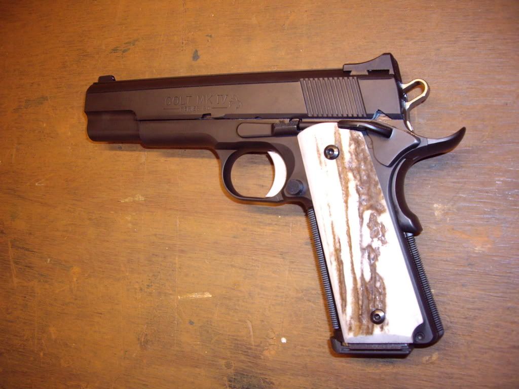

S80 Wearing Stag

PostPosted: Fri Jul 20, 2007 8:04 am
Tommy, Actually the rib is a vestige of the normal round top milling of the slide. I've measured the thickness of these, and found that the slide is equally thick at the muzzle whether it's a conventional round top or with a rib. Many of the "Enhanced" slides have been converted into round top configuration. Hope this helps,
