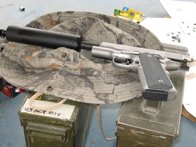

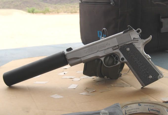

A couple of weeks ago, a buddy of mine that works close to the border was in town for a class at the local school.
He brought with him a brand new Gemtech Blackside suppressor:
http://gem-tech.com/BLACKSIDE.html
and a 45 Glock and a Colt stainless Commander.

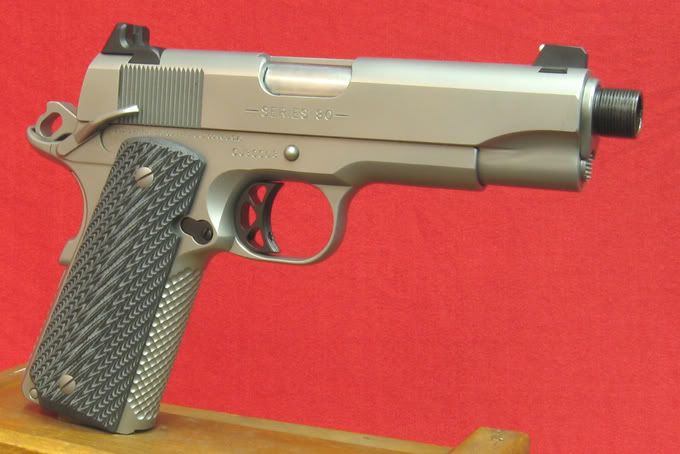

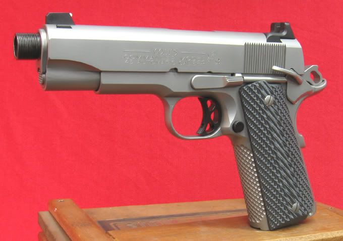

I shortened and threaded a 6" Stormlake barrel for the Glock and worked over his Commander. :)

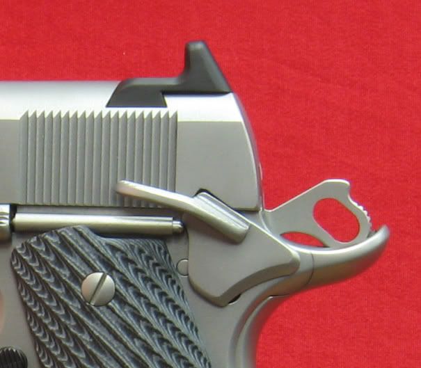

I used a stock Colt 5" barrel as a host for his threaded and extended barrel. The rear sight was honestly carved from a pre-heat treated bar of 4130CM measuring 1" x 1.5" x 12". The 'prominent' sights are necessary for a sight picture over the can.

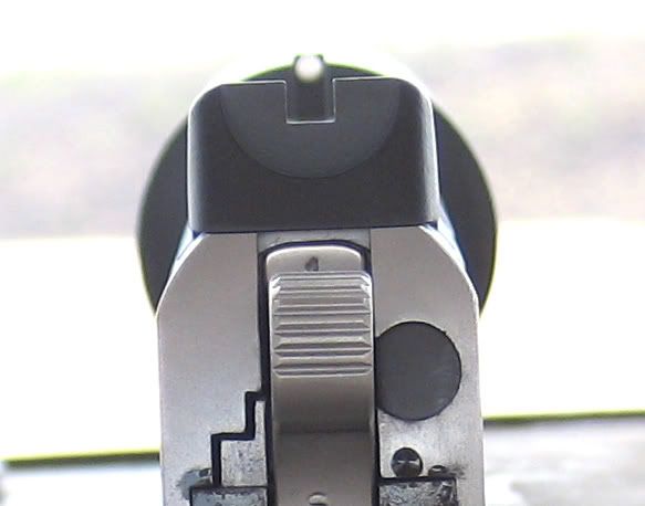

The 'Rogers Whitedot' front sight is a great aid in acquiring the front sight against the black background of the can.

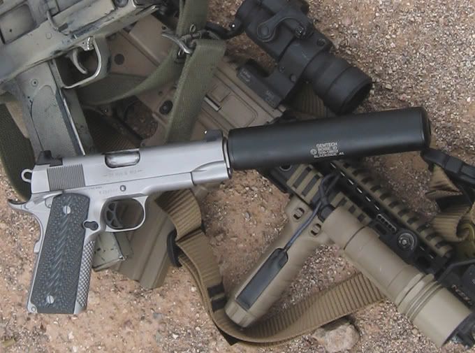

Dry, the can is loud! Saturated with water, it is quite quiet.
This is a fairly poor attempt at showing the sight picture. I built the sights to barely peek over the can so as to not have them impractically tall.
The unit is light enough that the gun functions quite well with the original 18lb. recoil spring. I believe the lighter commander length slide enhances operation with the can attached.

I used a Blackside on a 5" Caspian that I built. The pistol has a threaded Kart barrel. It ran fine with the 16# recoil spring and American Eagle 230 grn ball. My POA/POI didn't change with the can. Did yours?

There was a substantial change in elevation. The gun with suppressor shot approximately 3 3/4" lower at 15 yds.
What sights were you using?

The Caspian has a standard dot tritium XS front sight with a Heine rear. The front sight height was the same as the top edge of the can. I was still able to get a good sight picture by placing the sights over the intended target. I shot from 7-20 yards. I didn't bench the pistol, but I didn't have to adjust my point of aim for body armor drills or steel plates.

Our differing experiences are interesting. I expected the can to shoot low, and it did. The can provides both a compensator like reduction of recoil and a weight/leverage reduction in muzzle flip.
I'd be more likely to think of the stock Colt, un-refitted barrel, as the culprit, but the Glock produced similar results.
I shot from an improvised range bag rest Sunday morning. Weather conditions were not ideal. I was not ideal, having spent the previous evening in the bush and waking at dawn to rain.
My groups at 15 yds were considerably better with can, than without.
This may have been due to less 'flinch' on my part.

Hilton Yam reported a POI change of several inches lower when he put a Blackside on a 5" Jarvis barrel (drop in fit). I wonder if the tighter fit of the Kart barrel reduced the POI shift on my pistol. I also wonder if I would have noticed a slight change if I benched it. It was certainly plate rack accurate.
