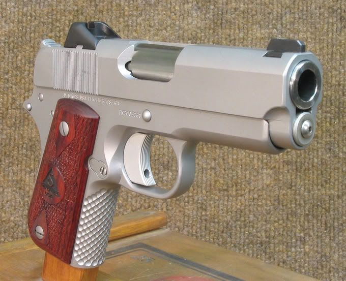

PostPosted: Sun Feb 10, 2008 5:10 pm
I couldn't find the thread either but I saved one of the pictures from when he posted them.

Thanks for the picture. Is that a bobtail? Wow, that has got to conceal well but, a hand full to fire.

"Detonics Combat Master
This first pic is courtesy of Doug Taylor from Gunblast.com
Stock Combat Master comparison.
"As mentioned above the bobtailing was possible because this gun uses a full size mainspring housing. The grip safety is inactive and the sear spring and hammer strut are severely chopped. I was still able to get a nice trigger job at 4.5lbs but it wasn't easy!
As for the rear sight.....well form follows function. Look at the pic of the stock gun, the front sight was .100" tall and difficult to use. Customer wanted a white tritium dot up front on a useable height front sight. Increasing the height of the front sight .075" required the same increase in height of the rear. I fabricated the new sight and mounted it as far to the rear as possible. The wall thickness of the top of the rear of the slide was the limiting factor.
The gun shoots surprisingly well! The high cut made room for about 2 1/2 fingers. It's accurate and controllable, a lot more than it would seem. It kind of feels like a J frame in the hand.
This gun was built with a limited budget constraint. Many of the cosmetic touches normally found on my work are missing. But it will serve its intended purpose well.

Thank you Mr. Rogers. Nice looking pistol.

Chuck, that is the nicest Detonics I have ever seen.

G~d, I still just sit here and stare at that melt job to the rear. Curves like that generally come on women. A friend owns a Detnoics he had Clark do a carry job on way back when. After oogling yours, and having shot his-- I'm all the more determined to get my hands on one-- or create something Behlert woulda grinned at.
You give us would be a high standard to meet, Chuck, but I'll be if it's not a golden standard for work.

I can't say that I'm a Detonics lover, but that is one nice looking pistol! It might change my overall attitude toward them, or at least make me see their potential. I guess some call pistols "attitude changers" but I don't that kind of attitude change was what they had in mind.
