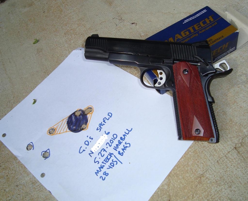

When I did this for "G" the first time, he did not want to replace the barrel. I think his shooting advanced to a level where he started to question the level of accuracy with the factory barrel, so part of the job here was to re-barrel the gun. I used a Kart Easy-Fit. I think these were a good move by Kart, and for my part it does not make a ton of dif if it's an Easy-Fit or a "regular" gunsmith fit, but sofar I see a lot to gain and I think nothing to loose. Accuracy out of Kart barrels, well, I might say they are "as good as any", and that's true, but sounds like faint praise. It would also be accurate to say "none better". Bottom line, my experience is that most aftermarket barrels are really, really good. I like Karts because they are more available and less costly than most. I have never had one break, wear out, or give mediocre accuracy.
Why, oh why, did I not stop at four shots on this target? Four out of five into 1 1/8" at 28 yards, with the wrong glasses on. #5 made it 2 1/2. The MagTech ammo has been pretty consistent for me overall and is not "lite" and not "too hot". Seems like 230 FMJ is not necessarily the most accurate option in .45 ACP, but some of my best hardball groups in the last year have been with MagTech, CCI Lawman, and PMC.

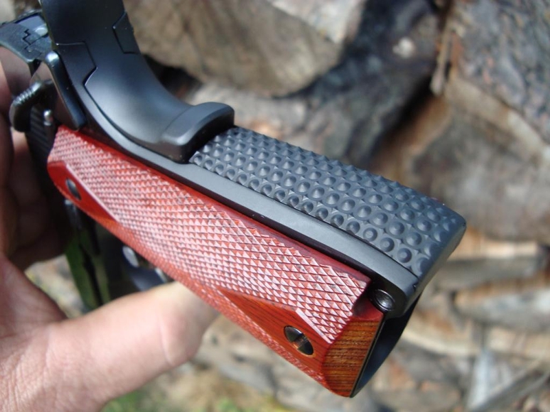

Notice the Conamyds on the mainspring housing are a little extra-pointy, at "G"s request.... except at the very bottom, where they are less pointy so as to reduce the wear and tear on jacket linings and such.

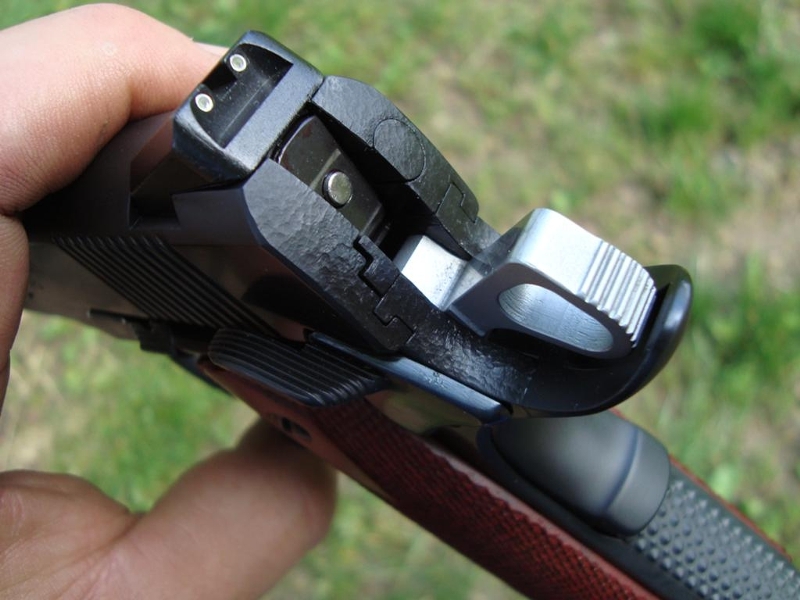

The rear of the slide has been mottled...... just experimenting around a bit.

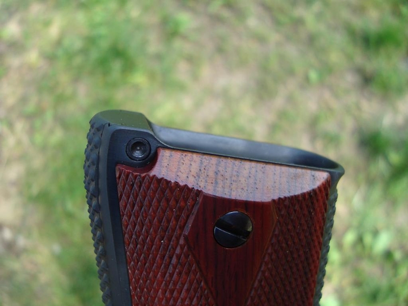

The FLH magwell. This particular guy does not care to have the grips overhang and "become" part of the magwell area. He has me shorten and re-bevel the grips and I have to admit the result is not bad...... grips are Hogues I believe, going by the quality of them (he supplied them).

Another unique pistol for me to lust after... I love the "pointy" conymids and how you made them progressively less so toward the end of the MSH. The treatment on the rear of the slide is super interesting as well. Pretty sweet for a "re-do".

a question here and reaching back to the Trident thread, Are the Conymids done on the CNC or they a labor intensive process. I have a 1911 i got used that has a form of them, and its very grippy without leaving skin on the gun at the end of the day.
The reason for asking was the comment on the trident thread that stippling (which I presume is hand done, and thus man hour dollar intensive) was cheaper than checkering or golf balling or other treatments. SO which is it? which is the easier less expensive way to do it?

Guntotin- most of the grip treatments are time/labor intensive. Most are cut on manual mills by hand in purpose made jigs and fixtures.

The gradient of "pointyness" on that MSH makes a lot of sense, along with being very aesthetically pleasing.
