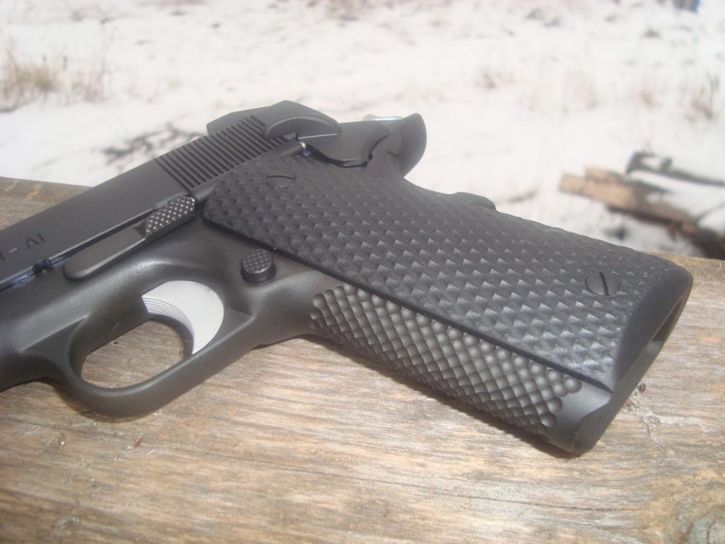

Overall left side:

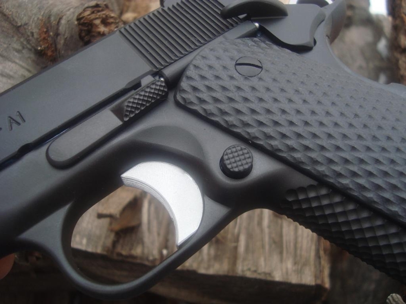

Chuck's excellent Golfballs abound on this one. I think it's the best self-cleaning traction treatment going:
Image\\
Golfballs, a little closer. This one also shows Chuck's signature dehorning..... tried my best to emulate it on the top end:

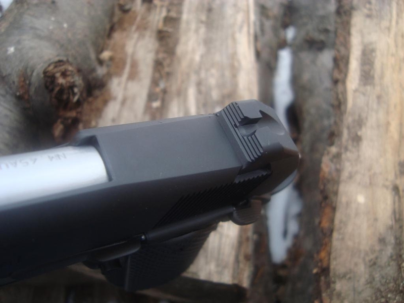

Part of my part: Shield Driver sights. Why is it that lint and water drops can't be seen in real life but they jump out at you in pictures?
Shield Driver rear sight and matched, textured slide rear.... EGW extended ejector.

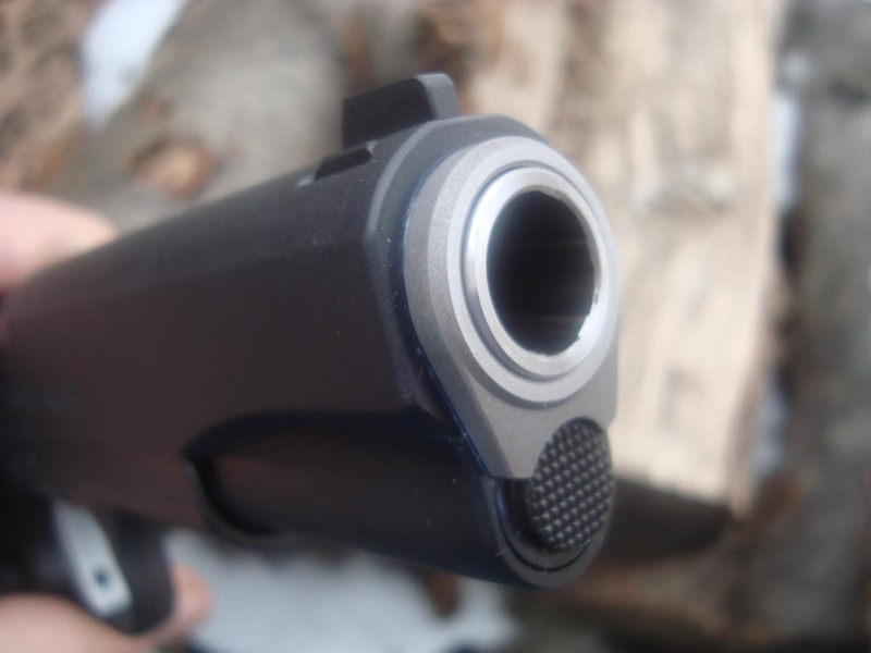

The front end-- an EGW stainless 80% bushing that I have bored, then angle-rebored to fit the Springfield match barrel.... also has my sculpted, angled front face:

Something else about Chuck's work that always impresses me..... the efforts on the thumb safety. This thing's safety has the equivalent of a Rogers trigger job on it-- so crisp and positive, no bounce-back, no "creep"..... I'll bet the new owner spends the first few days just sitting there savoring that perfect click up, click down......
