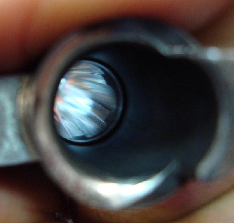

J's new barrel today. Trying to get a round count since it was installed, I'm gonna guess 8K.
Second pic shows this barrel unfired in July 2010, with the old barrel to its right.
PostPosted: Tue May 24, 2011 2:04 pm
Posts: 625
It doesn't look that tired. (Says the man who has seen "J" break out another carton of ammo in order to post a superior score. Superior to mine, I might add.)

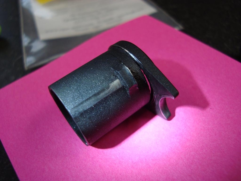

Why, one might ask, was J's gun back in my shop....?
PostPosted: Wed May 25, 2011 6:21 pm
Figured it was just time for the annual rebuild :lol: once a year or every 20,000 rnds whichever comes first.
PostPosted: Fri May 27, 2011 6:34 am
Posts: 4440
Yep.... ejector tip (extended) was broken off too.
Any theories on why the bushing broke?
PostPosted: Fri May 27, 2011 11:47 am
Very educational post!
PostPosted: Sat May 28, 2011 5:32 am
A stress riser combined with a little coil bind at some point?
PostPosted: Sat May 28, 2011 8:10 am
Posts: 4440
You made short work out of that, John!
That's the Clark bushing with the three raised "fitting" pads. That was the only bushing I could find that would go to .710" diameter-- J's gun has an unusually large bore in the slide. But, this bushing also has a very reduced ahead of the pads-- I think it's almost down to .690. Plus, at the junction of the tubular part of the bushing and its flange, there is a very sharp corner, where many bushings will have maybe a .005 radius.
The recoil spring plug (guide and plug, both standard GI-style parts) was one with the dented-in feature to keep it connected to the recoil spring for disassembly. Now if you don't "screw" the spring into this, it will just automatically flex over it, right? I believe that in this case, it did not, and when the recoil spring guide entered into the plug, then the spring could not clip over the dent, since it was now blocked from moving toward center by the guide..... so the result was the same as solid stackup. The spring itself was not overly long.
Think about this-- if a guy were to hastily reassemble his 1911 so that the recoil spring plug was not centered in the bushing, in other words, the bushing is turned slightly causing the recoil spring plug to be positioned maybe 3/32 further to the rear than it was meant to be.... J assures me (and I totally believe him) that this never happened, but I wonder if it could happen in reholstering or some fast and rough handling....?

Clark Bushing=Casting
I think maybe thats a contributing factor :shock:
PostPosted: Mon Jun 06, 2011 7:25 pm
Posts: 4440
Somebody else told me that, but I looked very closely and didn't think so. Are you sure? And I've never heard of them being especially break-prone but you just don't see them that much.
PostPosted: Tue Jun 07, 2011 3:58 am
I am positive on the casting.

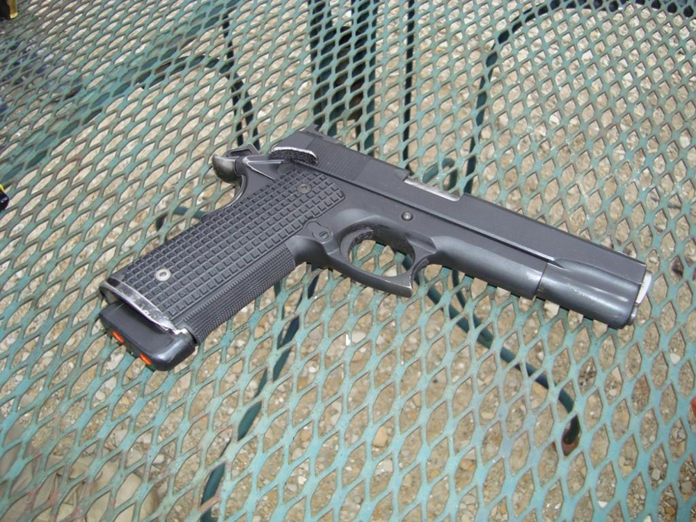

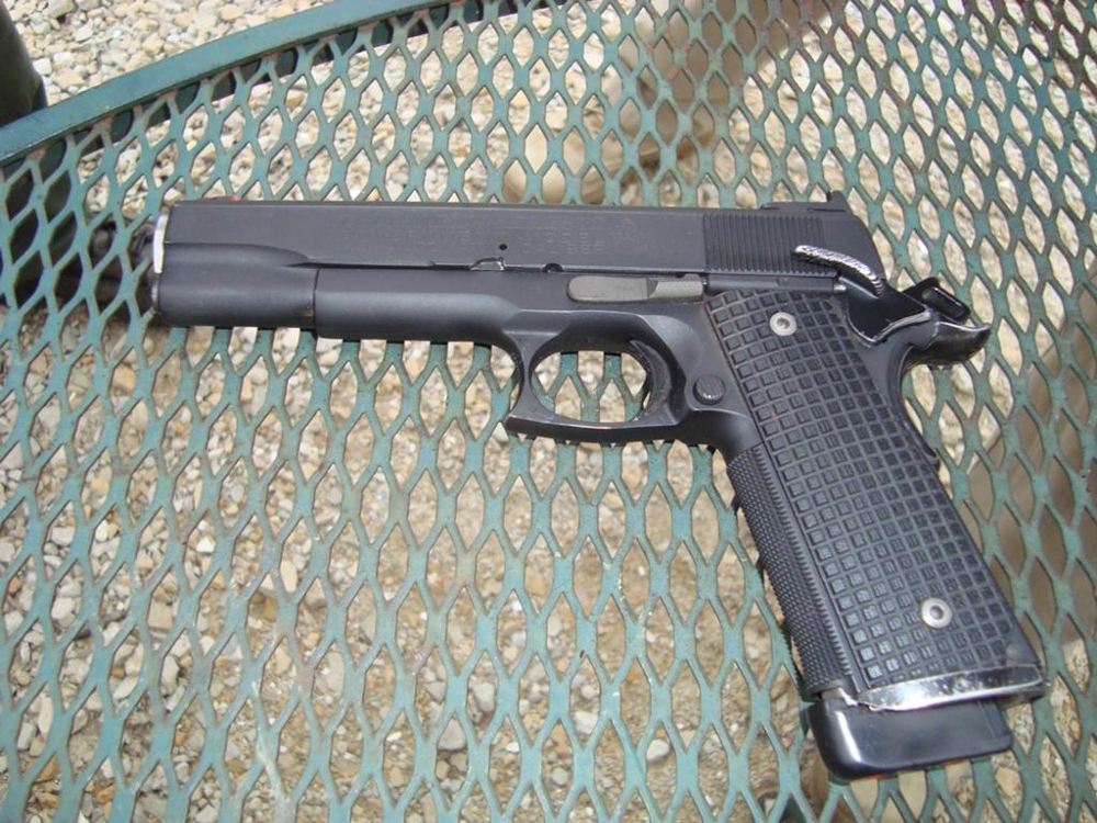

The high-miler in its entirety. I recently presented J with a set of Frag grips (before the Frag double diamonds came out).
He has very specific preferences in things. One of the few guys who does not care for a high-cut grip safety. When a guy shoots this much and this well, you don't try to change him.....
Left side:

Please excuse my ignorance, but is that a hole in the slide? Is there a purpose for this?
Thanks.
Thanks.
Cody-- we tell people it's an oil hole 8)
The slide was cracked there and I drilled that hole to end the crack. Seems to have worked sofar. Not something I'd normally do, I would normally tell a customer no way, we need to get a new one. Guess you could call this an experiment.
