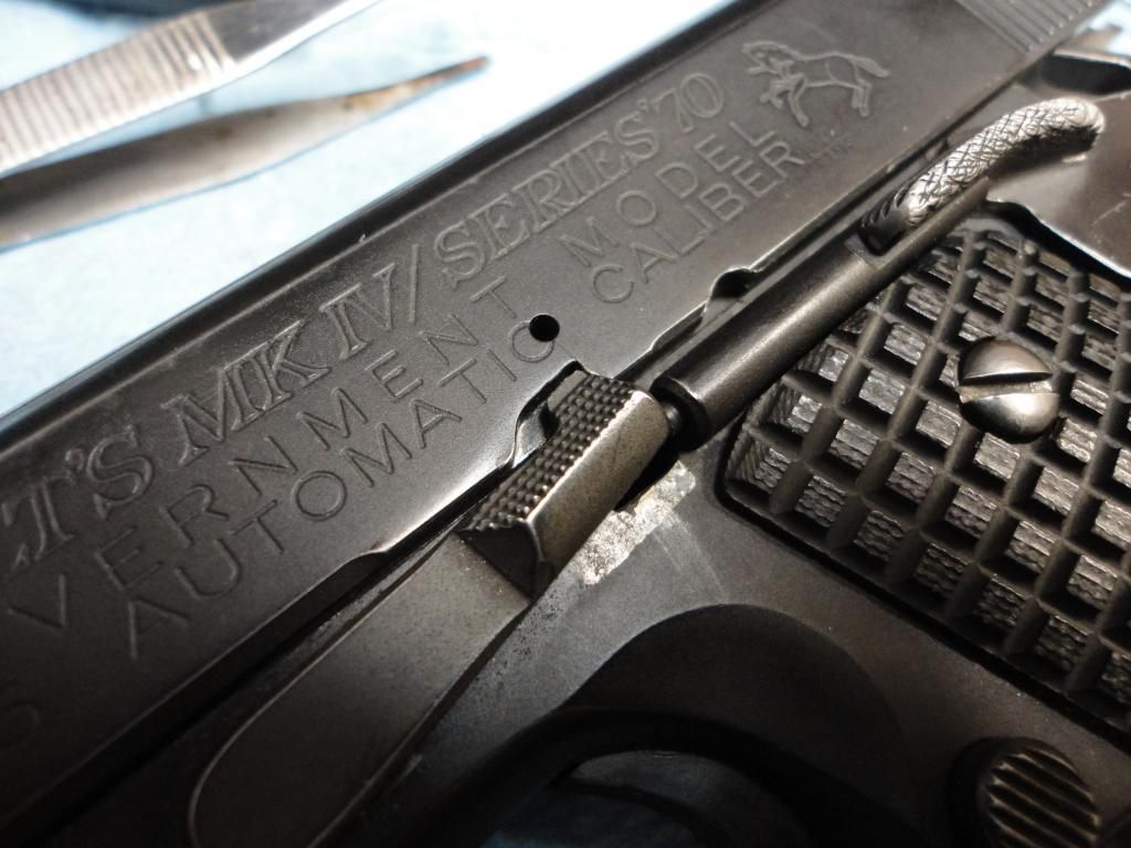

Please excuse my ignorance, but is that a hole in the slide? Is there a purpose for this?
Thanks.
Cody-- we tell people it's an oil hole 8)
The slide was cracked there and I drilled that hole to end the crack. Seems to have worked sofar. Not something I'd normally do, I would normally tell a customer no way, we need to get a new one. Guess you could call this an experiment.
Ah, thanks Ned. I was merely curious as I haven't seen this done before. Awesome build BTW.

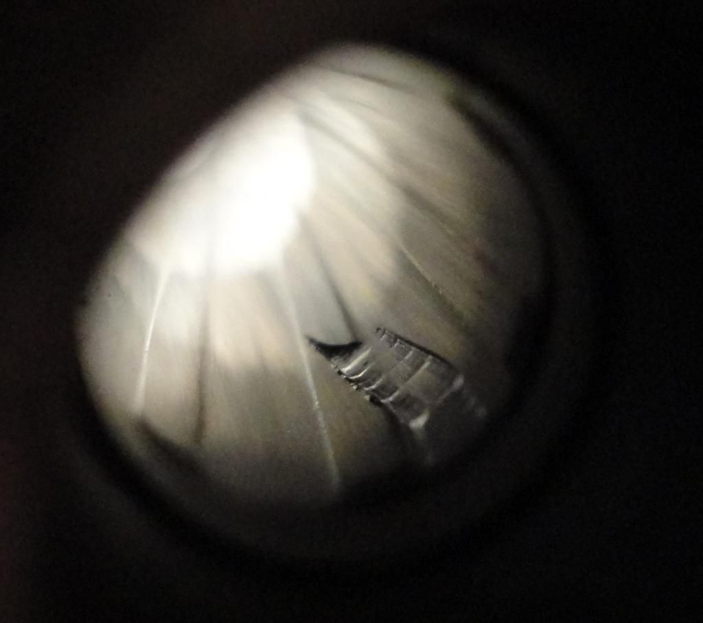

J's barrel a couple weeks ago. I was fitting a new bushing and found this.
He doesn't know how it got there. There was a stuck bullet some time ago that he had to beat out but he's sure there was no damage-- and this looked kinda fresh. What to do, he asked. I said shoot out the burrs and let's see what happens. There is probably at least another thousand on it since then and no issues, no accuracy complaints. I watched him shoot maybe 200 rounds earlier in the week and it'll put them in one hole at speed at 6 yards, not a real accuracy test maybe but enough to say it's not shooting all over the place.
PostPosted: Thu Aug 14, 2014 9:55 am
Posts: 616
That sure looks like a chip of steel (and where could it have come from?) got ahead of the bullet, and was driven forward with 17-18,000PSI of oomph.

This well-used Colt as of 9/9/16. No new cracks! Compare to previous pics to locate the welded areas.
The barrel—that gouge is polishing out nicely. Round count since last pics—my guess— 10K minumum.
The bushing. This gun has an inexplicably large slide bore and has been through several bushings because they move around and the lug gets deformed. I finally sleeved this one up, silver-brazing a piece over it and fitting it to the slide. Seems to be holding up.
The crack in the slide has not gone past the hole I drilled long ago. If you want your barrel clean get the blue Nylon brush from Iosso and wrap it in Chore Boy copper pan scrubber.
