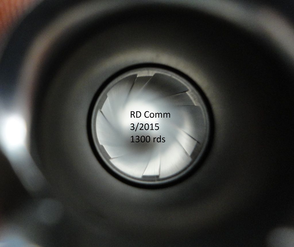

PostPosted: Mon Apr 18, 2022 4:49 am
Ned. How do you take that picture through the barrel. This is not pertinent to the Commander. I have gotten some kind of okay pictures for folks but no where near as good as you have.
