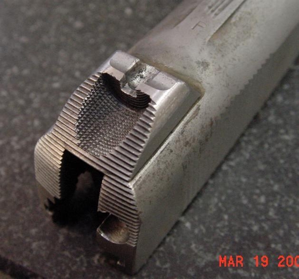

I ran across this old pic while looking for something else. One of the very first Shield Drivers, you could say.
More later on slide rear serrations and how, when I do them, I wish I could just be Jason Burton :-)
The pic is from 2008 but the sight is from 1983.
