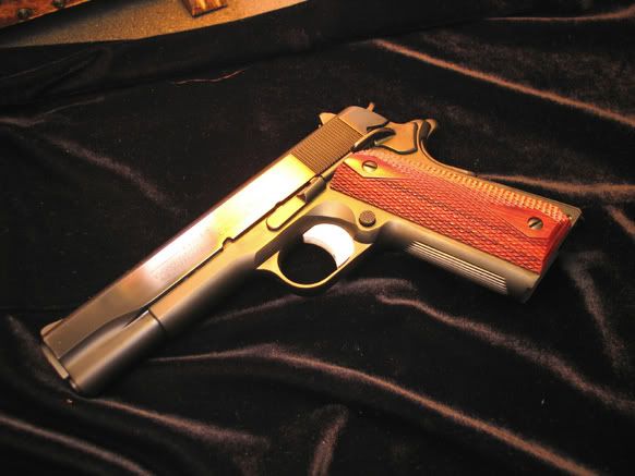

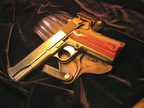

In some circles using the term "working gun" means it has flaws or is less than another gun. Not the case here. This is a gun that is void of extras some others may want on their pistols. Keeping the traditional look of a Colt and addressing some necessary items makes for a very nice gun.
Some nice extras on this one with the idea that it is going to get shot.........a lot. Theophorus, enjoy your new shooter.

That gun is gorgeous! Can you please list the work done on it and what kind of grips those are? How much would it cost to get that done to my older 1991A1?

The grips are stock Series 80 grips. I just returned home, and so I'm going to drink this ice cold beer, rub my new gun all over my body, and then I will list the work that was done.

Duty Grade trigger job with Nowlin sear
Trigger (Medium) fit to gun
Ed Brown SS safety--installed, dehorned, and narrowed
Ed Brown flat mainspring housing
Serrate mainspring housing w/custom pattern
Classic Retro Sight package--Yost/Bonitz rear, silver brazed front
Bevel magwell
Complete reliability package--Wilson 101 tuned extractor, tune ejector, polish feedramp and throat bbl., polish breech face, chamfer firing pin hole, and ream chamber if neccessary.
Flatten and serrate top of slide 40 lpi
Hi-cut frontstrap
High-cut and bob hammer
True and serrate front strap (points top and bottom)
EGW slide stop (blue/dehorned)
Yost-Bonitz lanyard loop
Dehorn complete pistol
Fit King's bbl. bushing
1* back-end treatment
Satin matte bead blast and blue complete pistol, polish side flats
That's it.

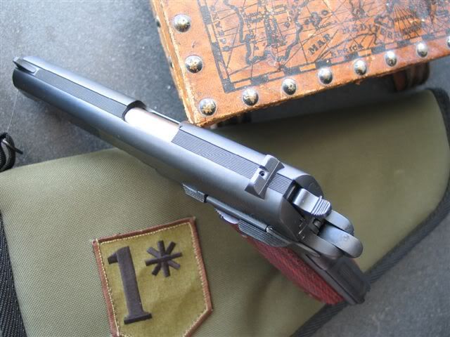

I thought I'd post a pic that shows what a nice job Ted did on the top of the slide.

Those sights and the slide treatment look great. Nice gun Theo.
