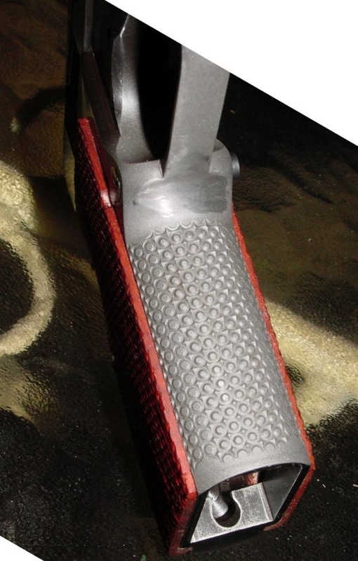

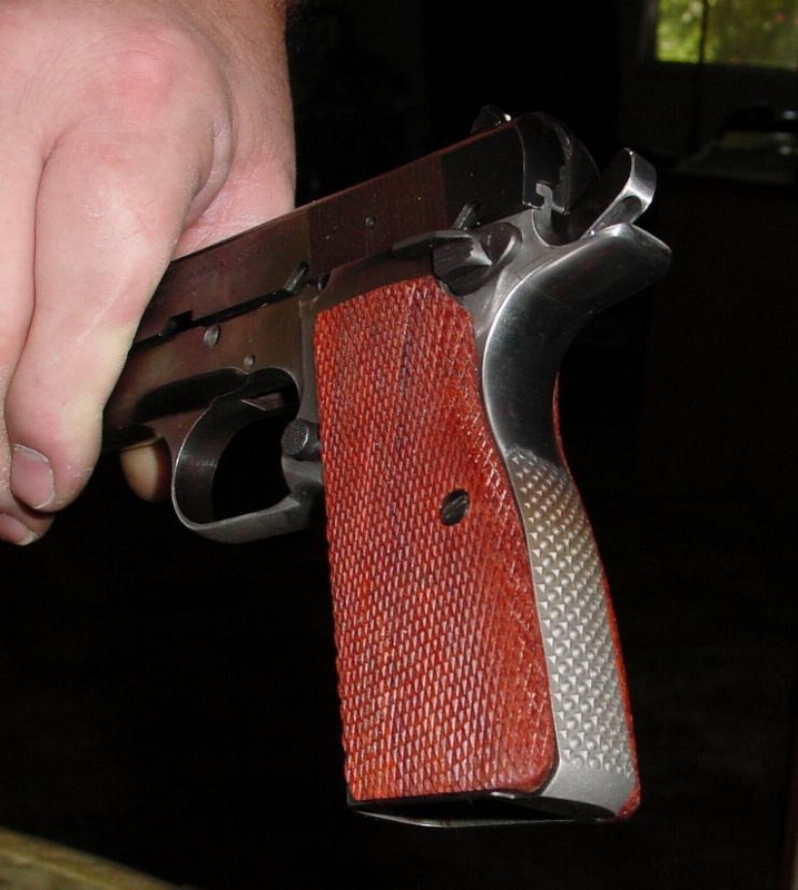

Have heard several people say that Conamyds may not belong on a BHP..... I say if they're OK on a 1911 they must be OK on a P35, but...... these pics may not be for everyone. If in doubt please have a bag handy! Not responsible for keyboards disabled by chunks
:wink:
Conamyds with hi-grip in front, depth lightened up a bit over the thin spots. Conamyds back, following both contours of the backstrap.

If you look closely you'll see that the Conamyds are shallowed up a tad around the edges.

Sorry to say this gun is now out of my reach. Did it for an old pal who is also a gunsmith but works on different stuff than me, don't know if he's finished it, doubt it, and it will probably be a while.
But, the beavertail is way high, so the hammer had to be abbreviated in the back. Slotted it too just to lighten it up a tad (but mostly for styling, he did say make it look different).
