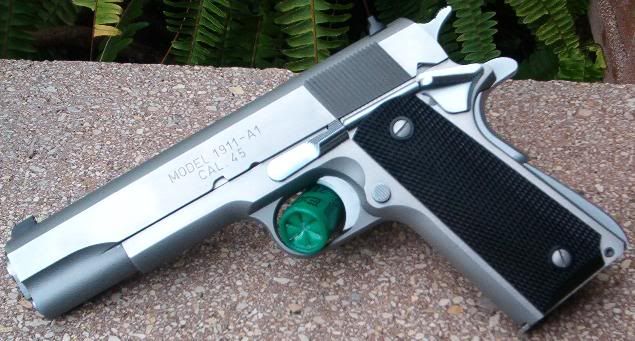

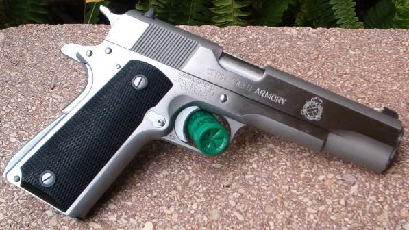

...For me , a custom pre series 70 colt or large letter series 70 is more attractive that a Springfield or 1991 with the same custom package.
I've always been a big Colt fan, but ran across this NM numbered Springfield a while back. W/ great slide / frame and barrel fitment, & no "FI BRAZIL" stamped on the frame, I thought it would make a good base gun.
Regards - GCF

... The frame to slide fit is head and shoulders above the average Brazillian gun and they usually come with decent one piece stainless barrels. Not match grade units but they appear to be the equal of a standard Colt barrel anyway.
Copy that "head & sholders" bit. Think you may be understating the quality of the barrels though.
The stainless Milspec shown above feeds & shoots (right out of the box) better then my Colt XSE LWT Commander did when new, & shoots as well as my Kart NM barreled Series 80 Gov't Model.
Pretty well impressed me. If I end up keeping it I will have a bit of work done, but re-barreling won't be on the list....
Not running down my Colts either, they are both 100% "go to" guns.
Regards - GCF
"Sometimes you make eight - Sometimes you hit dirt"
