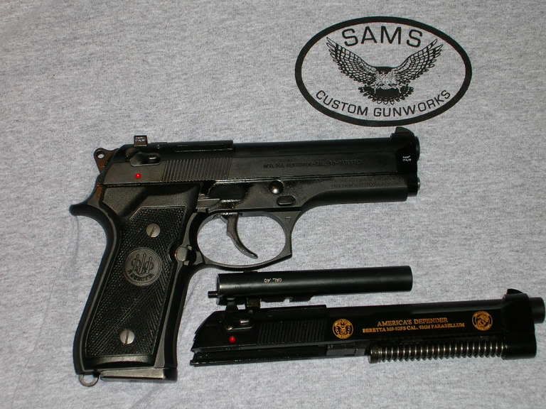

So in that vein, how about a custom Beretta by Dave Sams.
It started out as a 10 year commemerative model M9 with corresponding serial number and the gold inlay slide lettering. Dave decided to do a little tinkering and voila! A 3 caliber conversion was born. A .40s&w Centurion slide was procured. Long with another compact 9mm barrel which he then recut the chamber for .357sig. Two top ends, three calibers-9mm full size slide and Centurian compact slide in .40/.357.
He wanted one set of mags to work all three calibers. After trying different mags, the ones that worked are the military GI with metal followers. He opens the feed lips a tad and contours them. 100% in the range time we tried with all calibers.
Next was action/trigger/reliability internal work. Every pin was addressed, Transfer bar sanded/stoned. Hammer sanded and stoned. Hammer spring replaced with a lower weight. Every internal surface/contact point was polished. DA pull is just over 8 pounds and SA pull is 2 3/4 pounds!
The .357sig was the accuracy winner and now rides on my side. As a combat weapon I cannot think of a finer combination.
I can see why Dave builds the best Berettas for AMU and private competition. These are guns meant for shooting!
.357sig in complete gun, .40sw barrel under and 9mm full size commemerative side at bottom.

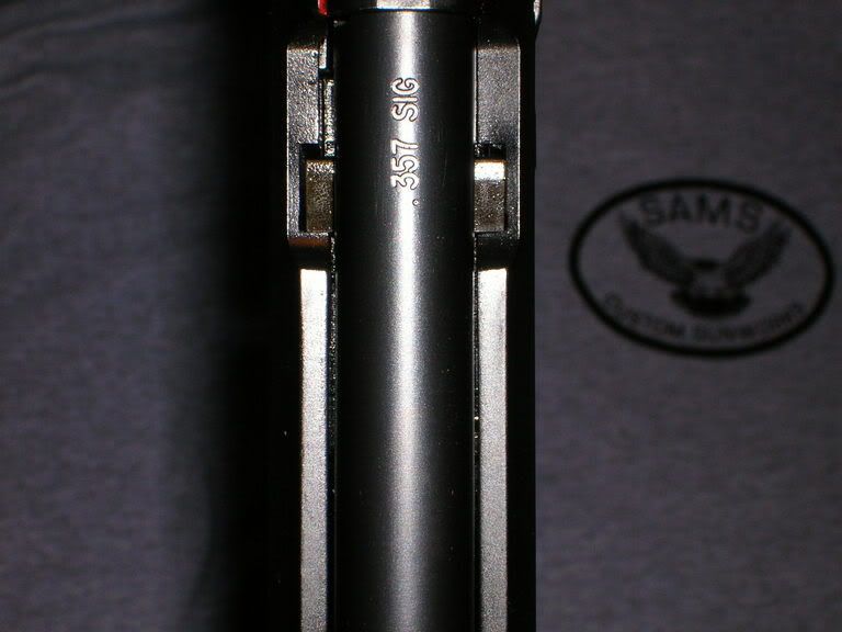

I forgot this pic. The one that not too many will see on their Beretta's barrel!
I cannot begin to describe the internals on this combat handgun. My words would just seem inadequate.
