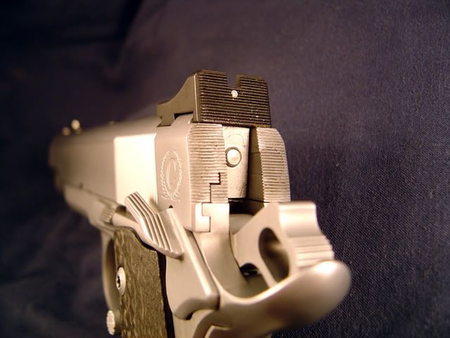

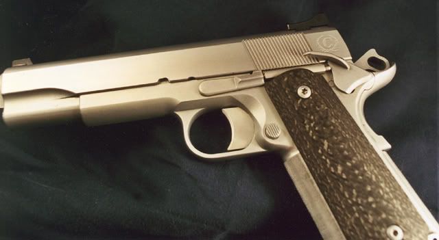

Awesome example of a first time effort, it looks great. Was it all done by hand or did you do some machine work? Building your own is great isn't it? I love to do it almost as much as shooting them. Your son definitely has a great heirloom coming his way. At first I was going to build one for myself, then I figured when I die I want to leave one to each kid, which meant four but turned into five. So after deciding what five to build I totally fell in love with doing the work and now I plan on many more.
Is that a Heinie magwell? Do you do the handcut 40 lpi? If so that's quite an undertaking for a first effort. Kudos to you on a nice project.

Josh - Aside from a Foredom, everything was done by me, by hand. I spent plenty of time (100+) hours hunched over the bench staring through an Optivisor and filing away. The 40 LPI checkering wasn't as bad as I anticipated, but I can see the advantage of getting a mill set up to do it on that.

WOW! Doing those sight cuts by hand! I wouldn't even think of trying that! Great work!

Well to me it looks like one hell of a nice build. How bout some specs in it?

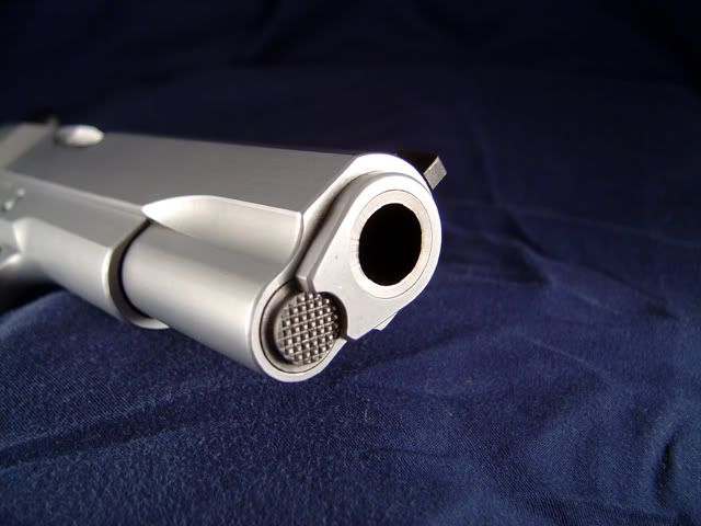

Thanks for all the kind words and encouragement. First I have to clear up a misunderstanding... The sight cuts were put on by Caspian before they shipped me the slide. All I did was open them up a bit. For the record, I have hand-filed sight cuts into scrap iron around the shop, and had good results, but what a needlessly painstaking process!
Scot requested a quick spec sheet, so here is what I can remember at 1 am....
Kart barrel, flush cut and recrowned 11 degrees
EGW bushing
EGW ignition parts w/ Heinie Ultralight trigger
Heinie Straight Eight Sights
Heinie magwell
Wilson Beavertail
C & S Thumb safety
EB Slide stop, undercut pad and edge-beveled, shortened and hole chamfered
Kings Guide rod/buffer system
Handcheckered MSH and frontstrap, 40 LPI
Serrated rear of slide 40 LPI
Yost-Bonitz Carbon Fiber Grips, modified for the magwell
Slight dehorn over entire pistol
