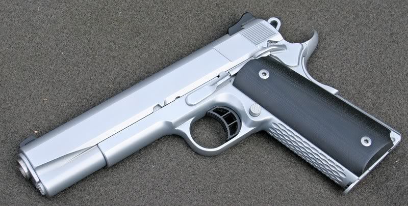

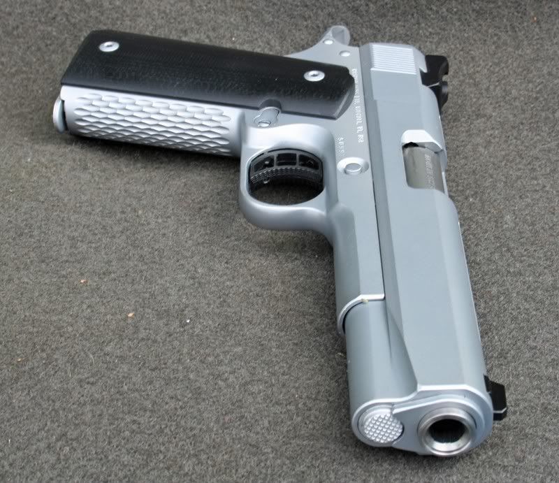

Well guys, I finally got this gun hard chromed so I can now call it complete. It is kind of a "team gun" of sorts as it was my first 1911 build from about three years ago and had the hands of many on it.
Here is a brief rundown of who did what:

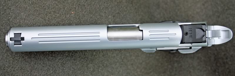

All slide machining (top round flutes, sight cuts, lower bevel, panel cuts and cocking serrations) none other than our own Ned Christiansen
Mainspring housing was purchased pre-scalloped from Burns Custom

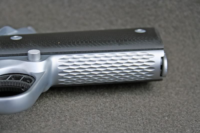

Front strap scallops by Scott Mulkerin at SDM
Ramp barrel cut in frame and barrel installation done by Ed Cameron.
I ran into a few barrel issues initially and my friend Barry Greyson looked at it for me and went over a few things and then we sent it to Ed Cameron for the barrel installation and Ed went over it for me and checked the work I had done since it was my first ground up build from all new parts. This proved invaluable not only because the final product is great but also because I was able to go over what he did and learn a lot about building a great gun.
This gun overall was an awesome learning experience, especially being in 9x23 Winchester which probably is not the best choice in calibers for your first build. I have done a few guns since then for some friends and built a few others for myself and this gun and the help from the smiths involved taught me a lot. Since getting the machine work done on this one I bought a mill and a boatload of tooling so I plan on doing most of my machine work in house from here on out. I used the gun in the white for about three years before finally hard chroming it. Tripp did the hard chrome and Cobra Coated the sights.
Since we are all detail oriented here I'll include the parts list too:
Caspian cast frame
STI slide (ordered bald and no logo)
Heinie Low Mount Sights (for Novak cut)
Nowlin ramped 9x23 Winchester barrel and bushing
Nowlin 9mm Slide Stop
Colt 9x23 Winchester magazines
Burns Custom Ignition Group
Burns Custom Grip Safety
SVI Thumb Safety
EGW Ejector
AFTEC Extractor
Ed Brown GI type Spring Plug & Guide
18.5lb Wolff Recoil Spring
EGW Firing Pin Stop
Ed Brown Pins
Ed Brown Mag Release
STI Trigger
Nowlin grip screws and bushings
Unknown Micarta Grips
And enough talk, here are the pictures

That's slick! Really slick!
That slide treatment (all of it) is pretty neat. Yet another example something that might not have sounded good to me, but I like it when I see it.
The chrome sets it all off, I think.

Nicely done. That is a fine looking pistol.

Great lookin' gun. The list of contributors reads like a who's who of pistolsmithing.
Mulkerin did a GREAT job on those scallops.
I see that someone else is calling scallops 'exclusive' to his pistols.
:wink:
Webster's dictionary disagrees.

Josh, not to steal you thunder, that is one hot looking shooter. There isn't one thing about that gun that I wouldn't have done to one of my guns. When I get my next two projects out of the way I think I am going to have a 9X23 barrel fit to my Caspian/Tripp 9MM.
To echo Chuck's comments about Scott's frontstrap work it is very nicely done. Scallops are quickly becoming an obsession for me.

IIRC the first place I saw scallops was on a Richard Heinie gun. And IIRC again he posted here or another forum that he did not "come up" with the idea but that he saw it from one of the guys at STI but I can't remember who. Now the way Heinie does them (or at least DID them) left a little space between them and it was a less agressive purchase than the way Chuck & Scott do them. I think I saw one by Chuck first where the spacing is a little closer, or perhaps cut a little deeper so that the scallops intersect forming sharp lines such as the front strap of this gun. This method I feel gives much more "stickshun" (Ned word there I think :) ).
If I were the originator of an idea I would be a little perturbed for someone to call it exclusive to them. It's only exclusive in that it is cut on their equipment vs. someone else's but it looks like what the custom smiths here and elsewhere have been doing for what, 5 years or better? Hardly exclusive when there are hundreds if not thousands on custom guns. Not to mention STI calls it STIppling on their Trojan series.

Long time coming Josh! That musta been three years ago I worked on that slide?
