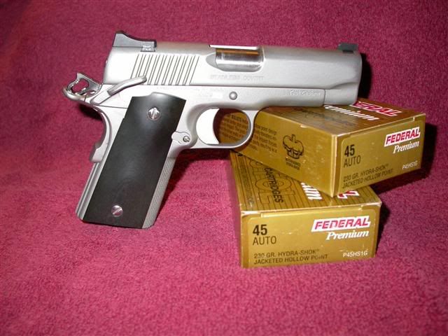

I like the Pre-Series II Kimbers, and share in the opinion that the Series II models are not worthy of owning. Here's a photo of a Stainless Covert Ted did for me about 5 years ago...
-Tim
Edit: Repaired broken link after modifying Photobucket account settings.
