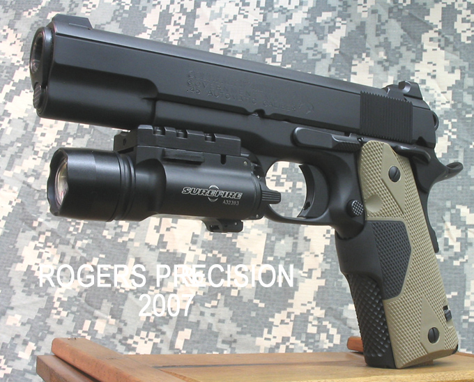

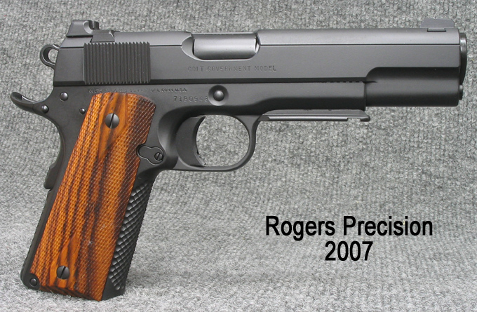

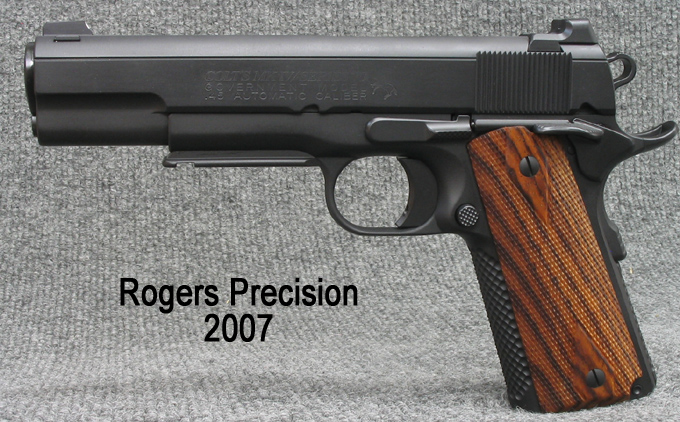

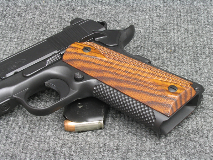

Recently completed for a member of this forum.

what a gorgeous duty gun. clean and elegant. did you make the rail?-cam

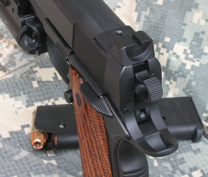

Nice work Chuck. That rear sight is great!

 Post subject: Light rail?
PostPosted: Sun Jul 01, 2007 9:19 pm
Posts: 540
Who manufactures that light rail?
 Post subject: Re: Light rail?
PostPosted: Sun Jul 01, 2007 11:10 pm
Joined: Sat Nov 12, 2005 9:09 pm
Posts: 31
Location: San Diego California
Dawson Precision

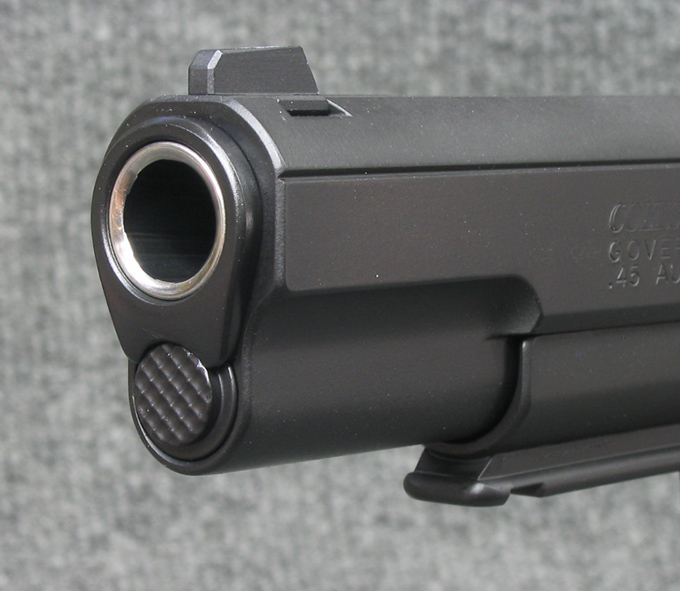

PostPosted: Mon Jul 02, 2007 9:03 am
Posts: 386
Location: Richmond, Va.
Chuck, that looks like EGW bushing, but which one is it?
 Post subject: Dawson Precision rail?
PostPosted: Mon Jul 02, 2007 9:18 am
Posts: 540
Does that Dawson Precision rail installation require rebluing the entire pistol or is it a "bolt-on" installation?
PostPosted: Mon Jul 02, 2007 9:27 am
Thanks for the kind words fellers!
Full specs in a few days.
Until then:
Rogers' 'Tier One' sights.
King's bushing, reworked.
Dawson rail, bolt on.

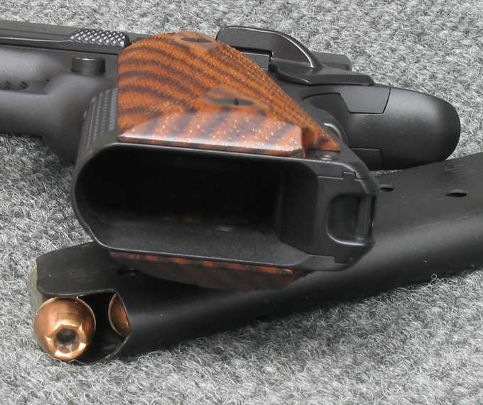

That is an awesome blaster. I keep coming back to this post to find new details in the work. Love the mag well opening and the rear sight.

Love the mag well and the lanyard loop. Very Nice~

I thought I'd cut and paste the build list as Chuck has better things to do with his time.[:D]
"Here is the build list:
Colt’s Series 70 repro #71BXXXX
Fit slide to frame. Match grade.

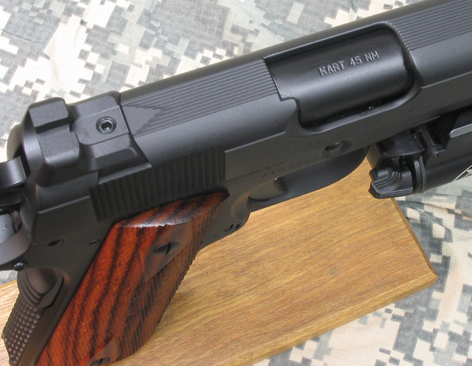

Kart barrel.
Wilson link.
Reliability package.
Match grade barrel bushing. Recontoured.
Flush cut and match crown muzzle.
Golfball texture recoil spring plug.
Wolff 16 lb. recoil spring.
Oversized, fitted firing pin stop.
2 Wilson tuned extractors.
Rework ejection port.
Extended ejector, reworked to suit.
‘Ball’ cuts at end of slide.
French cuts.

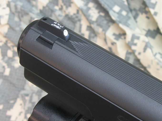

Chamfer bottom of slide at 60 degrees.
Remachine rear cocking serrations.
Flatten and serrate top of slide. Double arrowhead pattern.
Rogers’ ‘Tier One’ rear sight.
Cross dovetailed front sight with Trijicon tritium lamp.
Brown’s ‘hardcore’ slide stop. Recontoured and golfball
textured on bottom.
Chamfer slide stop hole and shorten and radius slide stop
shaft to suit.
Bar stock plunger tube. Permanently affixed.
Brown’s extended thumb safety. Custom contoured.
Brown’s grip safety.
Wilson #299B hammer.
Wilson tool steel sear.
Greider medium length trigger. Internally lightened.
Wolff sear spring.
Wollf 23 lb.mainspring.
Trigger job 4 1/2 lbs.
Nowlin extended magazine catch. Shortened and golfball
textured.
High cut and golfball texture frontstrap.
Legacy Custom mainspring housing. Fitted and golfballed.
Rogers’ deluxe mag well.
Recessed lanyard loop.
Dawson light rail.
Carry bevel package.
Graphite Black Ceracoat over a base of manganese phosphate.
Davidson grips. Internally lightened.
Range time and test ammo."
