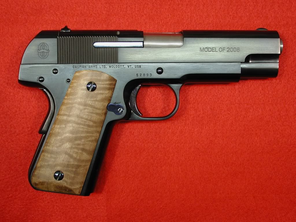

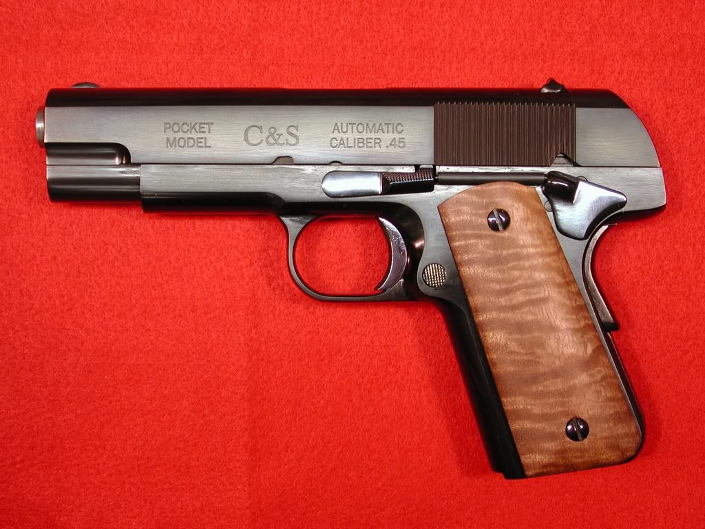

What could be better than a Pocket Hammerless in .45 ACP. That was the thought when I visited with Bill Laughridge several years ago. After a lot of hard work and hours of hand work, Bill introduced his .45 Pocket Model at SHOT 2007.
He stated with a Caspian Officers Model frame and a Commander length slide. He had to extend both the frame and slide at the rear to enclose the hammer. He also recut the radius on the top of the slide to the same angle as the original Colt model.
The pistol was the hit of the show. This is Bill's personal gun but he has since taken orders for several more.
Price, if you have to ask...........

Nice! Do you have a picture of the front end? Does it have a bull barrel?

Bill used a bull barrel and then sleeved the front end so it would have the same profile as the original. It looks even better with ivory but Bill wanted to display it with wood stocks at SHOT.

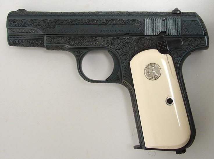

Here is a nice pocket for reference
http://www.hallowellco.com/colt_1908%2093583.htm

A little more information......The trigger, slide stop, safety, and sights are original 1911 parts.
The radius on the rear of the slide and the frame are the same as the original, just larger. The sharp eye will also notice how Bill removed a lot of metal from the top edged of the slide rounding top in a profile that is like the original pocket model.
There is a cosmetic differance with the markings on the slide when compared to the original. The slide came from Caspian with no markings or serrations. While it would have been nice to mark is the same as the original, I'm sure the lawyers in Hartford would have had something to say.

My comment was baed more on some of the angles and radii, for example, the pocket has a frame more like an original 1911 rather than the A1 with the trigger clearance cuts. The slide serrations could be moved to more approximate the location of the pocket also.
The are MINOR nits to pick--I think it is an amazing effort overall..

No offense taken. The number of hours in hand filing and labor were unreal. I am sure that there are things that will be better on future models.
Just some eye candy from another site.
