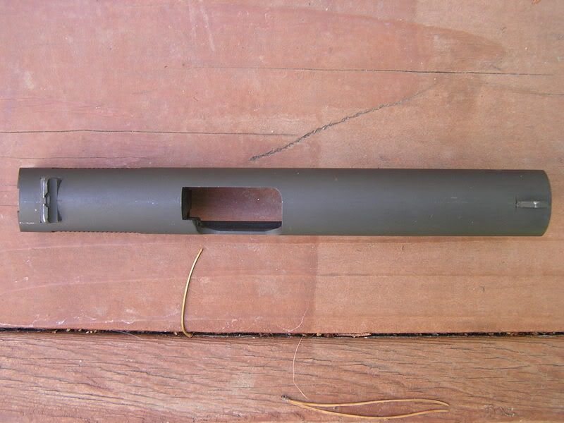

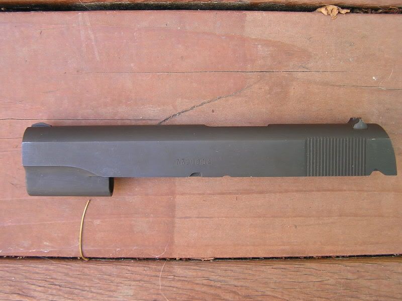

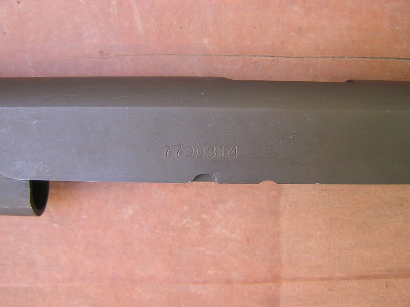

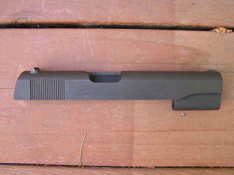

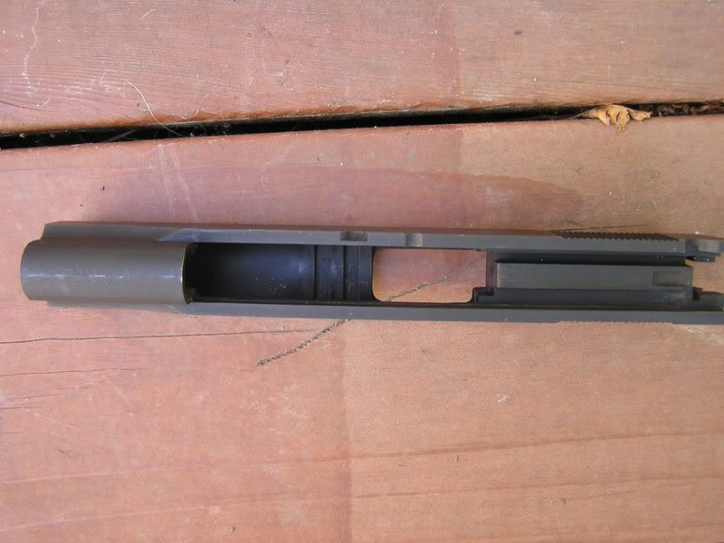

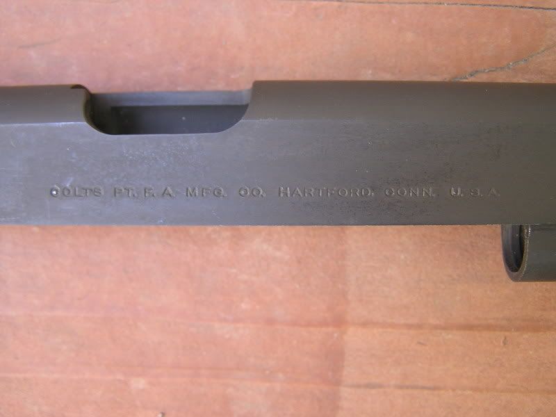

I recently bought a military Colt NM slide for a good price. It appears to be unused and the number indicates it was made in the early '60's. I've included some pics on the bottom of this post. I'm thinking of sticking it on a Caspian frame and building some sort of really basic gun like the MEU(SOC) pistols. What do you think I should do with it?

That is not a NM slide, its a 50's era "replacement hard slide" by Colt to refurb the pre 1945 "soft" slide guns in service. I have had a few and they are really superb parts and will build a NICE gun. Would be hard to get a good polished finish, but a matte finished gun will turn out perfectly.
I would look for a beater GI frame and build a cool MEUSOC or retro gun.
Most NM slides have slanted serrations and different sight cuts and blade front sights installed, although they run the gamut.

The number on the slide is not a serial number, but a lot number.
