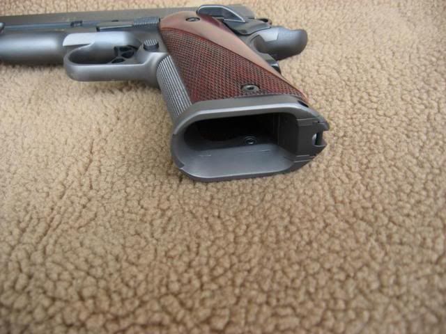

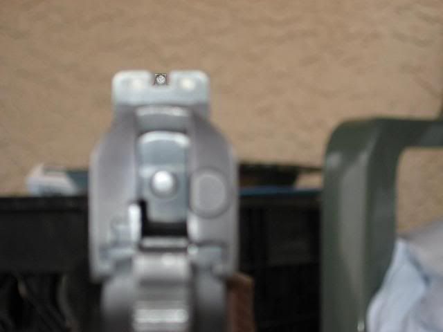

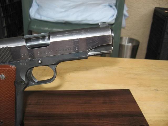

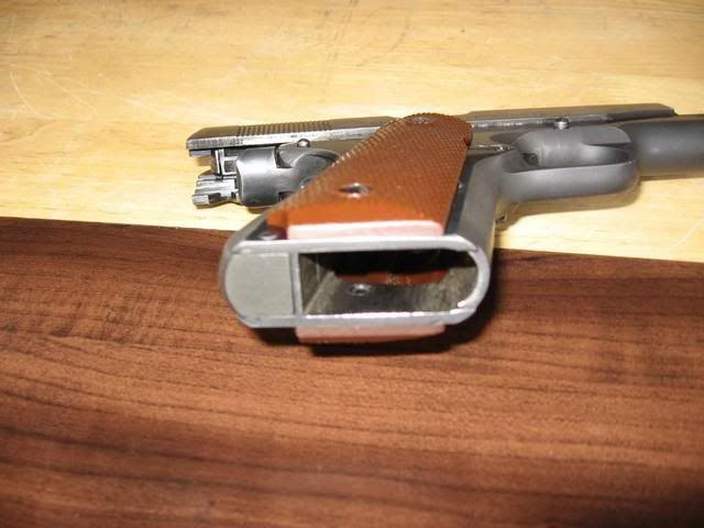

I sent this off in Febuary and I recieved it back from EGW by UPS on Thursday. (I hate UPS, they left it sitting on the front porch even though my wife was home!)
I had it built for my son and was planning on giving it to him on his 16th birthday but my just wrap it up and give it to him next month on his first birthday!
Here is the build list: (Sorry for all caps, I cut and pasted from the invoice.)
COLT COMBAT COMMANDER 70BS156XX
EGW WELD ON MAG WELL
CHECKER FRONT STRAP 25 LPI
CUT DOVETAIL AND INSTALL TRITIUM FRONT SIGHT
REAR SIGHT (10-8 CUSTOMER PROVIDED) CUT SLIDE AND INSTALL
FIT AND BLEND (STI CUSTOMER PROVIDED) GRIP SAFETY
FIT AND INSTALL STI CUSTOMER PROVIDED) THUMB SAFETY
EGW SLIDE STOP W/ CHECKERED BOTTOM FITTED AND INSTALLED
TRIGGER JOB 4# SER 70
FLAT TOP AND SERRATE SLIDE
SERRATE REAR OF SLIDE
LOWER FLUTE AND CLEAR EJECTION-PORT
INSTALL BLEND AND SERRATE EJECTOR
EGW O/S FIRING PIN STOP 45 SER 70 INSTALLED AND FITTED
EGW EXTRACTOR 45 TUNED AND SERRATED (+1 SPARE)
SLIDE TO FRAME FIT
FIRING PIN AND SPRING
POLISH AND THROAT TUNE EXT POLISH BOLT FACE
CARRY BEVEL PACKAGE
ISMI FLAT SPRING W/ SPRING GUIDE
EGW MONOGRAM CARRY BEVEL BUSHING & SPRING PLUG
FIT BARREL (STORM LAKE CUSTOMER SUPPLIED)
LOWER BARREL BED FOR CLEARANCE W/MATCH BARREL
CLEAN UP SCRATCHES
ETREAT WHOLE GUN AND PARTS
TESTFIRE PISTOL FOR RELIABILITY
Before:
After EGW's magic:

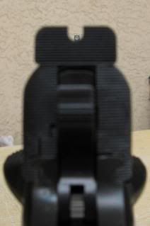

....but in the second to last picture it looks like the front sight is off a bit :wink: .
