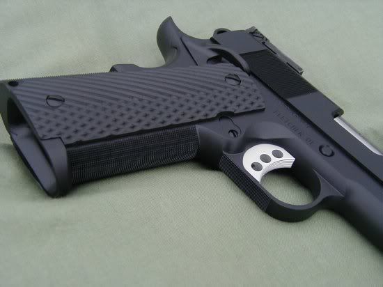

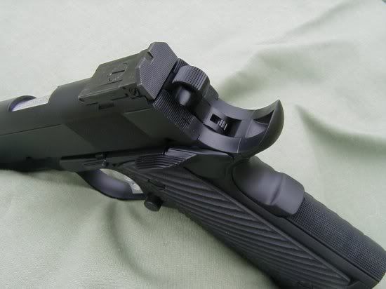

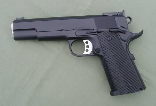

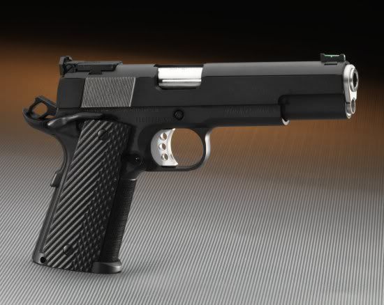

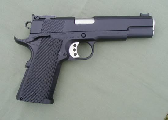

As an occasional IDPA competitor, I’ve wanted to try the Enhanced Service Pistol (ESP) class for a while. So I decided to build myself a 9MM 1911 with all the features I felt I would want for this class. Below are the results. I recently used it in the IDPA nationals in Allentown, PA (the gun functioned flawlessly, but the shooter had a few malfunctions!). The first photo is by Point Seven Studios; the other photos are mine (you can obviously tell the difference!).
Caspian Government steel frame and slide
Custom 25 LPI rear slide serrations
Schuemann AET 9mm ramped barrel
EGW thick flange barrel bushing (hand beveled)
Hand checkered 30 LPI front strap
Hand checkered 40 LPI below trigger guard
Ed Brown hammer
Titanium hammer strut and mainspring cap
Greider match trigger
Flush cut Wilson slide stop
STI ambi thumb safety
S&A beavertail
Ed Brown 30 LPI mainspring housing
French cuts on slide
Champion Tactical Competition rear sight
Dawson fiber optic front sight
Morris Custom magwell (silver soldered in placed)
Entire pistol dehorned
VZ Operator black micarta grips
GunKote matte black finish
Thanks for looking!!
