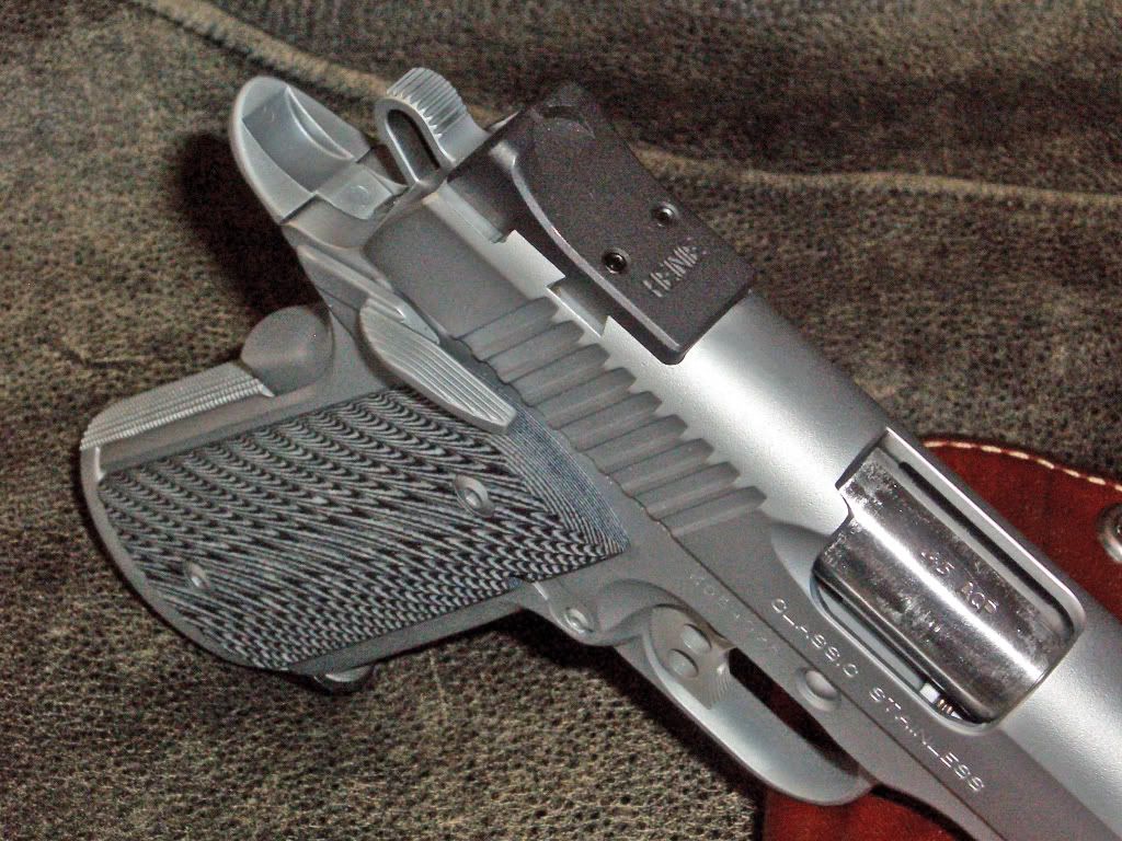

Well, here is the first post of a pistol that I have had one of the Louder Than Words pistolsmiths work up for me. After doing a bunch of research, talking to a lot of folks, shooting some pistols and deciding to be relatively contrarian to the mainstream, I decided on a Kimber Series I Custom Classic Stainless as the base gun.
Now for the choice of smith...I was lucky enough to find my personal domicile within a 45-minute drive of one of the awesome craftsmen's shops found on this site. John has this uncanny ability to listen to all of my blatherings about how I want the finished product to do absolutely everything (eat any round it's fed every time, shoot sub 2 M.O.A. at 25 yards standing unsupported, do all of this while caked in mud, etc.) and produce a pistol that certainly exceeded my expectations. He will do anything you ask, but the true value I see is his ability to be a consultant capable of morphing broad requirements into exactly what his client intended.
Now for the mods:
- Replace existing Kimber adjustable sights with Heine SlantPro set
- Fit front sight with white dot
- Fit EGW Angle Bored barrel bushing
- Fit and checker EGW recoil spring plug
- Replace FLGR with Ed Brown GI recoil spring guide
- Re-crown barrel flush with barrel bushing
- Fit and install EGW match grade slide stop
- Countersink slide stop pin hole and recess pin
- Fit EGW oversize firing pin stop
- Fit and tune Wilson Bulletproof match grade extractor
- Fit Ed Brown ambidextrous thumb safety
- Fit existing S&A mag well and blend to factory beveled opening
- Fit and tune extended magazine catch
- Carry Bevel Package
- Function Reliability Package
- Refinish pistol in all-matte hard chrome

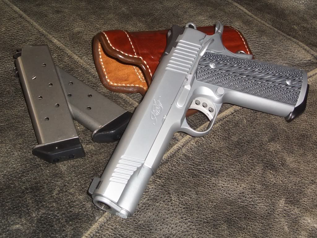

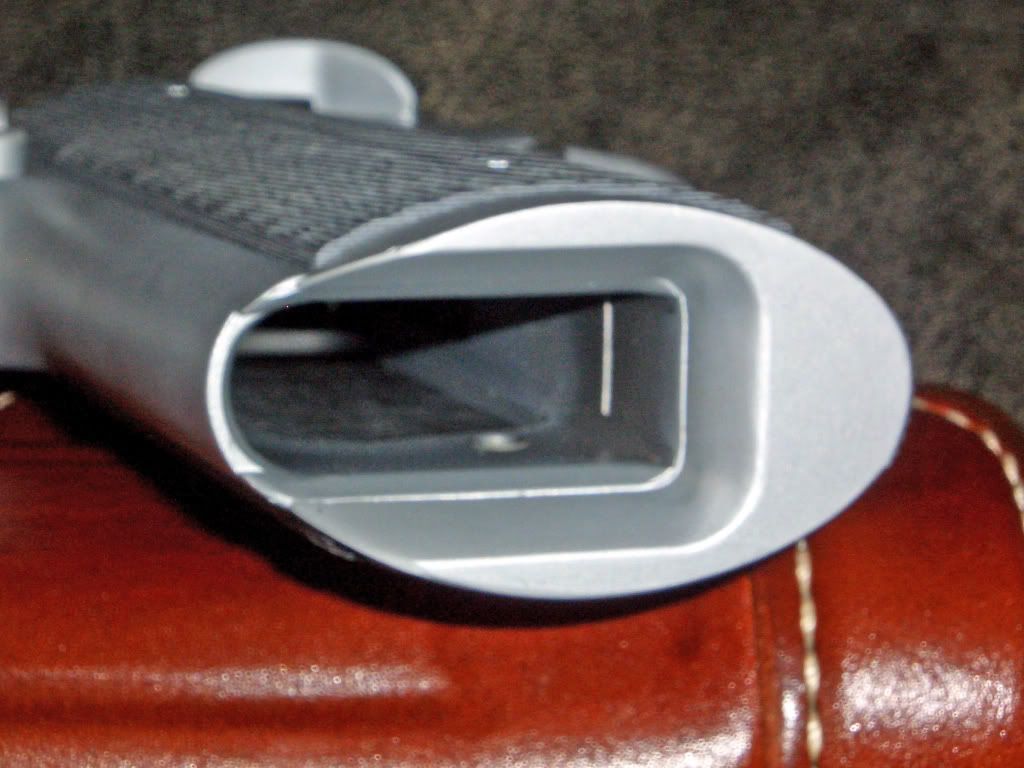

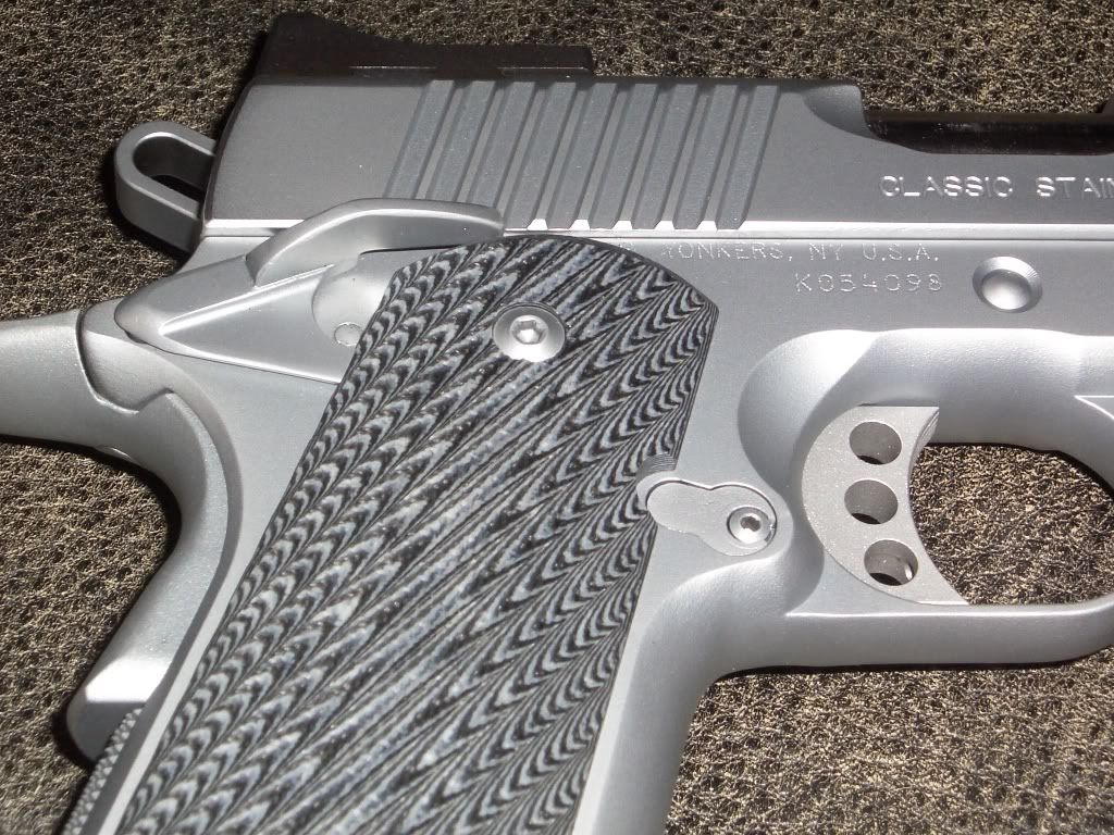

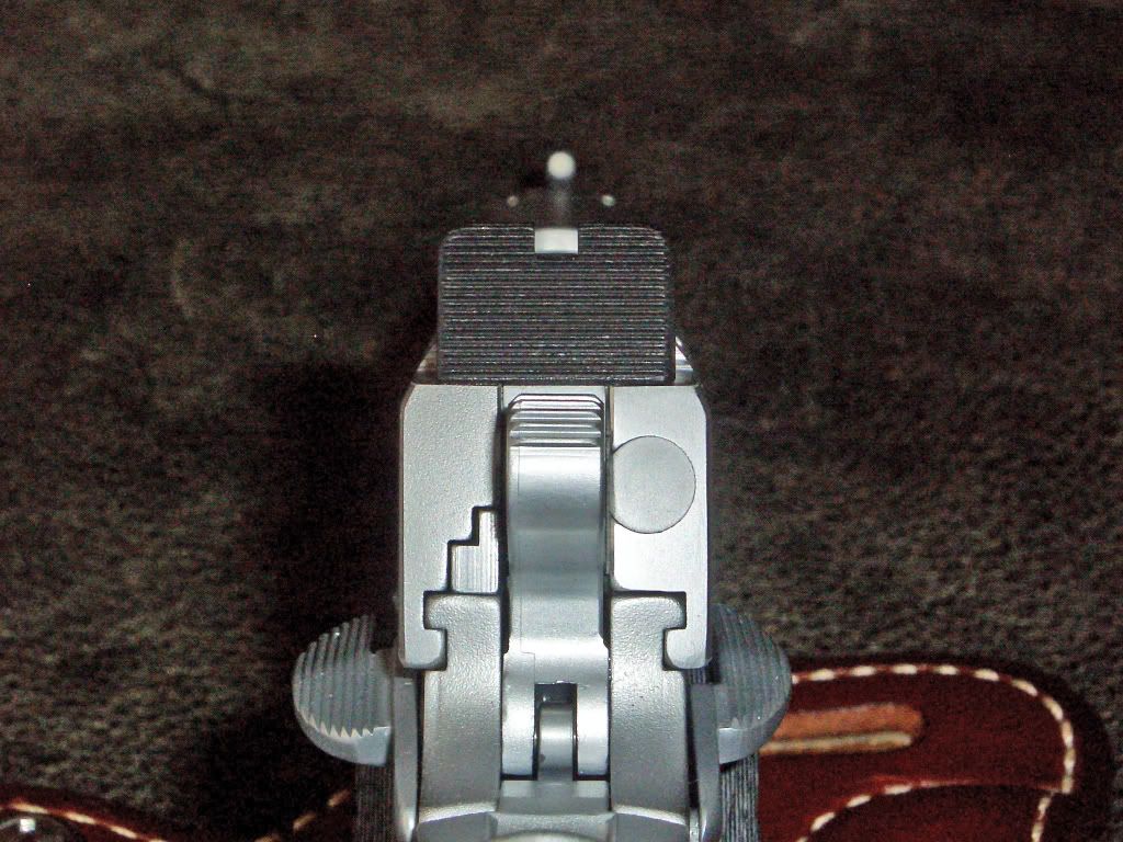

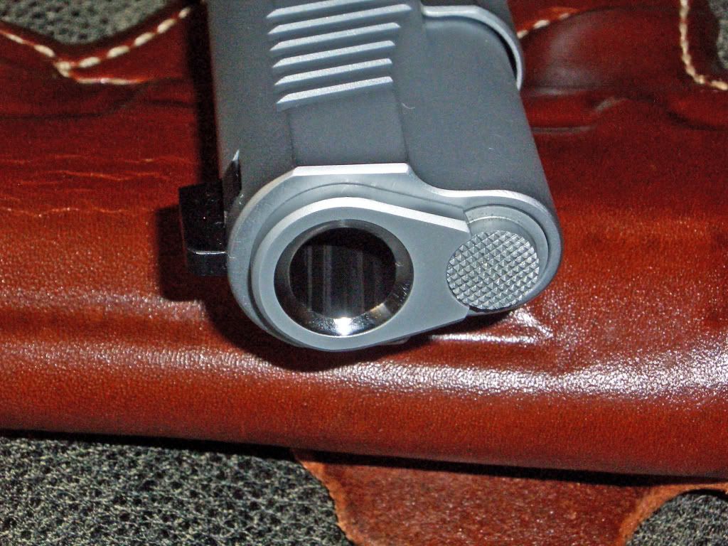

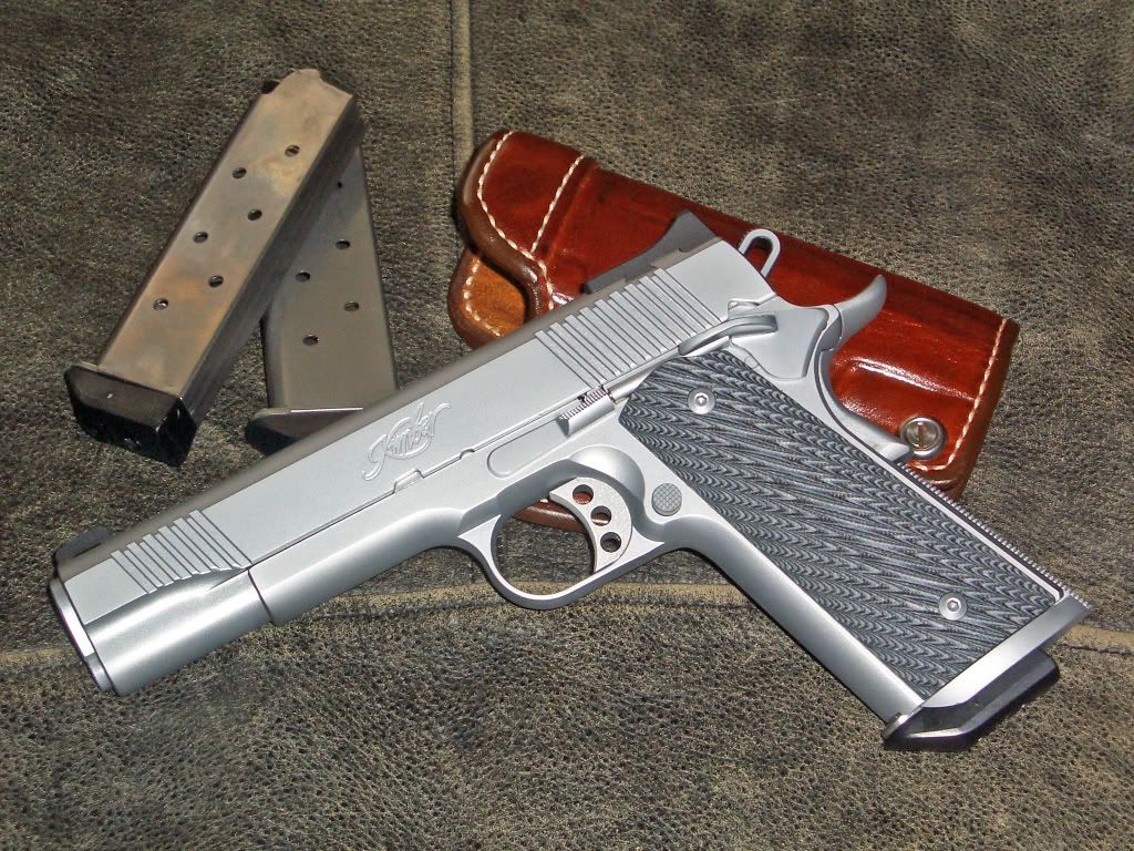

And now some pictures:
Hopefully y'all enjoy these pictures as much as I am enjoying shooting this blaster. I was lucky enough to get away from the rest of the requirements of life last Friday and put a box of 230 grain ball through it; John it shoots wonderfully!
