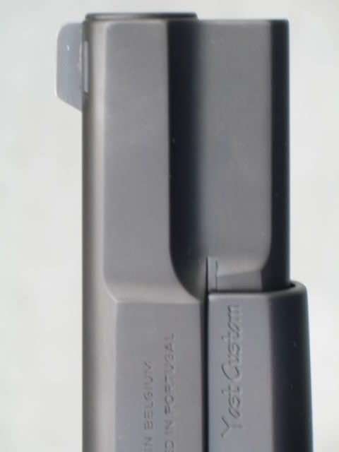

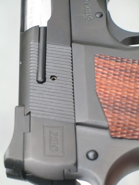

I just wanted to mention that Drake just refinished my Y-B SRT HiPower in Melonite. The service was great, it was done quickly, and I think it looks pretty darn good.
As I posted in an earlier post above, I had been looking around at finishes for a while and Melonite looked like what I wanted. Also from looking around, it sounded like Drake was the guy to do it.
I know it's early to see how it will hold up long term (I've only had it back a week), but I think I made the right choice.
Here's a pic or two:

I have a stainless DW CBOB that I would very much like to have finished in melonite, the surfaces of which are a mixture of polished and mildly blasted. Will this greatly alter the finished appearance of the melonite ?
PostPosted: Mon Nov 19, 2007 6:43 pm
Joined: Fri Mar 23, 2007 3:28 am
Posts: 49
Location: Ohio
Barry's pistol received very light bead blasting due to the fine matting and serrations. It is not the darker/glossy satin. The finish only works on stainless and carbon steel. No aluminum. The process involves a bead blast. The glossy flats will be gone. However, there is a T&E slide that has had the flats polished after treatment. I don't know how well it worked out. I'll post a photo when I can. Thanks.
PostPosted: Tue Nov 20, 2007 5:45 am
BTW- Although the flats were bead blasted on mine, it doesn't look the way I usually expect bead blasting to look.
It's almost smooth looking.
When I hear "bead blast" I picture a lot more texture than this gun has, so it must have been awfully fine beads.
It's very hard for me to describe. It's about the texture of the plain MKIII HiPowers, but doesn't look "painted" like they do.
It's a pretty interesting look I think, in that it's smooth, yet seems to reflect nothing.
