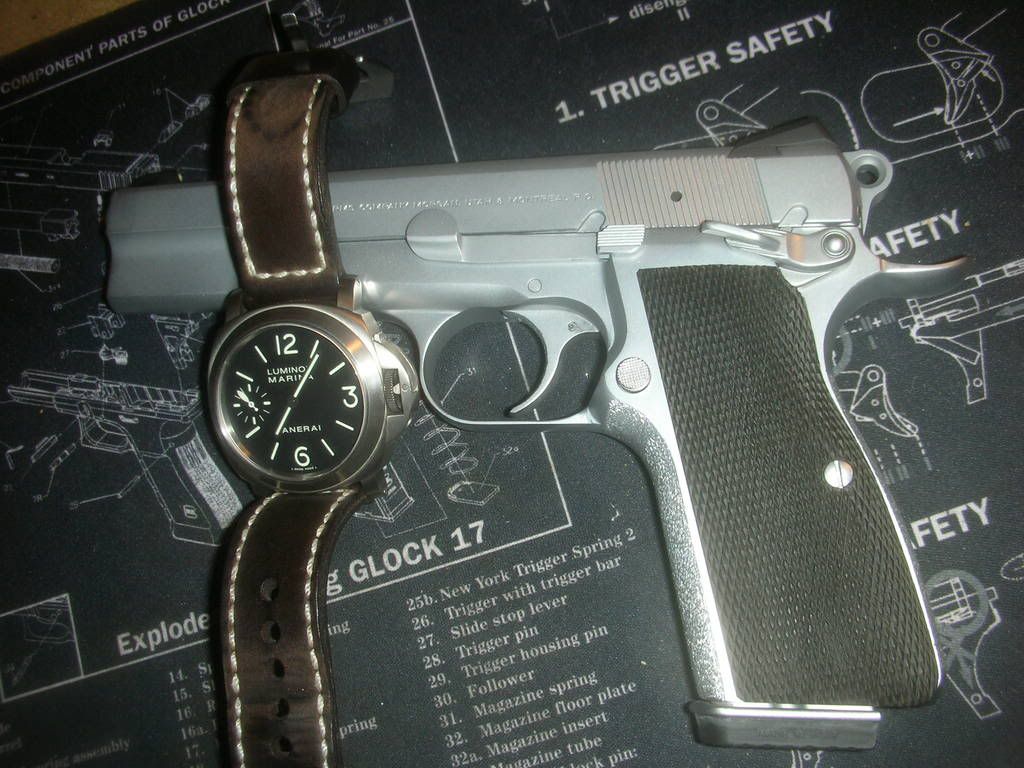

hello hi power lovers
here is one Don did for me in the late 90's
http://i167.photobucket.com/albums/u150 ... CN1175.jpg
http://i167.photobucket.com/albums/u150 ... CN1150.jpg
love it.

Loatime, where did you get the grips on the first HP. They are awsome.
Simonich Gunner Grips are available for the Hi-Power direct from Christine or their dealers.
http://www.simonichknives.com/gunner.htm
