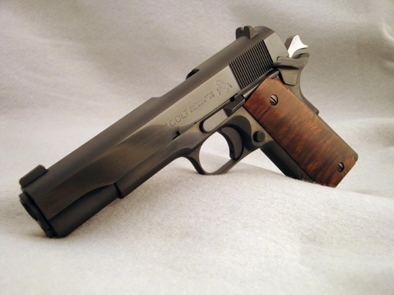

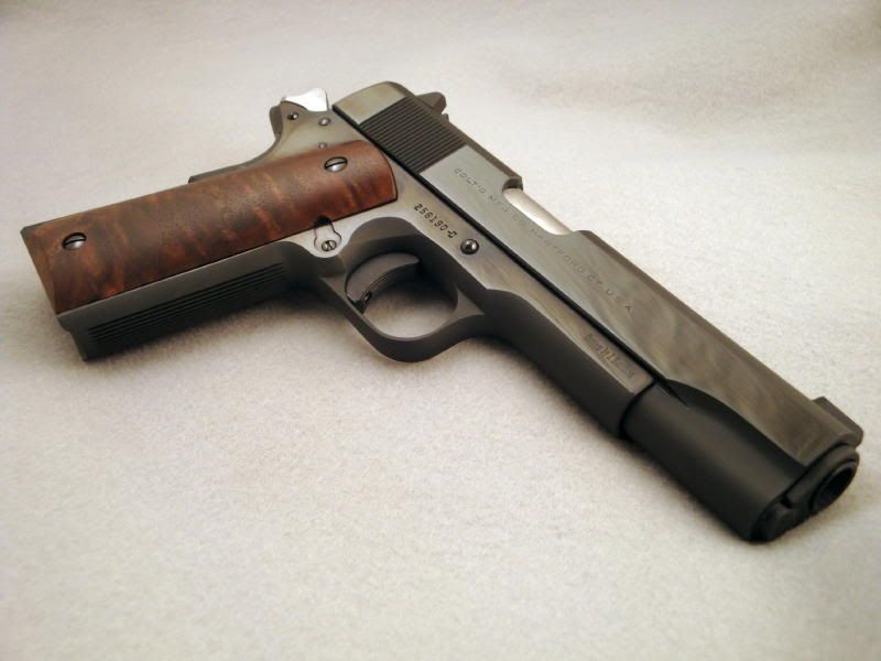

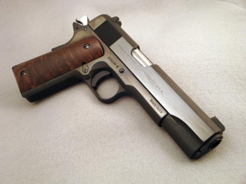

The year was 1952. The average price for a gallon of gasoline was $0.20. The NY Yankees beat the Brooklyn Dodgers 4 games to 3 in the World Series… and Colt produced a pistol destined for finding its way to John Harrison’s custom shop 56 years later. Ah, to be made better than new 56 years after birth. We mortals can only wish… “Why was I not made of [steel] like thee?” On the brighter side of living 56 years, Darwin has significantly thinned the playing field for me… so you won’t find many fools my age.
The design concept for the birth-year custom Colt Commercial Government Model .45ACP was straight forward. “John… build a pistol for me that retains the beauty originally bestowed upon it by JMB to the extent possible without sacrificing performance”. He said, “Do what?!!” John’s execution was nothing short of brilliant. It’s all about the subtle refinements you probably won’t see in the following photos.

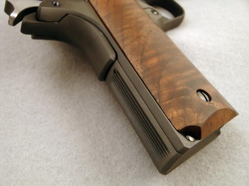

Fit and finish meets or exceeds all quality standards we’ve come to expect from world-class gunsmiths these days so there’s no need to occupy space stating the obvious. Let’s instead focus on the little things that make this gun and its maker very special.

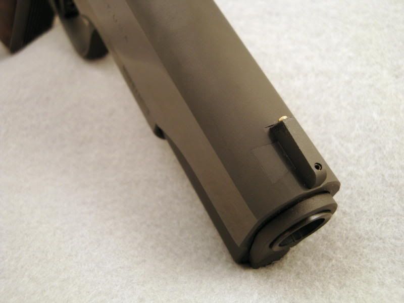

Although cleverly disguised, the SDM front sight is dovetailed into the slide. John painstakingly hand fit the oversized sight base tightly to the slot, carefully blending it with the slide contours. The end result is a virtually seamless installation as the following photos indicate!

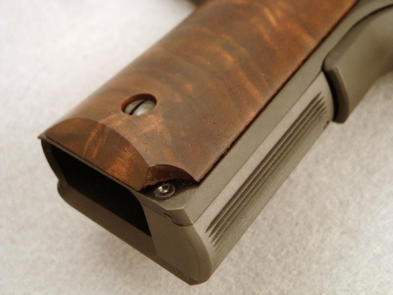

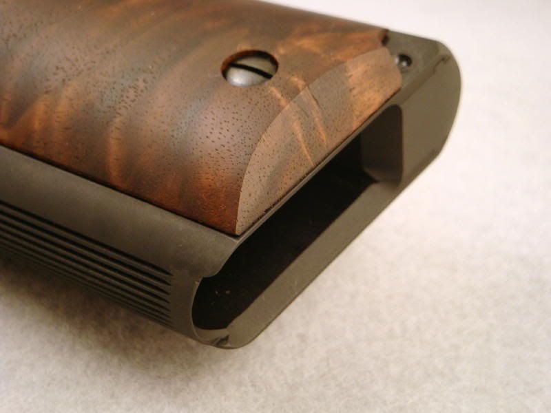

John also excels in factory magazine-well enhancements, providing maximum relief to the opening while appearing unmodified from every angle except from directly underneath.

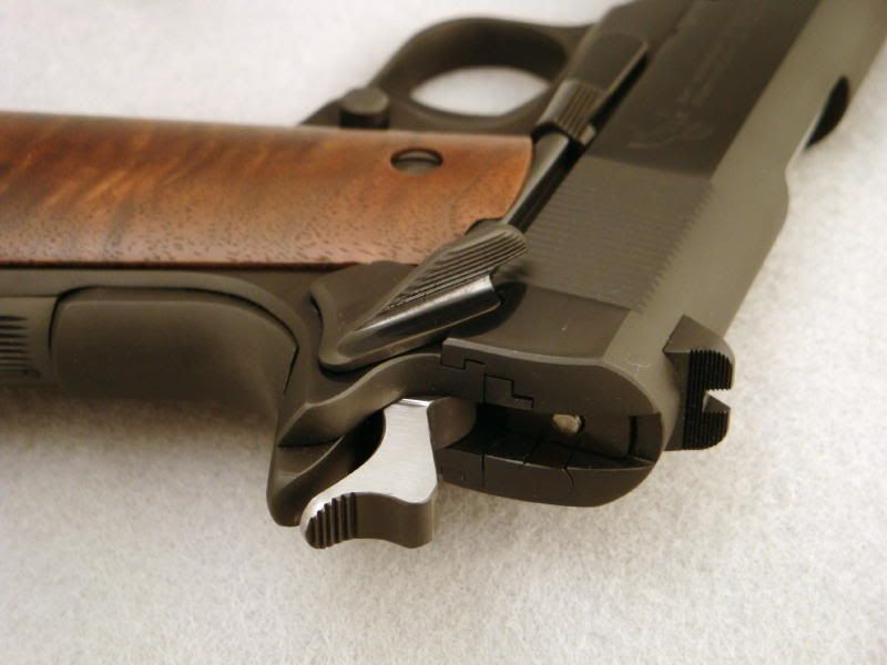

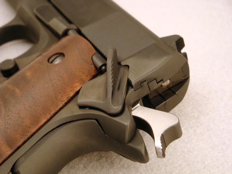

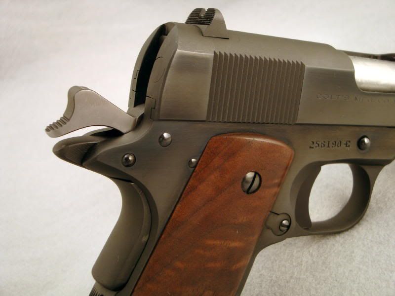

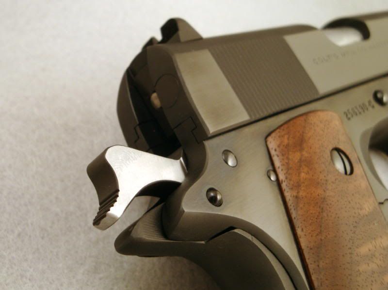

Understanding the importance of knowing his client, John’s fully aware that I’m a “both-thumbs-forward” two-handed grip guy (we’re talking about guns of course), therefore the thumb safety presented a challenge. No one manufactures a safety offering a suitable thumb-shelf without detracting from the gun’s OEM theme according to John. So what was his solution? Fabricate a thumb safety that meets the spec by radically reworking a quality aftermarket part. Check out the rear sight too. What retro-styled, hotrod Colt would be complete without a Yost rear sight?
The OEM spur hammer received equal attention. John’s grip enhancements lower the gun deeply into the strong-hand (more on that later) which would in theory increase the frequency and severity of HBS (that’s Hammer Bite Syndrome… I know you’re laughing at that one). There’s no miracle drug for treating HBS like there is for ED (don’t ask how I know). “So, John, why don’t we just bob the hammer like most smithies would and let it ride?” He’d rather die than compromise, so John reworked the factory part to satisfy his self-imposed standard, eliminate HBS and preserve 85% of its original look. Refer to photo directly below.

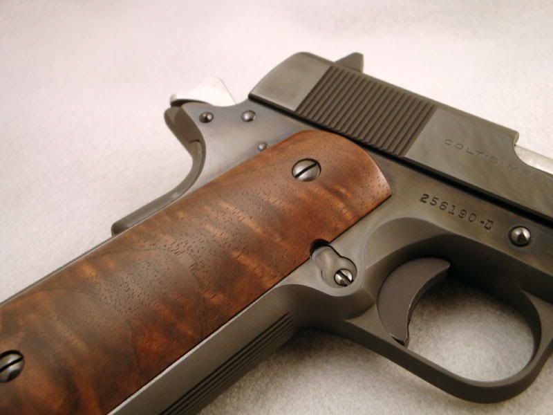

There’s not a single part of this gun that was not graced by John’s skillful hands. Even its springs were tweaked to ensure flawless performance and reliability… and its pins and screws mirror-polished. Also check out those handcrafted Walnut grip panels… wow! John fabricated those babies from a block of raw material. The photos do no justice to the craftsmanship, beauty and reflective properties of the grain in those stocks.

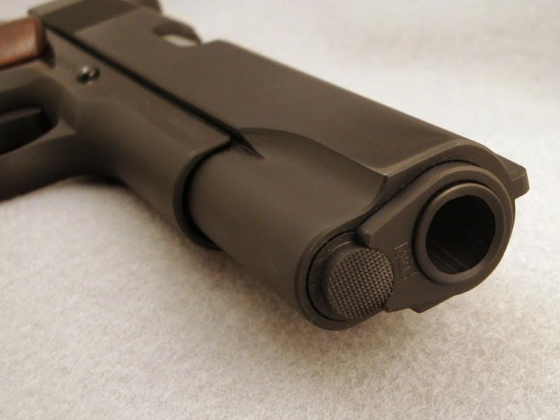

John wouldn’t dare overlook the business end of this gorgeous birth-year beast. For would-be assailants, the muzzle could be the last thing they’ll ever see. So let’s make it extra special… just for them.
Now for the good stuff that’s really difficult to detect, let’s talk ergonomics. Immediately upon mounting a classic two-handed hold, the gun melds with the strong-hand to become an extension of the arm. The union of man and machine transpires so quickly and naturally with this pistol the sensation could almost be described as a metaphysical experience; the arm ending in a .45 caliber appendage rather than a hand (okay… so maybe pitching Edward Scissorhands was a bit over the top).
All rhetorical bull stuff aside, the gun sets deeply into the strong-hand bringing the alignment of forearm and barrel bore axes significantly closer together than would its unmodified counterpart. John has tremendous instinct for knowing exactly how much material to remove from the gun’s critical contact points with the hand which include but are not limited to the front strap; the underside of the trigger guard; the underside of the grip safety where it contacts the web of the hand; and the rear of frame underneath its tangs matching the grip safety cut. When properly executed these subtle enrichments reap extraordinary rewards in comfort, handling and general feel of the weapon without noticeably altering its appearance as [not] shown in the following photos.
So how does one acquire such instinct and skill with shop machines and tools enabling him to reshape a block of steel with such precision that it so naturally bonds with its Homo Sapien host? In my highly unqualified opinion, unlike basic fit and finish skills, this is one element of the art that does not easily transfer between men. This specific element, ergonomics, so undetectable to the human eye, yet so critical to the touch and feel of the finished product, is not an acquired skill… it’s a gift from God possessed by precious few. John is truly blessed with natural talent as I am blessed to have found him several years ago, both as friend and gunsmith.
