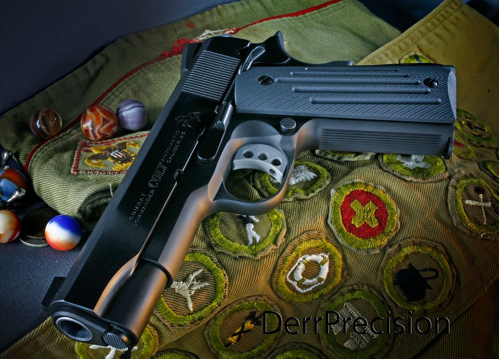

A transition Colt Commander Series 70. New old stock Novak rear sight with a new Novak front sight. The frame was high cut and serrated. A new Kart barrel was fit and mated to an EGW thick bushing. The internals are E2 qith the hammer customized. The grip safety is a Derr Precision short lenght for better concealment. The trigger is a long Greider and the thumb safety is a Wilson. The finish is deep blue brushed flats with matte rounds. The hammer and barrel are hard chromed. The grips are Harrison Design custome colored with Cerakote.

That is sexy awesome work

Very nice and clean look; awesome work...

Love the grip safety!

But what grabbed my attention, man!, in your first picture... did you sneak into my house and borrow my knife to use in your photography shoot?!?!
I probably shouldn't be using up bandwidth with this but I was just shocked when I saw it - "There's my knife!"
It looks like Jim Hoag's grip safety from way back in the day.

I would be proud to call that my own.
... only better. No disrespect to Jim Hoag. Different times......
