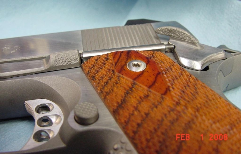

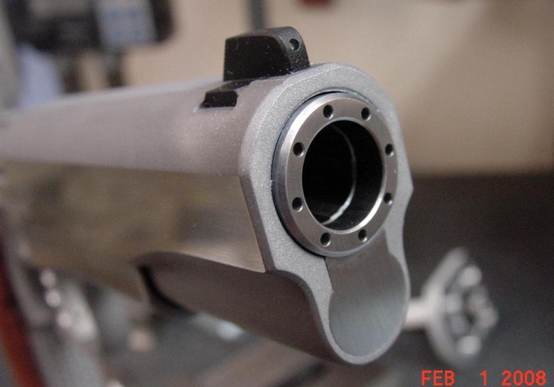

Here’s the MSH not quite seated so you can see the area that’s been widened. This is done because as the girth is reduced my removing metal at the bottom of the MSH, you get into the groove that receives the locating rail on the MSH, and you wind up with a little kitten’s tooth of metal that’s really pointy and delicate, and a little unsightly sometimes. The top of each Conamyd has been polished, in alternating directions. They look kinda rough here but the effect is sort of a scintillation as you move it in the light.
Image Image

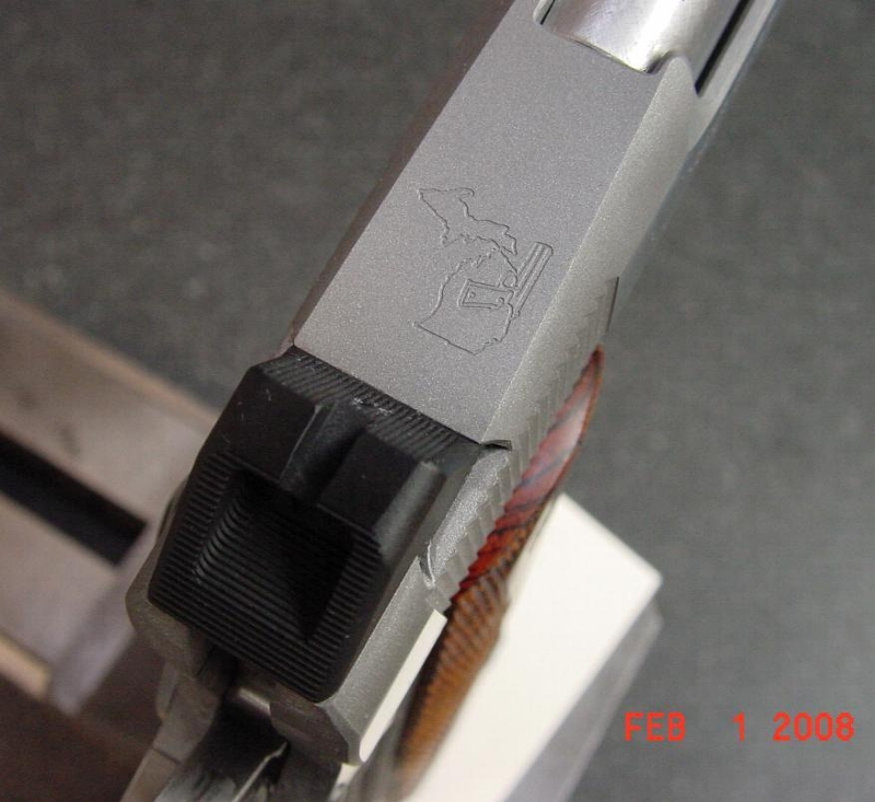

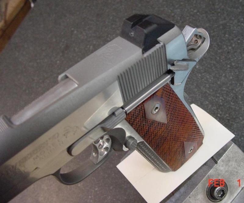

The new Shield Driver sight. This one has had some further work done to it.

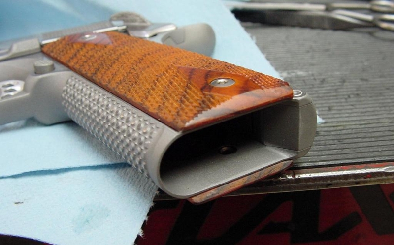

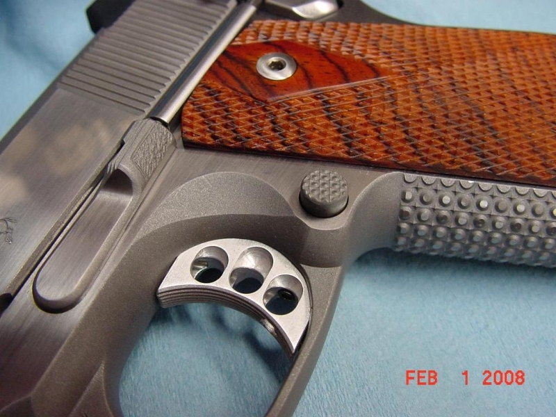

FLH magwell, grips by Esmerelda, very nice cocobolo!

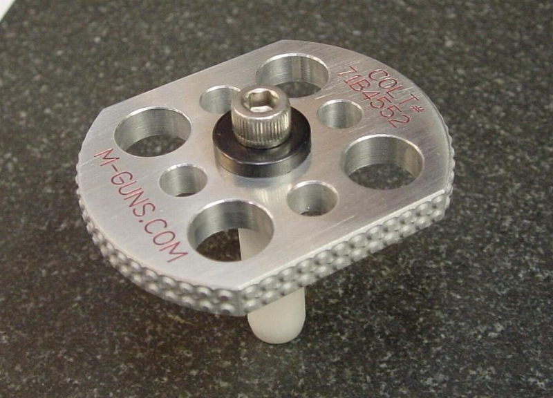

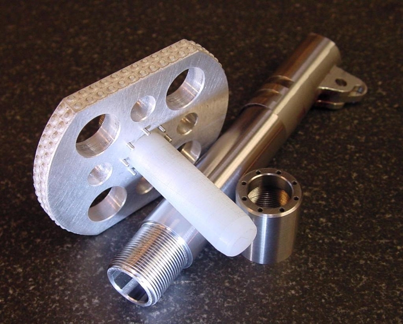

The guy is going to need this little accessory:

Nice work Ned! Couple questions: Any significance to the marking on the top of the slide? What hammer is that and did it come with the holes cut in it (im assuming to lighten it even further)?
I also just received a set of Esmeralda's grips, cocobolo dorado. She does some great work!

Did you MEAN to mount the rear sight backwards?? :lol:
Interesting take on the conamyd concept.....I like the trigger!

Yeah that rear sight is what I thought in 1985 would be a good one-- something of an abutment for racking the slide although I will admit it wasn't THAT big of an issue tome then, but mostly, a nice sloppy rear for the ultimate in not-hangin'-up.

OK, Ned. I've tried to guess, but can't figure out the accessory in the last picture. I get the SN and your name as an ID for the set, but I know there's more. Maybe it's the unknown scale of the piece in the photo that won't let me see what it might fit into?
Love the FLH magwell. Looks just like mine...purdy and functional.

I absolutely love the stipling under the slide stop-- the TS is nice, but that border around the stop's underside really offsets the whole picture.
Is it my eye, or did you do something to the rear dovetail? The edges looked slightly beveled.

That is for removing the muzzle thread protector, of course!
Brian D., that engraving is my company logo.

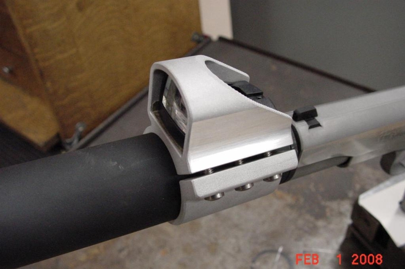

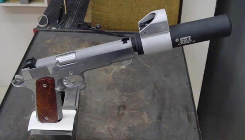

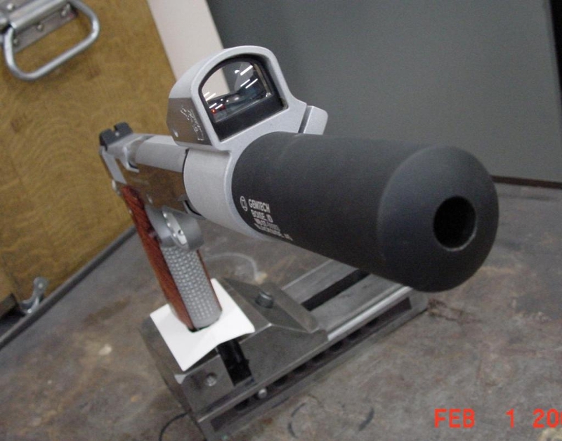

Why would it need a thread protector, you ask (why didn't anybody ask?). The rest of the story.
The GemTech is a dummy, but the fitting of it is real. The owner is ordering the real deal; for demo purposes at the SHOT Show (and since I'm not licensed for that stuff), I got the dummy.
Problem: what happens when you put a can on a pistol? The sights are blocked. Solution:
PostPosted: Fri Feb 01, 2008 6:56 pm
That is UNREAL Ned!!!!
You are definitely out there on that one! Can't wait to take a look at the booth. :twisted:

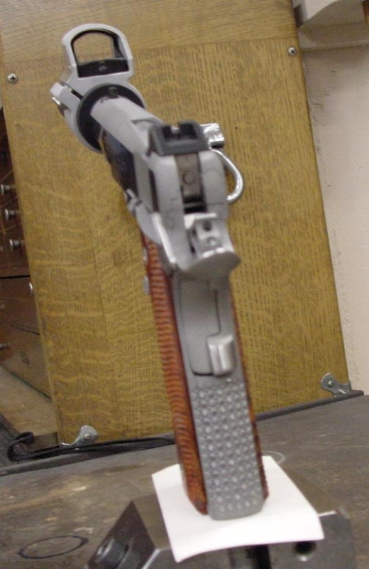

Ummm, Ned... what's up with the grip safety pad? Split decision, eh?

PostPosted: Fri Feb 01, 2008 8:46 pm
Location: West Texas
No freakin' way!
Ned you are definitely from a different planet........I'm totally blown away by this build.
I like the way you think......excellent pistola!

Lemme guess- Only the right side of the grip safety moves?

Out of sheer morbid curiosity, who's threaded barrel is that and didthey supply the protector as well?

Your work is incredible. I love the effect of the alternating brushed finish on the conamyds. You always find awesome ways to make the metal more fun and interesting. Beautiful work as usual!
