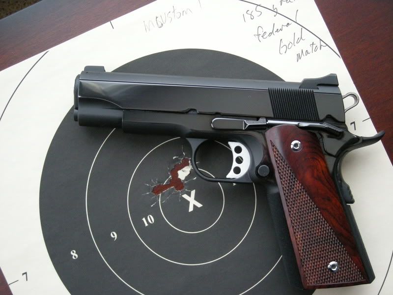

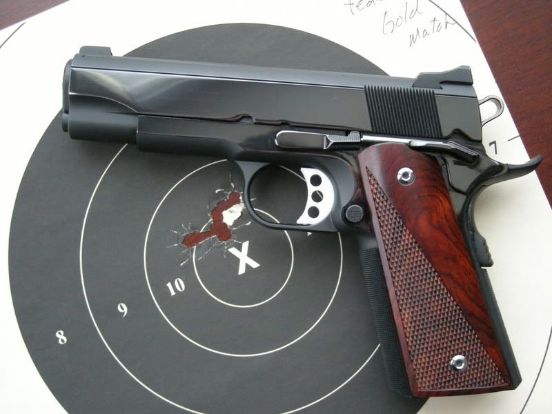

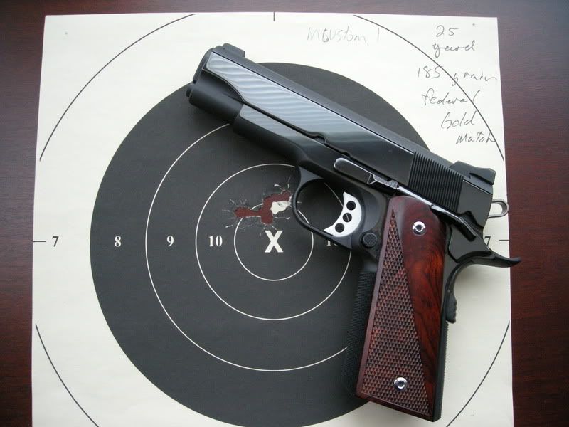

This is one I just finished up and thought I would share it with you.
This build is on a Rock River Arms frame and a Caspian slide. It sports a Kart Barrel and bushing, 30 LPI Checkering, Heinie rear sight, Tritium inserts front and rear, and a 30 LPI checkered Chen Mainspring housing. It has Ed Brown thumb safety, grip safety, and mag catch. Cylinder and Slide ignition components and a Grieder trigger.
The slide was treated with standard flat topping and serrations with flutes on both sides. The Grips are from non other than Esmeralda, which I think adds a nice touch to the High Polished Blue finish.
Forgive me for the quality of the pictures, the camera wanted to focus on the reflection in the finish, not the pistol itself.

Ummm, me. I do my own metal prep before sending it out for blueing. That was me, a flat granite plate, some 800 then 1000 then 1500 grit paper, and some white 555 on a hard soft felt wheel and my good ol' Baldor.
Now thats a polish job! Question though, why the mix and match on the frame/slide. Why not just get both from RRA?
PM sent, but to answer your question partly, I really like the Caspian slide. They have served me very well in the past and fit very well on the RRA platform.

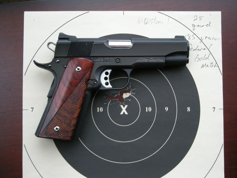

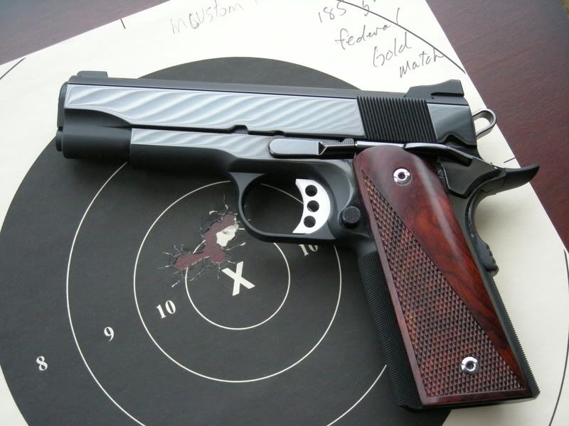

PostPosted: Thu Apr 10, 2008 4:13 pm
Here a few more for your viewing pleasure 8)
