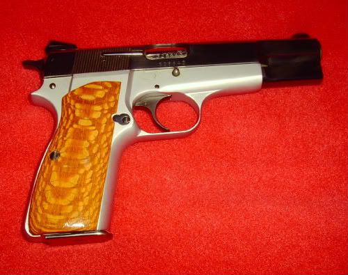

This one just finished and going to the customer soon. I don't get too many requests for electroless nickel these days, but this one has sort of the classic 2 tone look of a few years ago.

Beautiful work. Elegant. Tastefully understated. What more could a fellow want?
Is that a 1911 Novak rear?
PostPosted: Sat Jun 07, 2008 11:46 am
Gorgeous and well thought out blue/nickel P-35 Don! The detailing and stippling are amazing, the owner must be proud to carry one of your custom P-35 creations!

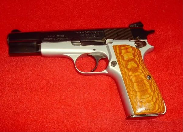

BBBBill, Yep, it's a Novak 1911 sight. I use these on the MK III and earlier guns with the adjutable sights. I have to cut a small window to clear the hammer ala' Heinies sight, but the MKIII Novak is too small, and the MK II sight will only work if you fill the original dovetail. Thanks,

Beautiful gun!
I think the two tone look actually works better on the Hi-Powers than it does on the 1911s.
