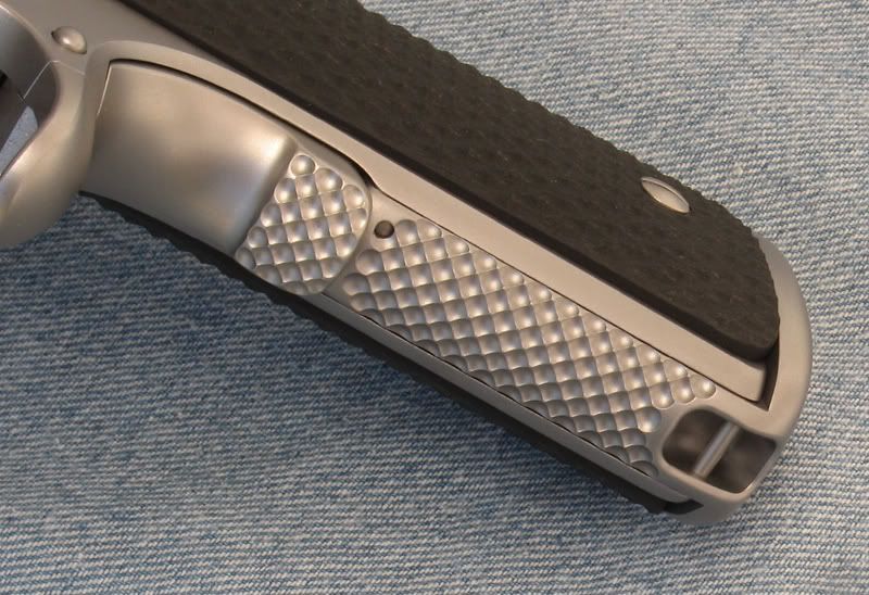

Whose MSH mag well is that? Steve Morrison piece?
PostPosted: Wed Jun 18, 2008 7:10 pm
"Whose MSH mag well is that? Steve Morrison piece?"
First pic shows measuring the gap between mag well and bottom of frame. This one was a bit worse than most. Gap is .017".
Turning a pin plug from a bar of stainless steel.
Plug silver soldered in place.
Location is altered by .017" and the new hole is counterbored, drilled and reamed.
No more gaps!
Roughing out the frame. This pistol will be fit with both the mag well and with a standard mainspring housing shown in place.
Drilling the pin hole for the recessed lanyard loop.
Lanyard pocket milled.
Golfballing completed.
Flat bottomed hole cut into each side. Two stainless pins turned on lathe. Will be press fit into the holes and machined to provide a tight fit with the frame.
Pins finished. Ribs peened and fitted.
The visible porosity in the silver solder around the pin hole, only extends to where it filled the original, exterior chamfer.
Now this mag well fits the frame with no play in any direction. Milling and finishing of the internal funnel can begin.
As rough machined.
After contouring with an 1/8" diamond cut carbide burr in a Dremel.
Finished!
Same frame with the fitted standard mainspring housing.
