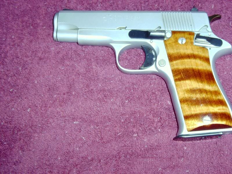

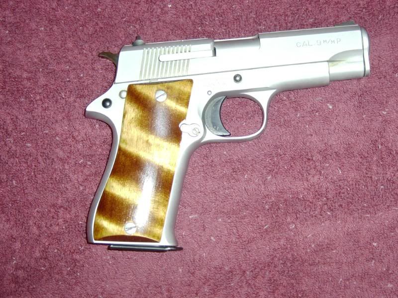

PostPosted: Sun Jul 13, 2008 10:53 pm
An old time Detroit area gunsmith, Frank Paris, did my Star BM but it isn't heavily modified. Frank is long deceased and he never would tell who did his hard chrome. The grips are by Hakan Pek. I used to travel a lot and this is the pistol I took on trips. Regards, Richard :D
