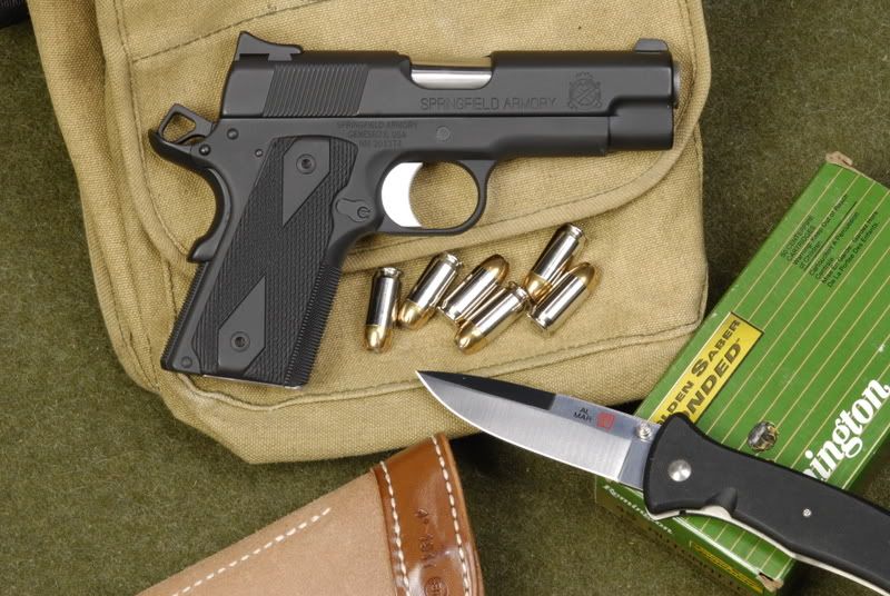

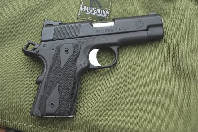

Okay Guys,
This one is for Jason and Ned. Dave Williams and the guys at the Custom Shop built this one to my specs for a Harris Article. The concept was for a deep concealment 1911.
Here is the build sheet:
Alloy Officers Model frame
Champion Slide
Carry Bevel
Single side safety
High cut the front strap
20 LPI checkering on the front strap and MSH
Flatten side stop pin
Ball cut the front of the slide
Round the base of the MSH
Bevel the mag well
Heinie Tritium Straight Eight Sights
Matt Black Armory Coat
Solid Trigger

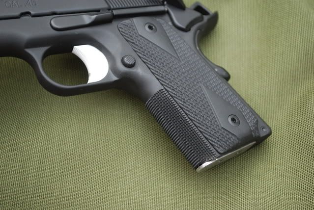

Dave added the thin stocks that have had the edged and checkering softened.
When Dave called me and said it was about ready, he described it as having a "bar of soap" bevel and the matt finish gave it a real "stealth look." I think that about describes it. I'll be getting an article out on it PDQ. It shoots like a house of fire with quarter sized holes at 10 yards being the norm.
Let me know what you think.

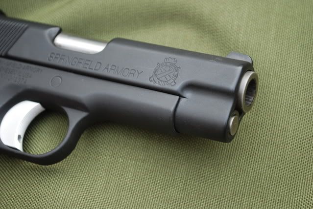

Notice the rounded edges of the slide stop, magazine release and the stocks.
While some may not like 20 LPI, it is perfect for an compact alloy .45. I do like a solid trigger!

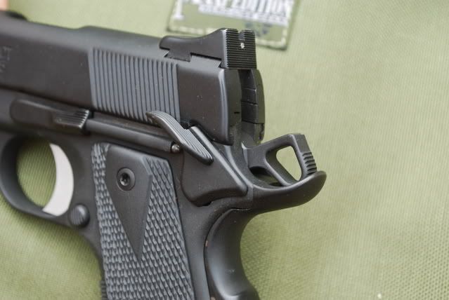

Even the edges of the hammer have been beveled. Fit and finish of all the parts was excellent, especially the beavertail.
John and Jason have me hooked on ball cuts. I think that look even better on this one with the bevel added. Kind of a unique look.

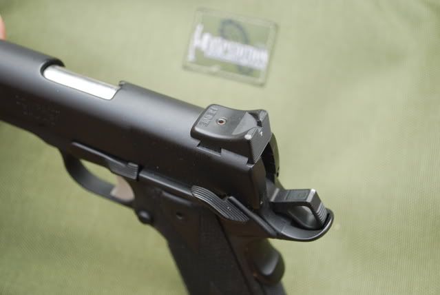

The flat profile of the Heinie read presents a very clean sight picture. Notice how soft the beveled edges are.
While not a fully round profile, the base of the MSH was rounded to remove the offended edge.

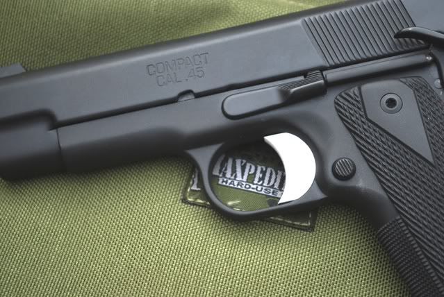

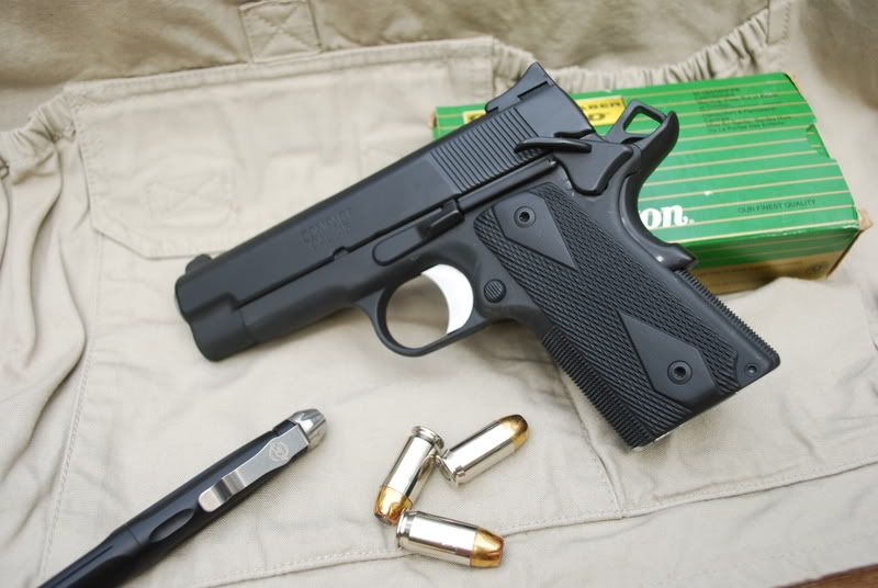

A couple of better photos of the CCC. Headed back to the range so more photos to come. The more you carry this pistol, the more you come to appreciate all of the individual features and modifications. The Al Mar SERE is one great folder!
Remington's Golden Saber 185 is the perfect load for this little gun.

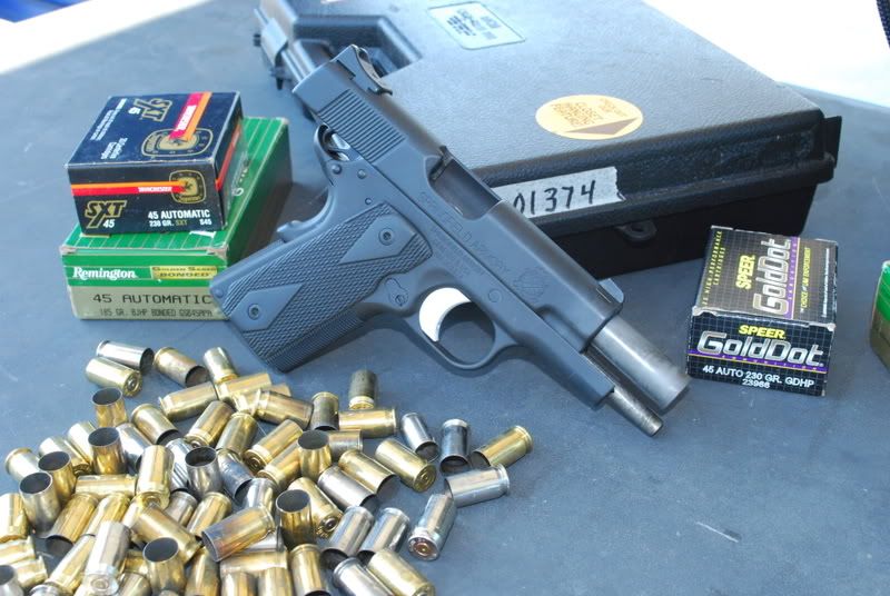

Back from the range. 1.5" at 7 yards was no problem at all. It was a hand full with Remington's 185 +P Golden Saber. 230 Sabers, Gold Dots and Rangers shoot well. It does tend to shoot about an inch low at seven yards. That will get adjusted after the article is completed. It was 100% reliable with everything we fed it.
The gun just continues to grow on you. The trigger measured 3 lbs 8 oz. and goes in a hurry. The Heinie Straight Eights are very quick to pick up on and offer a clean rear sight picture.
Enjoy,
It really doesn't flip this bad normally. We were shooting groups and tended not to hold it as tight because we were doing a fast follow-up.

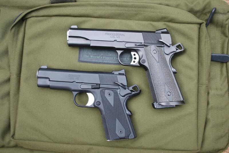

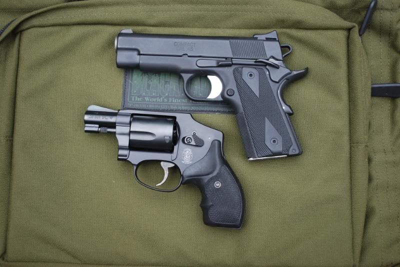

Two more pics to give you an idea about the size of this little guy. Range time yesterday was a ball, especially with some light 185 gr. target loads. Almost like wadcutters out of a k-frame.
