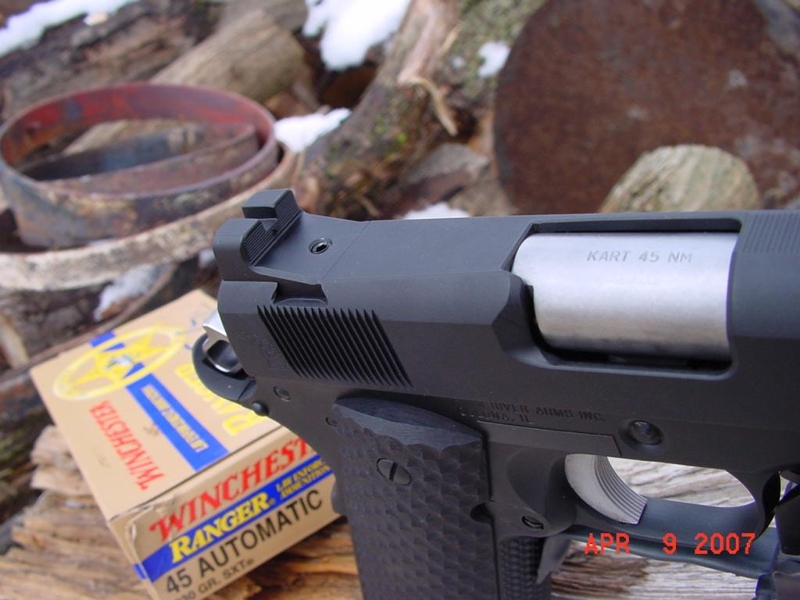

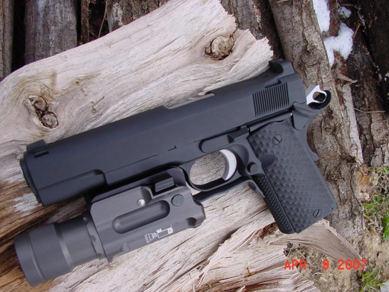

This one was an interesting project because of who it was for and for the fact that it is the first time I've worked with a Rock River Arms frame. I've been saying for years that RRA 1911's are the most under-appreciated pistols out there-- never saw one that didn't impress me at least somehwat, and I am not easy to please. The frame was excellent. Not perfect, haven't found that one yet, but just a good solid frame with extra metal in a few important places, nothing crooked or too thin or too thick. Nicely ground flat and parallel, no awful burrs. The mag chute had been wire EDM'd which I thought was pretty impressive. Trigger bow cuts had been EDM'd as well.
STI slide
YoBo sights, "Shield Driver" style, tritium vials recessed forward
Kart barrel
YoBo ignition parts
Trigger has a solid OT stop fabbed in
YoBo rail with upsized screws, left long, riveted, and dressed flush.
Zinc-phosphate Parkerized, GunKoted
Grips by friend Keith E., Keith you chime in here and confirm if I can out you. These may be temorary as Simonich Gunners were spec'd but they are backordered at the moment

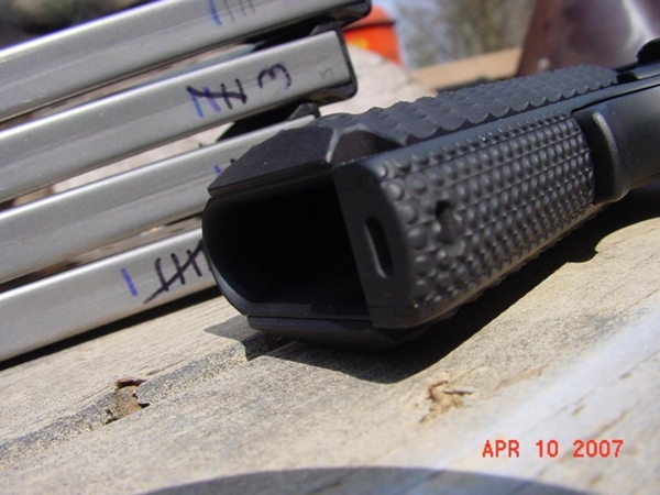

FLH magwell using Stan Chen's MSH
Standard off-the-shelf Colt thumb safety per customer spec.
Nowlin mag catch. I like these because they are good quality, reasonably priced, long enough to do whatever you want with (angled with mini-Conamyds in this case), and they come with the mag catch lock and spring, although it's a reduced power spring which I always toss and replace with a Colt or Wilson part.
....more if and as I think of it.
Other than to say this gun really doesn't have much use unless you're into shooting silver dollars after dark at 1,000 inches (28 yards). Joking asid though, in test firing there seemed to be a tendency to group better without the light. Anybody else seen this?

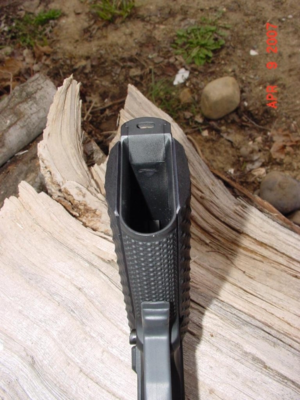

The magwell, I think I can post a better pic of this later:

Regarding groups with and without the light: I tried the Operator I won here on LTW (Thank you all again) with and without the light and saw no change in group size. That's not to say it didn't happen, but rather, I couldn't shoot well enough to tell a difference.
However- I did see a very slight change in point of impact. At 15 yards, it tended to shoot about 1/4" higher WITH the light attached. I would have thought it would shoot lower with the light, but it did not...with me anyway. I tried it a few times with the same results. I need to try it again, just to see if it was something spooky about that particular day.

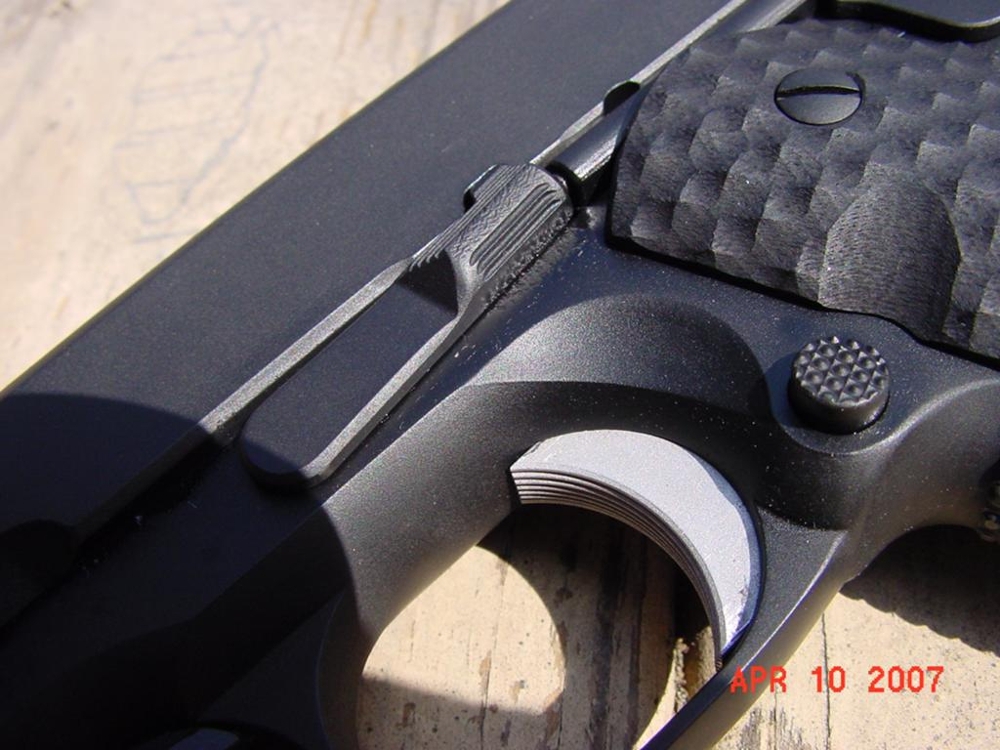

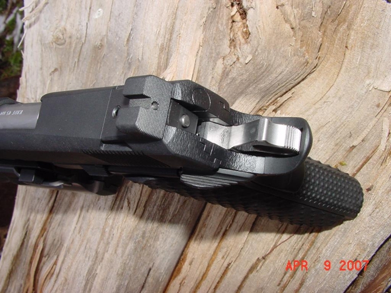

A few more pics-- this one shows the inny and the outty of the lanyard point, just a slot through the bottom of the MSH. The hash marks on the magazine aren't Frankenstein stitches, that was just me counting the number of times I'd used each one loaded full so as to be able to track and report to the customer. They are Tripp mags and worked perfectly.
Harold, ask and ye shall receive, especially when it's my first-ever, real paying customer after going full time. A pic of the slanted mag release with half-scale Conamyds:

Ned put a similar mag release on a Colt commercial he worked up for me a while back. For my purposes (carry & occ. games) this modification has worked out to be a very good compromise between a traditional extended release and the standard ones. I'm not sure if the bevel or slight extension makes more difference, but either way my reloads are faster with this release over standards ones on my other pistols.
