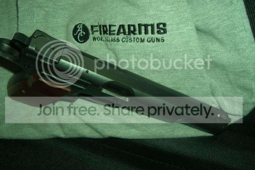

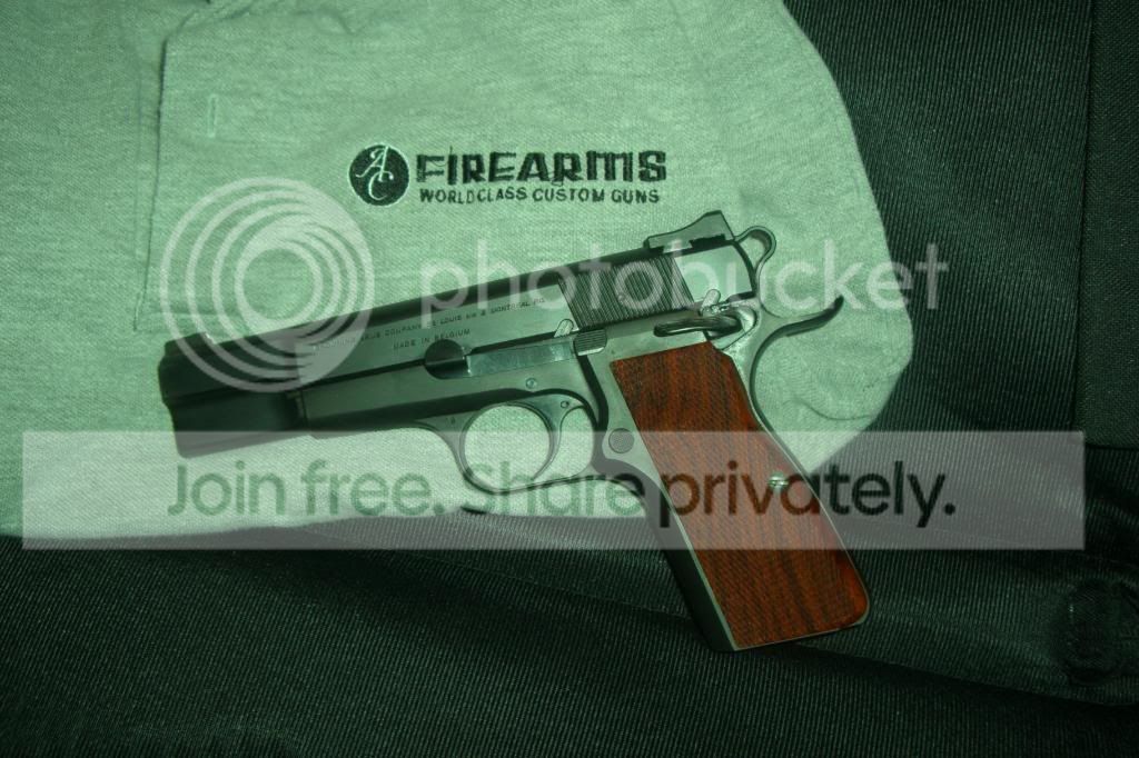

This is an older browning that I finally got around to adding a beavertail and freshening up.
http://i508.photobucket.com/albums/s330 ... MG3290.jpg
...the beavertail and sights are new, as is the safety.
http://i508.photobucket.com/albums/s330 ... MG3295.jpg
The list of mods include:
beavertail
rigger job, Including C&S hammer,sear, and springs, weld and refit trigger bar in slide
weld and regrind frame rails
Heinie Straight Eight sights
flatten and serrate the top of the slide.
weld and refit barrel.
bevel slide bottom
4 lb trigger pull
weld up safety
Havent completely settled on a finish, so blast and blue for now...
