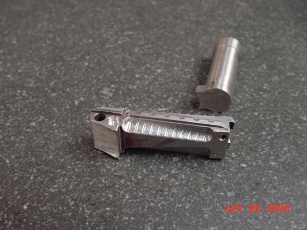

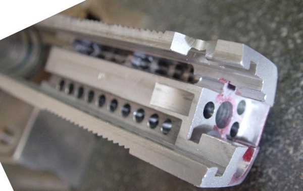

A couple snaps of the innards of this "air" gun, various stages of near-completion.
Some of the lightening measures on the safety, slide stop, and the two-piece grip safety.
....And on the slide. The aforementioned holes under the FP stop and up from under the bottom.

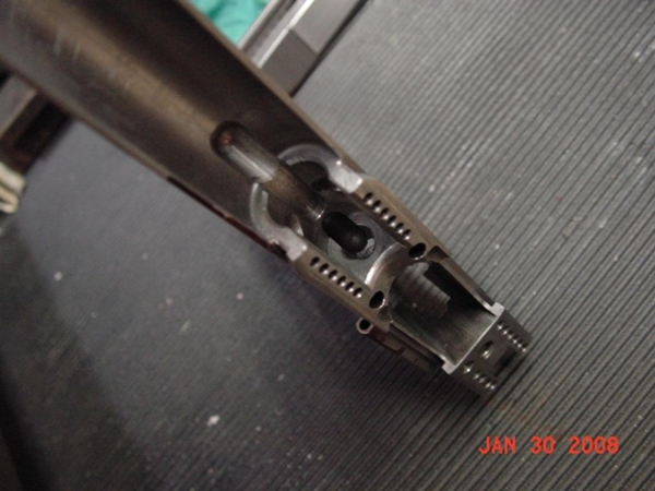

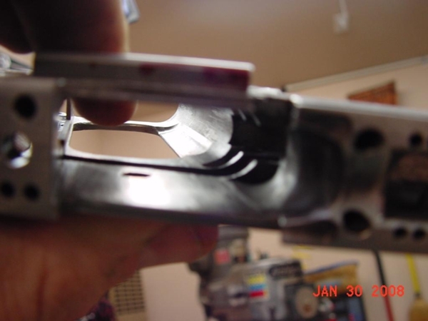

Some further pics of areas I’ve lightened. Bad pictures, sorry, could not make the time to do them up nice….
The MSH has had metal removed in most places it's not needed..... behind it is the reverse plug made from scratch.
Bad pics below show some metal removed inside the mag chute along the sides of the frontstrap. Also, harder to discern is the metal removed between the bottom of the feedramp and the top of the trigger cut. If you cut a frame in half front-to-back you would see a big solid spot here.... no harm in reducing it some. Also you can see where the root of the trigger guard has been hollowed out on the inside, and a hole under the barrel bed along the axis of the recoil spring. Then from the bottom of that hole, another hole angles down parallel to the front of the mag chute.
